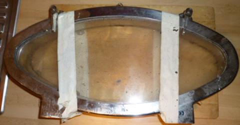

Anyway, the weather didn't stop me, it just slowed me somewhat. I managed to wire my trailer for the internal electrics, insulate the roof and install the internal roof ply. My internal roof ply is 3mm (1/8") WBP luan, screwed but not glued. This means I can unscrew the ply and have access to my wiring. Luckily because I just bought this...
...from eBay for the ridiculously low price of $8. Its approx 18" wide by 10" tall. I will replace the glass with Lexan and mount it on the front of the trailer. Of course it's going to be mounted along the centreline, exactly where I have run my wiring. So the interior roof ply has to come back off and the wiring needs a redesign.
Its a little extra work, but I think the new window will help to add to the retro aesthetic.

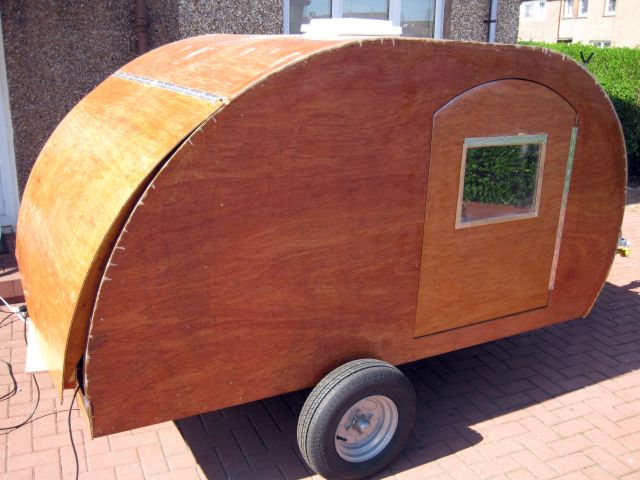

The weather suddenly decided to become incompatible with building a teardrop on the driveway during most of April. I made a couple of forays outside, but more often than not, I had to put the tarp back over before I got anything useful done. I guess I should be happy that the bad weather was only wind and rain and not volcanic ash or pyroclastic flow.
BUT this weekend has been glorious and now I have completely covered the trailer in a coat of epoxy sealer.
I also purchased my aluminium, at considerable cost! That's $450 or 300GBP in local currency. Now you know why we call this place rip-off Britain! My beautiful American wife is always horrified at the cost of everything here.
I opted for the more costly option of aluminium coil over aluminium sheet so that there will be no seams on the roof. Sheet for the sides, and lots of nice 'soft' moulding for the edges. The aluminium gets delivered on Monday.

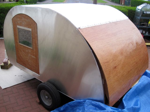

In the meantime I have fitted the other sheet on the port side of the trailer, it completely transforms the homebuilt look that the trailer had to something that looks quasi-professional. :D
One obvious thing I should point out to those still to fit their aluminium is that cut metal is *really* sharp. It's like handling an 8 foot razor blade and cutting it into many smaller razor blades. I hardly have a knuckle or finger that is not missing some skin. I hate working with gloves on, but I might be persuaded to compromise.
As a novice tinsmith I found that it was easier if I made a rough cut first, approx 1 inch from my true cut-line, then go back and make my true cut. The reason for this is that the aluminium off-cut needs to 'curl' away from the tin snips. With the rough cut you will have much more off-cut and it will resist 'curling' and your cut will be rough and inaccurate. Then on your second pass with only an inch of off-cut the aluminium will 'curl' much easier and you will obtain a nice smooth accurate cut as a result.

Postby BigAl » Wed May 12, 2010 2:33 pm
Hi Guys, Today I made quite a lot of progress with my recent aluminium delivery.
Charlie, my neighbour helped me lift the roof coil onto the trailer and offered some tips and much needed assistance.
