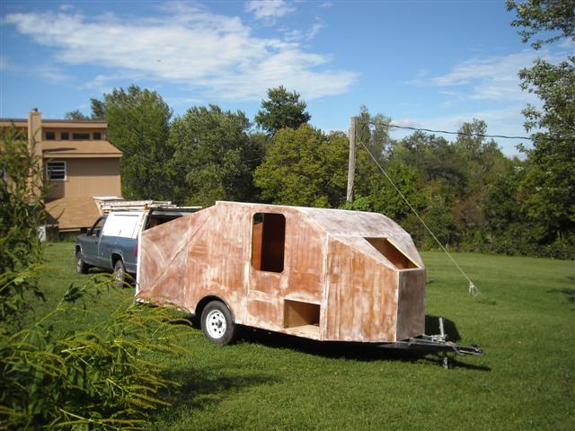

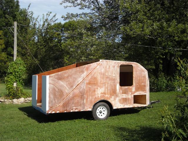

He got his first trip out in the sun shine so I could get some pics from a distance.
here is the front view
here is the side
Here is the back

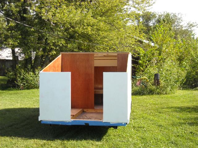

I pulled him outside so I could turn it around and back it in so I could get the hatch put on
Here he is with his hatch on and up.
Now I have some work to do on the side and the hatch comes off to put the cloth on.

Postby starleen2 » Wed Sep 01, 2010 8:36 pm
I think by the time you get this finished - we'll see a lot of WW type campers out there - what is that white dusting on the sides - sanded Epoxy?

Postby RAYVILLIAN » Thu Sep 02, 2010 7:00 am
You guessed it Starleen it's epoxy mixed with glass bead powder. It's a pain to mix in the powder but it makes a pretty easy to sand filler.

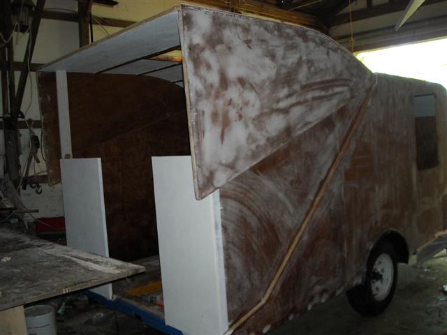

Postby RAYVILLIAN » Mon Sep 06, 2010 4:23 pm

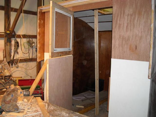

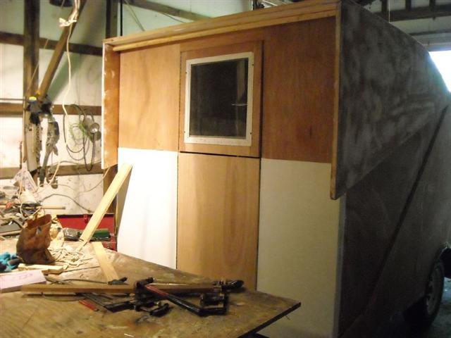

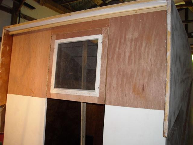

I took advantage of the long weekend and got the swing up wall and door roughed in .
Here is the wall it is hinged at the top and swings back when the hatch is closed.
Here is the door
Here it is opened
Now I have to take it all apart and start sealing and finishing the out side.
