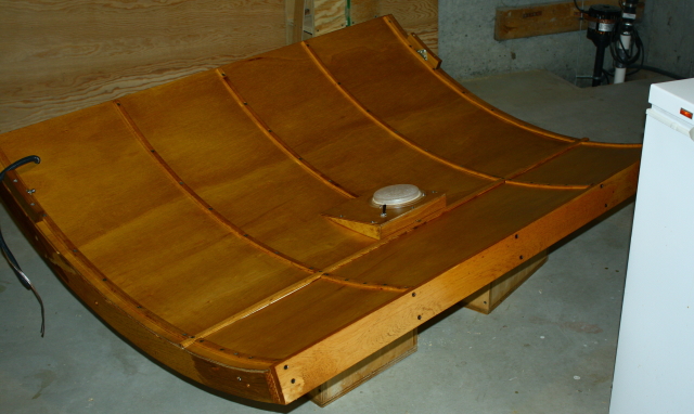

After my second visit to the cath lab in as many months I had another artery opened, without a stent this time, and have been cleared by my cardiologist to start getting back to normal activities. I specifically asked him about the Shack and he said "sure, why not." So after cardiac rehab this morning I dragged the Shack out of the garage for the first time since the first week of June. You can't imagine how great if felt to drag that thing out into the sunshine. I dry fitted my aluminum to the top to see where the seam is going to fall, and sure enough I have to add another support spar for the seam/overlap. As if I did not have enough spars already I added more wood for the seam. Of course I had to take off the plywood that was there and was surprised how much memory the plywood had. It held it's shape fairly well once unscrewed so I know it should go back on pretty easily.
The only picture I have of my progress is the inside of the hatch which I finally got stained and spar varnish on. As you can see it is still in the basement where the Shack was originally built. If anybody is wondering why my light is on this wedge thing it is to position the light better to illuminate the galley. I tried just placing it against the curved hatch and #1 a flat light doesn't look good on a curved piece of wood, and #2 the angle of the light placed the majority of the light out past the end of the galley. The wedge re-angles the light so that the inside of the galley is well illuminated, including right down inside the cooler, and over the stove.
I hope to make more progress soon and will update this file when I do. I'm really sad that I lost 2 full months of work on the Shack, but as my wife says "it'll get done when it gets done." I'm just happy to start making progress again. My wife has been my rock through this whole heart thing...and I thank God I have her.

Postby aggie79 » Thu Aug 04, 2011 6:43 pm
Jim,
Great news about getting "doctor's release". Sounds like your health issues have rounded the corner.
The hatch looks great! I really like the way you mounted your galley light. I wish I had done mine that way.

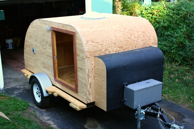

Postby Jim Edgerly » Thu Aug 11, 2011 7:30 am
Well, made some progress on the roof the last couple of days. I glued the roof (liquid nails rather) to the spars. I've had my fair share of stop-go-stop-go on this project so committing to closing in the roof was a little scary...knowing that no other design changes can take place in that area. I over lapped the plywood over the sides, then came back after the liquid nails had hardened and used an edge router bit to take the excess off and make the roof flush with the sides. I also used the edge router bit to open up the hole in the roof for the ceiling vent/fan. So I guess the next step is to start making trim for the sides. The battery box in the picture below is just sitting on the frame right now and will not be bolted down until after the trim work behind it is completed. Same with the running boards...they are just sitting on top of the untrimmed pressure treated 2x4's for now.

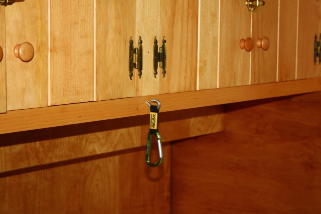

If anybody is wondering why I have a carabineer hanging from the center of my cabinets...it's for the dog. A 22 pound Schnoodle will be sharing the sleeping quarters with us, and as with most small dogs, is not trustworthy off-leash. So he will be wearing his harness and hooked up inside so the middle of the night bathroom runs we will not worry about him jumping out and running off. He normally sleeps like a log, but just playing it safe in a strange setting for him.
I will be coating the roof with the black asphalt paint before covering with aluminum. Even though the roof is marine grade plywood the extra layer of sealant under the aluminum is worth the effort in my opinion. Eventually I will be putting the aluminum on top of the roof...but I have one question in regards to the aluminum covering the ceiling vent.
How is the most efficient way to cut out the vent hole through the aluminum? I'm using .04" aluminum on the roof. Is the easiest way to just use a hacksaw blade in my jigsaw?
