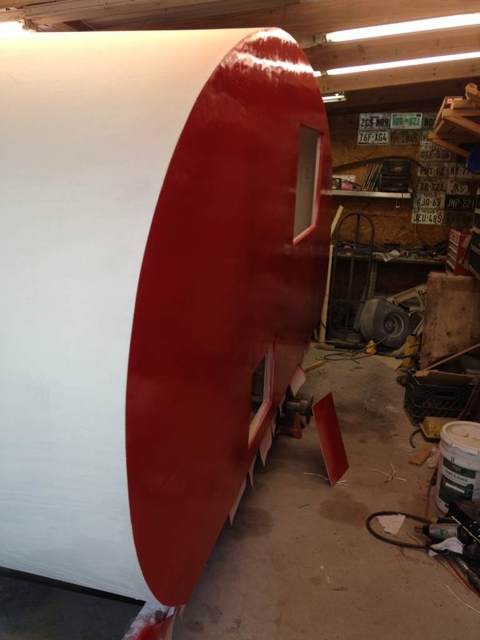

Had the exterior ready to paint but then started thinking about where the door seals are. I just did not like the way the jamb was protected. So stripped the primer from the jambs and mixed epoxy and wood flour filled all the crooks and crannies up. Sanded down then just a coat of epoxy. By the end of today had it back ready to put the first coat of color on.
We went with the rust-o-leoum marine topside paint. So far like the way it is turning out. Base color will be the bright red. With some gray something's throughout.

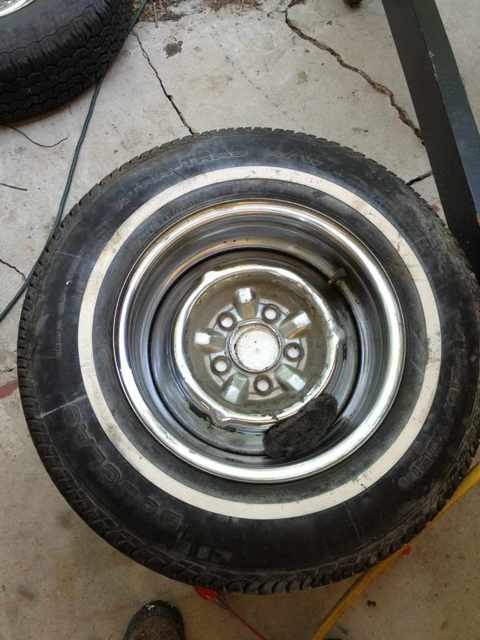

Had the old wheels and tires off today. So I took some steel wool and WD-40 and started taking the rust off. They looking good now.

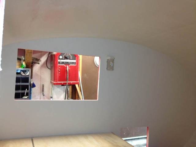

Got the inside nearly finished. Painted it out with just some gloss white enamel. Got all the electrical trimmed out.
