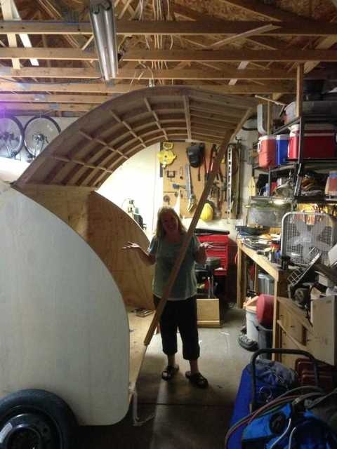

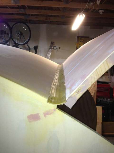

My original plan was to use a piano hinge for the hatch with a piece of decommissioned fire hose over the top, but the hose was so heavy I decided to try and use it as a "living hinge". It worked great! I now realize just how big the hatch is, OMG! I took a pic but it didn't do it justice, so I had my lovely assistant stand underneath for scale. She is 5'6 or so, but still. When input shocks on it I will need a pull rope to bring it down.

Now you have a name for your trailer: Standy HH. ( Humungous Harch!) :lol:
Seriously though, It's looking good.. :thumbsup:

Postby KCStudly » Fri Jun 14, 2013 2:45 pm
No need to raise the hatch so high if you don't want to.
Your build is looking mighty fine. :thumbsup:

It's just temporary for now to see how it would work. I wasn't planing on using aluminum as the 5" fire hose is real thick. I plan on using caulking under it, and along the edge, and screwing it down with lots of SS screws, although the rubber does have a habit of buckling a bit when it is raised, maybe aluminum strip would help hold it down. I'll have to think about that. I'm pretty confident that the hose will hold up for a very long time, even though it has already seen years of use, I can't imagine it failing.

Agreed. I was more interested in how you had (or planned to) stabilize the connection to the cabin and hatch. Surely glue alone would not stand up to long term use. :thinking:
Are you going to use washers under the screw heads? I would think that, no matter how robust the hose is, because it is flexible it must give some under a screw.

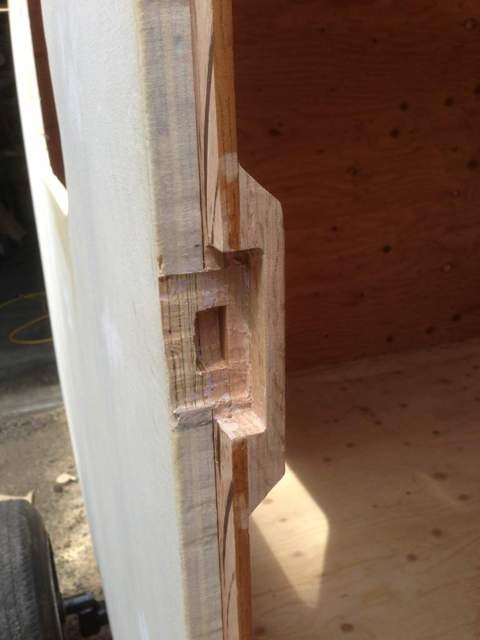

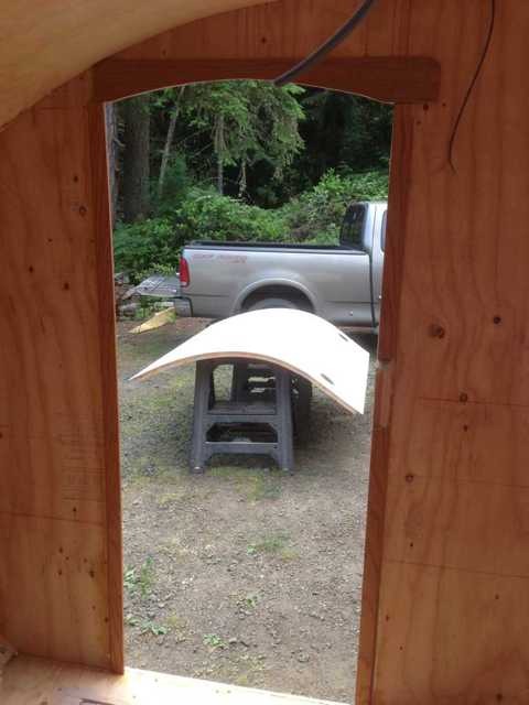

Busy day. Built my door, and door jam. Since I am using the 3/4" plywood cutout for the door and a standard door knob I had to add a piece of plywood where the knob goes, and then build the door jam to fit around it. No T molding to be found anywhere, so I will have to order it on the Internet and add later.
I also pulled the hatch and sealed it and the door same as the rest of the trailer with TB2 and muslin. Got my primer and paint, borrowed a HVLP sprayer, hope to get it at least primer on tomorrow.

Here are the pics of my door jamb and door knob detail. Originally it was a rectangular piece of plywood, but the wife cringed and said are you going to leave it like that?
