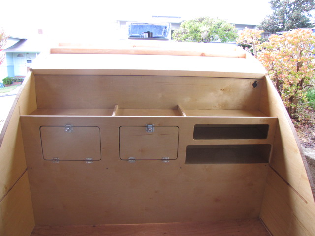

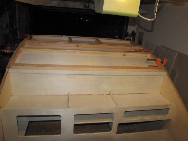

The front cabinets look great, I can't wait to put the doors on with the hinges and latches.
The front curve looks sweet!
There are a ton of little things that have to be adjusted so it all fits right. It is really good I did a trial run otherwise, it would have been a mess!
Then I'll take it apart, polyurethane it, glue it and screw it, and start wiring. I have already put together my shopping list and picked out most of my lights. One sort of major screw up is I didn't leave enough space on the roof for a high wattage solar panel, so I might have to settle for something smaller.

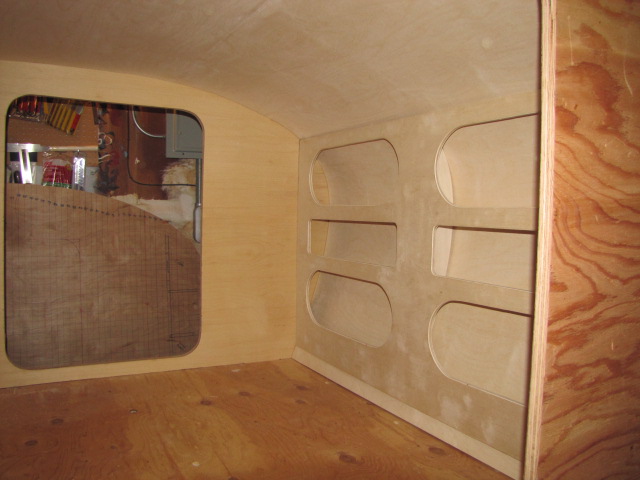

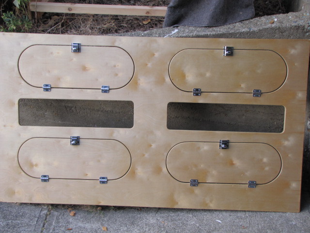

super happy with the way the front cabinet turned out - I think the Galley cabinets will look nice too when done. Gonna install it all this weekend!

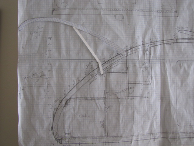

I have been down with a flu all week. I couldn't work so I did some planning. How is this for "old school"! I am planning out the hatch support (Camp-inn style)
I am going to frame this drawing when it is all done. 8)
I did assemble my project last week. It all went together after a few adjustments. So now I am working on wiring and will build the hatch soon.

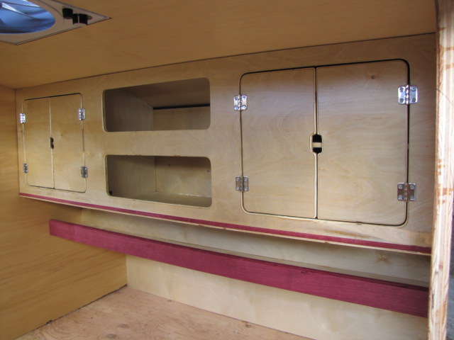

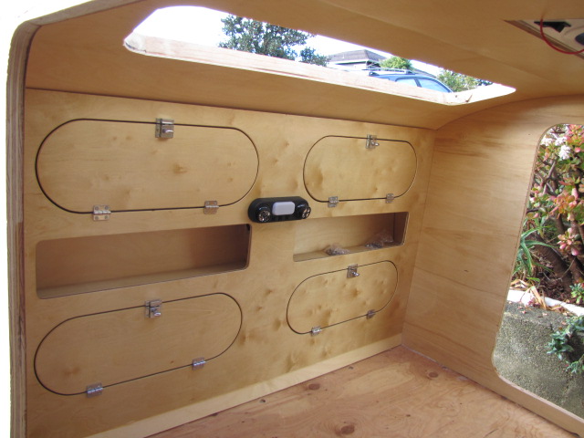

Postby drewh1 » Wed Nov 20, 2013 6:53 pm
Progress! The inside is complete, cabinets are done and installed. I used a piece of Purple heartwood to trim out the shelf and cabinet in the back. Wish I had done some trim on the front cabinet too. I will probably integrate some into the galley. Fortunately, I also remember to drill holes for wiring BEFORE I installed the cabinets, made it a lot easier. There are lots of small mistakes :x , mostly not visible but a few will probably need some corrective work
I still need to finish the counter portion of the galley and may do that next, or may work on wiring. :twisted:

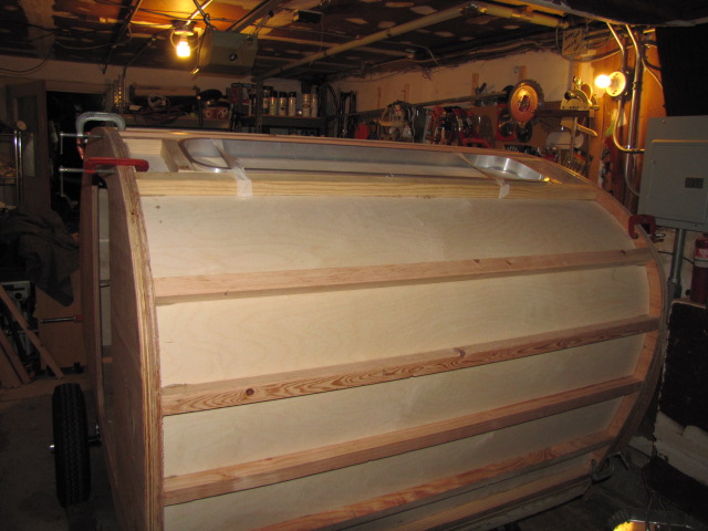

Postby drewh1 » Thu Nov 28, 2013 10:12 pm

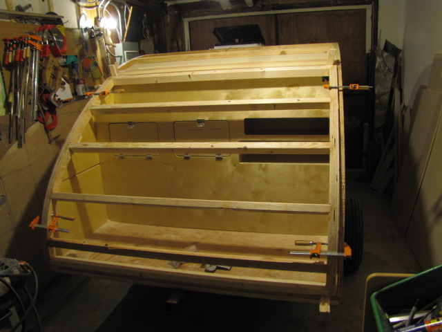

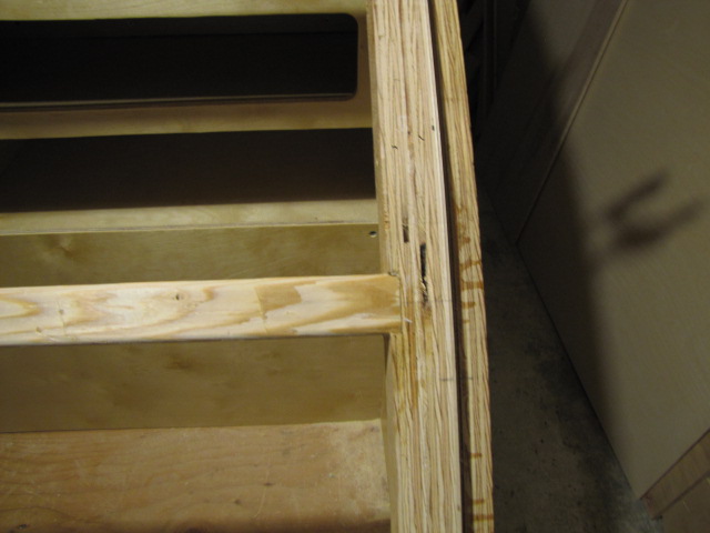

Happy Thanksgiving - a couple of days to work on the project.
Got the hatch framed over the last two days! this feels like a big step forward. For the hatch, I laminated two 3/4" pieces with some 1/8" birch to make the side pieces. Everything is 2" X 1 1/2 and dado'ed. I assembled, glued and screwed in place. Feels solid as a rock :) .
Now I am working on this hatch latch - I am using the 3 way and think it is going to work great once everything is lined up.
