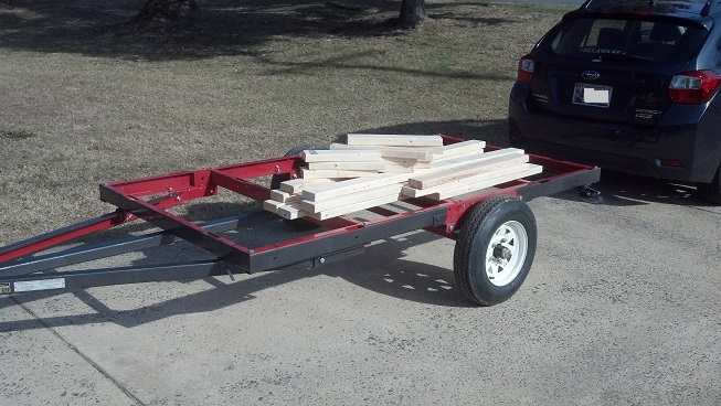

So I cut the 2x4s for the bed support frame to length, but ran into problems when the only table saw blades I had were 72 teeth or greater. Suffice to say, those did not work very well for ripping the 60.5" boards, but I did all of the shorter ones. I hit Home Depot for a 24 tooth ripping blade, but by the time I was back, it was too dark to work in the driveway so I had to call it a night. My brother's coming over tomorrow to help with ripping the boards down, I'm not sure what else I can "Oh just one more thing!" into getting his help with.
20140322 cut wood small.jpg (121.94 KiB) Viewed 2220 times
And I swear I'm going to fix the big missed spot on the trailer rail the next time I have the tire off. :oops:

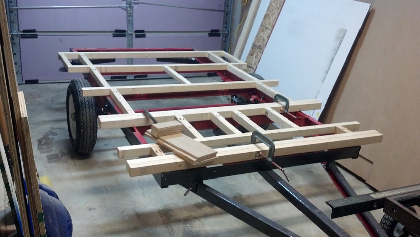

So my brother helped me rip down several of the sheets of plywood, plus showed me what I was doing wrong on the table saw. A "just a quick 20 minutes" turned into two hours of help. :lol: But I paid for that because he didn't bring his plywood clamp or other specialty stuff that would have made things easier. After he left, I started putting together the sub floor.
The ratchet strap is bringing two of the 2x4s closer together because the Kreg screws for that joint blew out so they didn't have a very good hold while the glue dries, with the excess strap secured so I could roll the trailer into the garage.
Unfortunately we're going to get snow on Tuesday, so the weather's turned back towards chilly temperatures and I had to quit working for the day.

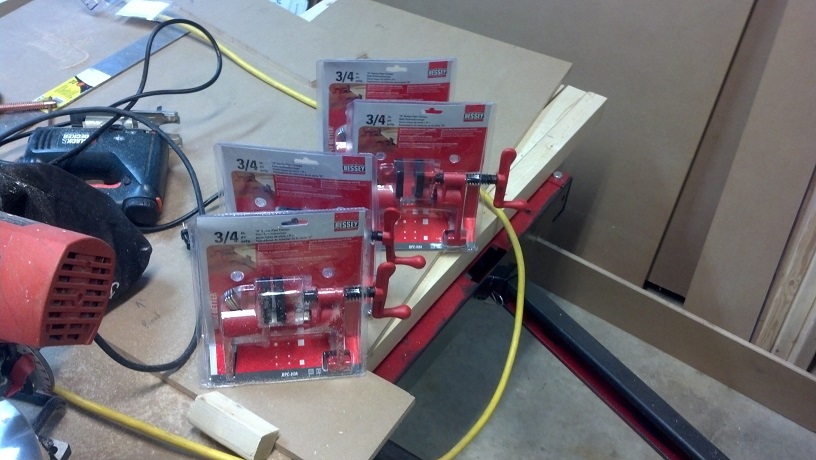

I figured some pipe clamps would make this easier, so the mailman (gotta love Amazon Prime) brought these today:
20140326 pipe clamps small.jpg (128.84 KiB) Viewed 2071 times
Now I'm dependent on USPS/FedEx/UPS for several items before I can really go any further with the floor, I need the taper drill/countersink and the torque washers the most. The weatherman says we have an 80% chance of rain on Friday and Saturday. :cry: Plus I need to make a rack to hold the pipe clamps.

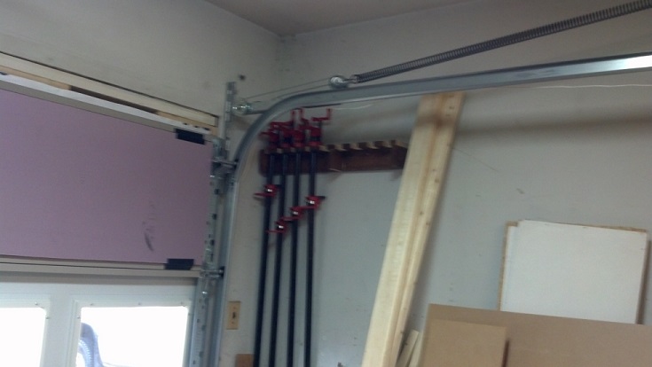

But, I did finish my pipe clamp rack, I miscalculated on the length of the rack, so it holds 9 clamps instead of the intended 8. :lol:

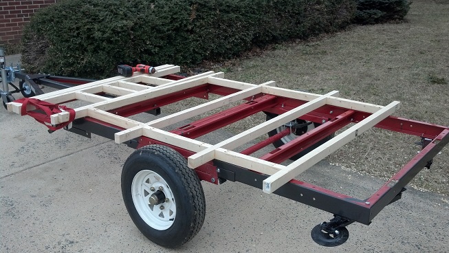

End of day progress:
20140328 night small.jpg (130.51 KiB) Viewed 2100 times
The small bits on the subfloor are the pieces for the wheel wells.
The three clamps are just a dry fit, I need to get some decent screws to connect the doubled 2x4s together.
My torque washers showed up, so tomorrow I can fit the battery cages.

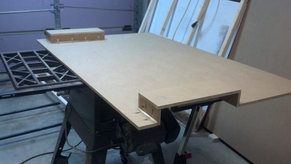

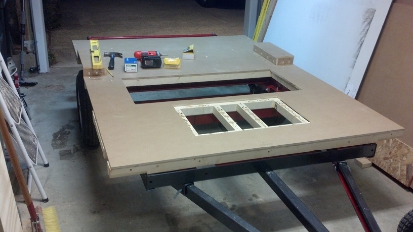

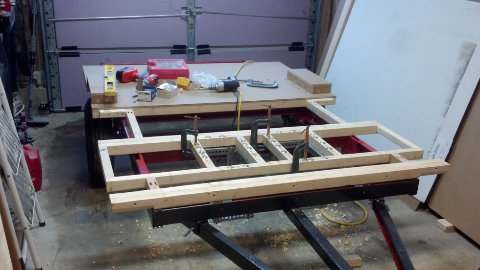

I had a pretty successful day, the rear floor panel is now piloted/countersunk and temporarily screwed in place so I could work with the forward panel and do some planning there. I added some blocking for the forward panel to rest on where it meets the rear panel, there will be some more blocking along the exterior once the front panel is screwed down to make sure everything is square.
20140330 end of day small.jpg (167.44 KiB) Viewed 2029 times

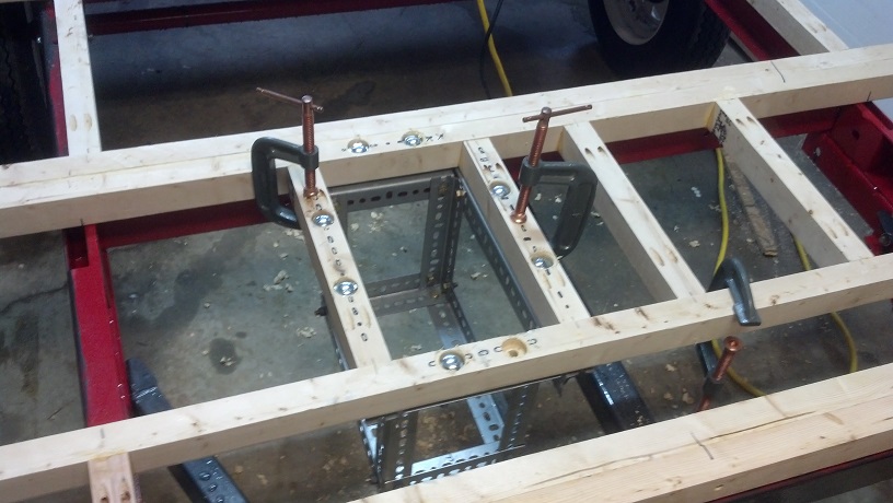

I also drilled the subfloor for the battery cages. Complete pain in the rear because for the first 10 holes I used the 3/8" bit first, then tried to Forstner them so the bolt and the torque washers would be below the floor level. That was a complete mess, so for the other 10 holes I wised up and used the Forstner first. I have to add strips of plywood around the exterior of the battery framing, so the floor can rest on them and won't cover the carriage bolts in case I ever need to remove them. I'll use a number of screws and gasket to seal the battery door down, I expect to use it once or twice a year at the most so being difficult to open is better than a water seepage point under the mattress.

The next problem is how to cut the two panels (storage and battery) from the front panel, I'm not happy how the jig saw did for the wheel wells. I guess I could plunge the circular saw, the kerf would be much larger, but the cut would be a lot straighter. :thinking:

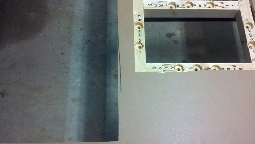

So I finally jumped in and used the circular saw to cut out the battery and storage hatches. I wish I'd used it from the start, but I also should have had a better plan than removing the fence and free-handing it when I went back to the rear corner on this cut.
20140401 Oops small.jpg (86.24 KiB) Viewed 1963 times
Now I need to add more blocking around the battery compartment, I cut wide to make sure I could get the torque washers in/out of their recesses, and countersinking everything for the front panel. After that, it is on to the storage box. :roll:

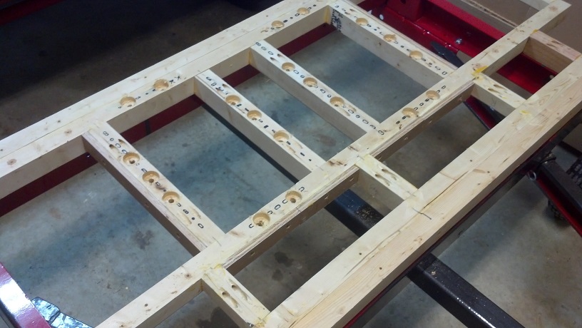

So today I drilled/countersunk the forward floor panel, plus added a few more screw holes to the rear panel just to be sure.
I also added some blocking around the battery boxes so the floor panel will have something to rest on and not have that ugly gap from the previous photo.
20140402 battery blocking small.jpg (125.26 KiB) Viewed 1896 times
I think I'll need to add two more runners over the frame members in the battery bay so I have something to bolt through, with the Kreg slots in the front bay I'm a little worried about getting a suitable bolt in there.
