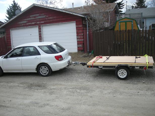

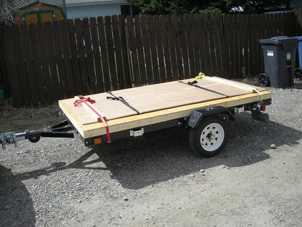

Postby Shar » Tue May 13, 2014 1:10 pm
We took the trailer out for its first run this morning, and picked up the 1/8 ply from Windsor plywood. We had planned on getting birch ply, but the few sheets they had left were ugly looking, so we spent a little more and bought maple instead. I am amazed at how strong that stuff is!
I have 2 days off work (starting tomorrow) so I hope to glue the plywood to the foam side walls, and start prefabbing the other walls- we'll see how much I get done. With any luck, I won't have to use the angry emoticon! :)
Here's our rig, just home from getting the ply.

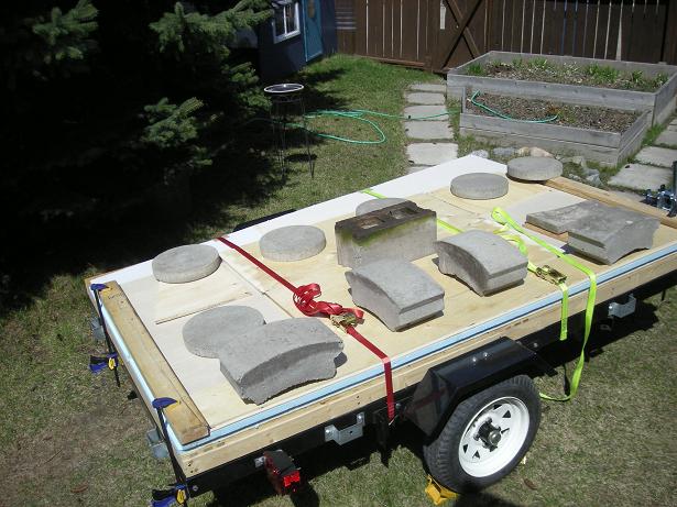

Busy day! I set my tools up in the back yard (it was warm and sunny) and got going on two things at once. One objective was to bring out one of the foam side walls, and glue the 1/8 ply panel to the inside of it. The challenge, as most of you know, is compressing the whole thing so that the layers are as close together as possible while the GG cures. We used all the clamps I had, both my ratchet straps, and every heavy thing we could find on the property. It still wasn't enough; on the middle of one side the very edge has a gap. Maybe I can squeeze some glue in there at a later date, and clamp it? Not sure. We kept it clamped/pressed for 2 1/2 hours, then brought it back inside. I am confident that when we do the other wall (tomorrow) we will be faster and better with our placement of stuff.

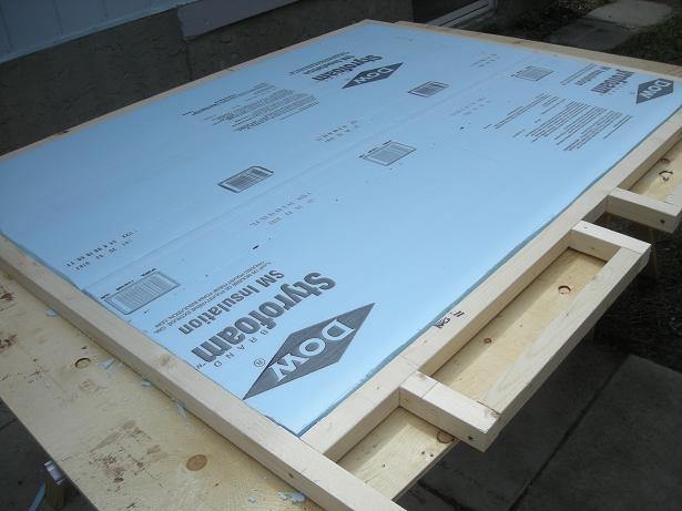

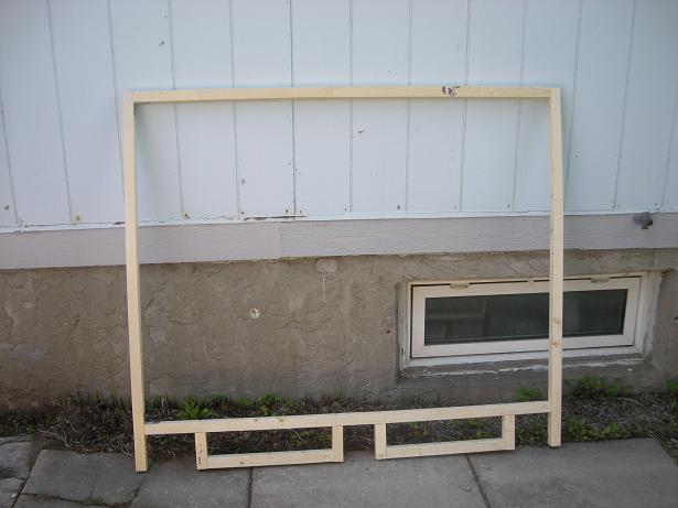

Part two was building the front wall. I framed this today, and did a test-fit of the foam insulation, and prepped the ply to be glued on. By the time all of the above had been done, I was exhausted. :SH I am currently taking a break, but later this evening I plan to glue & screw that plywood on, and maybe even glue the foam in as well. I have 2 days off, so I am trying to make all the tracks I can.

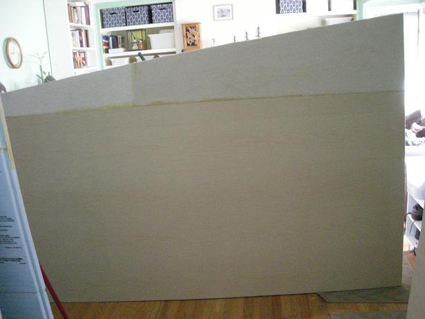

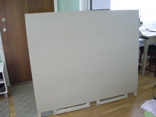

Here are the fruits of yesterday's work: two wall panels with inner ply attached. It's raining now, so I can't do the other side panel, but I will insulate the front wall and put a coat of polyurethane on that nice veneer- all the parts that won't be glued later :D and visit the hardware store again for a few things. One annoyance is that I can't find 4' wide foam anywhere, in any thickness. I thought I could get the 1" foam in 4x8 at Rona (this would be for my roof) but when I went there to get it, they said they don't carry it (the website says they do). Oh well. I will have to glue 4 sheets of 2x8 together. That stage will be further on in the process.
If the day goes well, I will start framing the back wall. I cut most of the pieces out yesterday, so it should be workable as a living room task. I love how patient my family is. :D

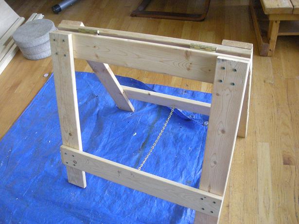

Just for fun- a folding sawhorse made from discarded Ikea bed slats! One set of bed slats can make 2 of them; I need to get some more chain before I can make the other. Good thing to do while glue is drying. 8)

If anyone is curious, the reason I have that funny framing at the bottom of the wall: there are 3 bolts inside the wall, that hold the floor to the trailer, and I wanted to be able to access them in future, if we ever need to take the cabin off the trailer frame. When the trailer is "put together" more, I will attach a narrow panel to cover that area. Then my paneling won't have "flood pants" anymore. :lol:
