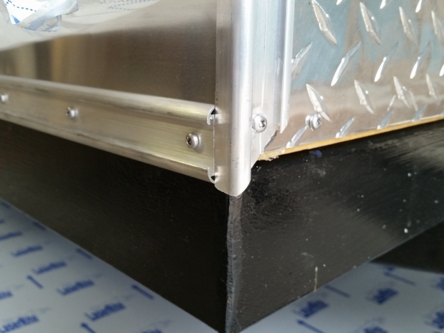

I picked up the four sheets of aluminum on Friday! I then spent the next two days getting it on the camper! After day two, everything is skinned except the hatch.
I ended up using OSI Quad window sealant underneath all of the edges of aluminum and trim. I chose clear which turns out to be very accurate. You can barely see where you put the stuff! I was a little confused about what sealant to use at first but was very happy with the OSI quad application and I am confident that it will hold up well over time. Thanks to those who suggested it!
The one problem with the aluminum application was how cold it was! Both days had highs in the 40's and which posed multiple problems. The OSI sealant was at the very low end of the allowable application temperature and it often took two hands on the caulk gun to get it to come out. After squeezing out 8 tubes, I definitely got a good workout! The bigger problem that I could not avoid has to do with applying the aluminum on a cold day. I know that it will expand on a warmer day and oil can some. Hopefully this will not be too much of an issue. From day one I wanted to skin on a hot day but my build schedule just didn't allow that.
Anyways, here are the pics:
Unfortunately the metal distributor would not deliver the aluminum to my residential address because I did not have a fork lift. So I borrowed a 5'x8' utility trailer from my neighbor and whipped up my own pallet to allow the trailer to fit the 5'x10' sheets. Just as a reminder I ended up with four sheets of 3003 at .040".
And then the aluminum just appeared! Just kidding this is like two hours later..

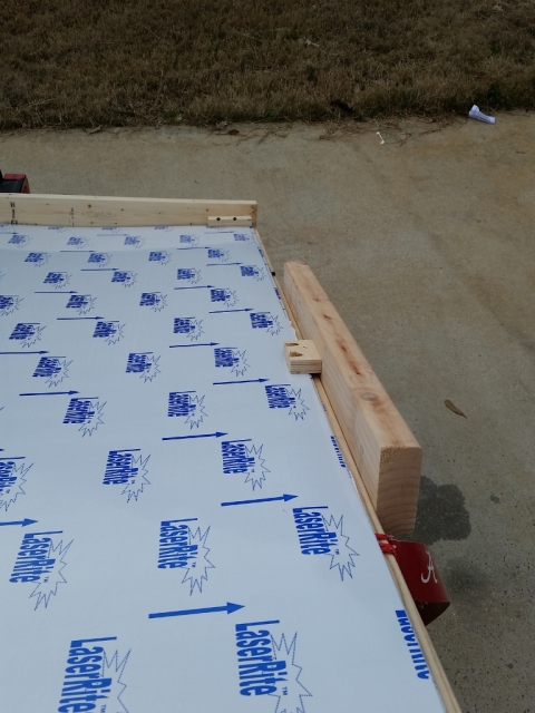

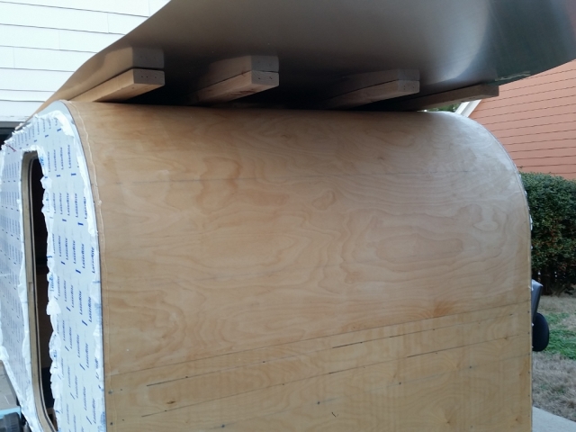

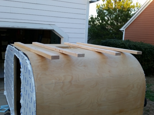

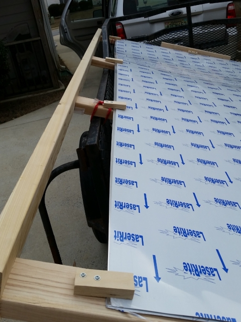

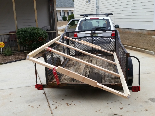

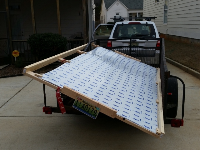

Instead of tying down the sheets with ropes I tried securing them with wooden blocks that I screwed into the pallet. This worked better than I could have hopped for!

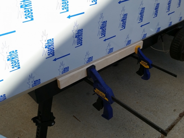

I used wooden blocks clamped to the frame to initially hold the aluminum at the right elevation.
As most of you know, you need a partner for the big aluminum application day! My lovely wife was a big help! I don't know why shes wearing a dust mask..

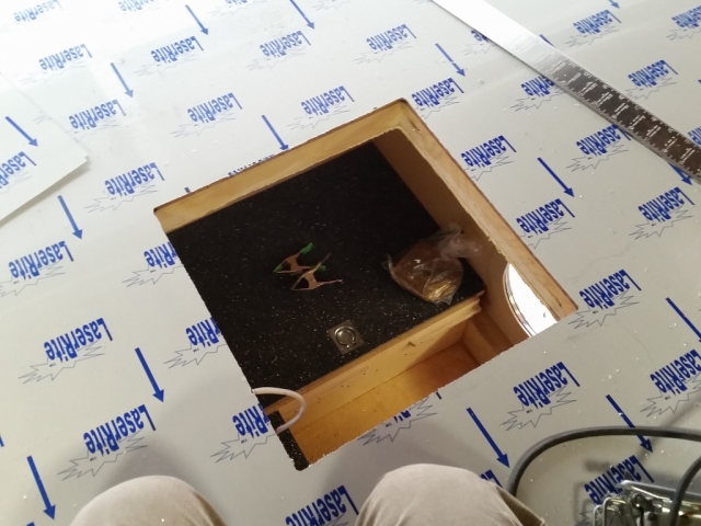

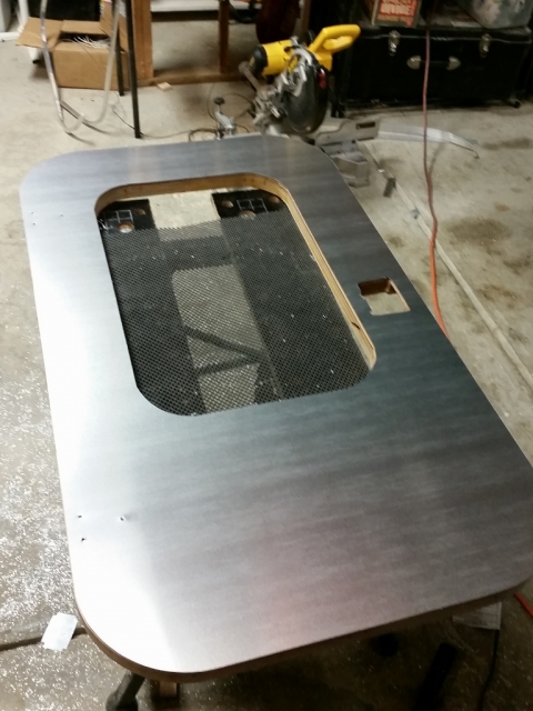

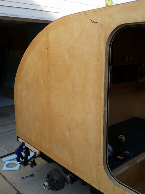

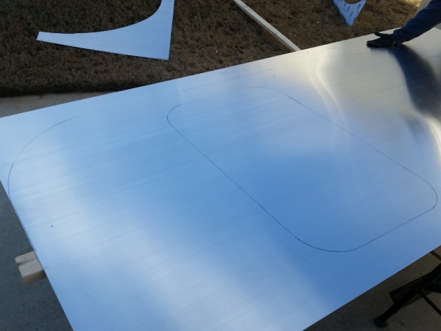

To make the routing easier, I drew the outline of all of the edges on the inside of the sheet then performed a rough cut 1/8" - 1/4" offset from the line with a jig saw.

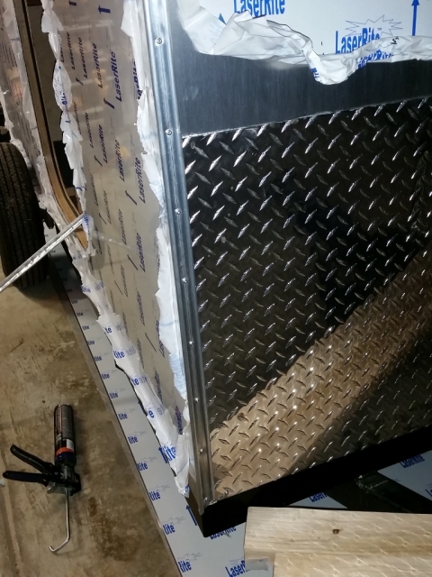

Running a bead of the OSI Quad sealant on the edges of the sheet. You can really see how clear this stuff is! Or can you even see it??

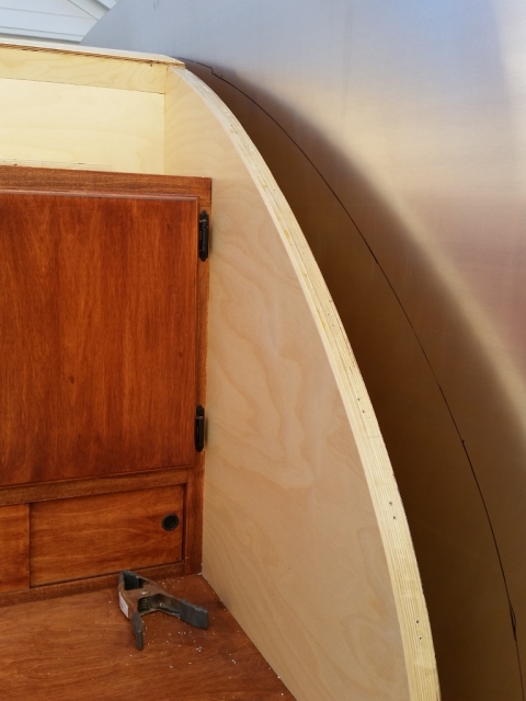

To align the top sheet on the roof without smearing it, I implemented the same method that I used to get the top sheet of plywood on: Aligning it on top of some boards, then carefully sliding them out.

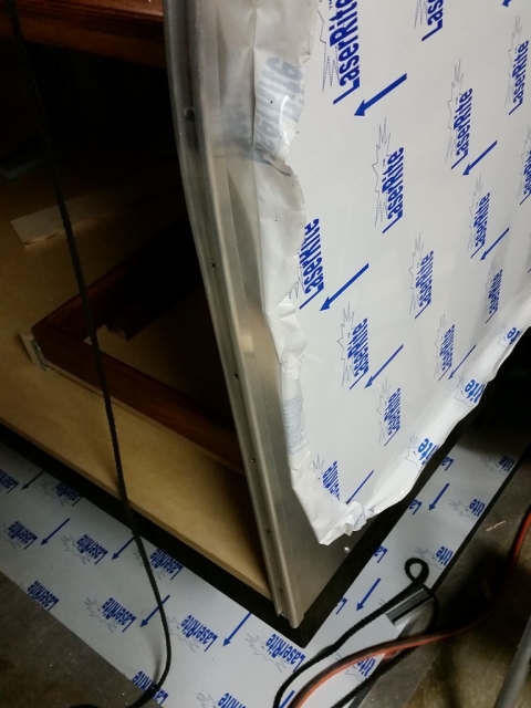

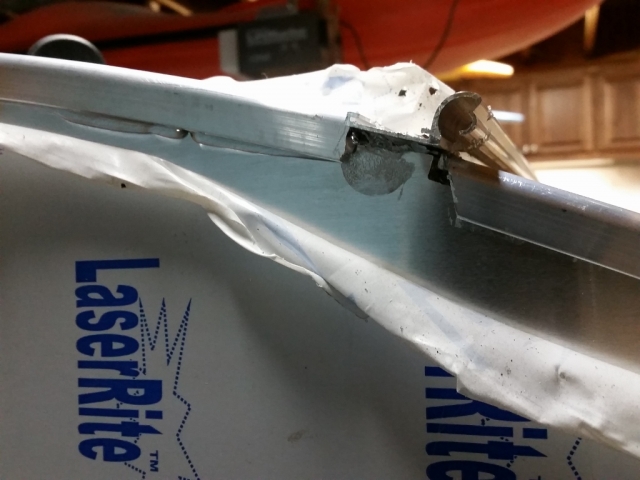

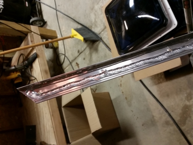

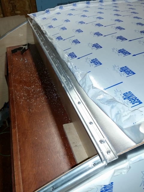

For the edge molding, I ran a bead where the two sheets meet on the corner, then a second where the trim contacts the roof. I was originally going to use butyl tape on this molding but it was to cold and the tape was rigid and not very tacky.
The distance from the hatch hinge to the front of the trailer is slightly longer than the 10' sheets that I found, so I supplemented with a 2 foot tall diamond plate rock guard on the front.
Sealing up some of the seams.
Got the hurricane hinge in for the last time! I hope..
Trim on the edge of the galley.
I left a gap where I am going to put some rain diverters. I made some but wasn't happy with them, so I am going to make some more..
I used some "flush" insert molding to cover the gap between the wood and frame.
The completed rock guard! Well I may still add some trim on the seam. I just realized how reflective it is! Shiny :shock:

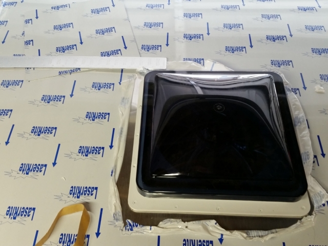

Installing the roof fan! I used the butyl tape this time.

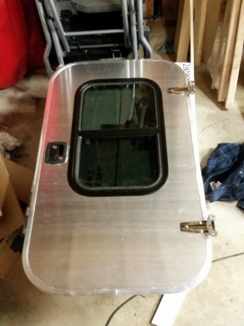

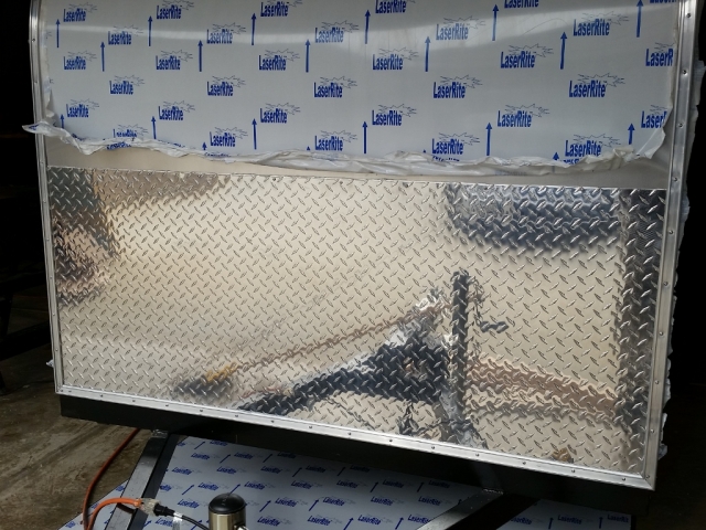

Getting some aluminum on the doors! It was just easier to remove all of the plastic on the doors.
