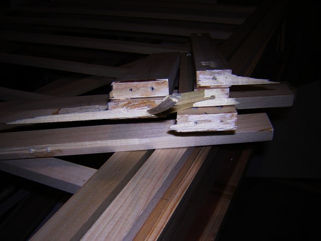

For bare wood, it's hard to beat Titebond III (provided you follow instructions); plus, once dry, it is a waterproof glue. Yet, while it is still wet, you can wash it off with water or wipe it off with a damp cloth. How strong is it? Here is a picture of some pieces that I tried to carefully pry apart:

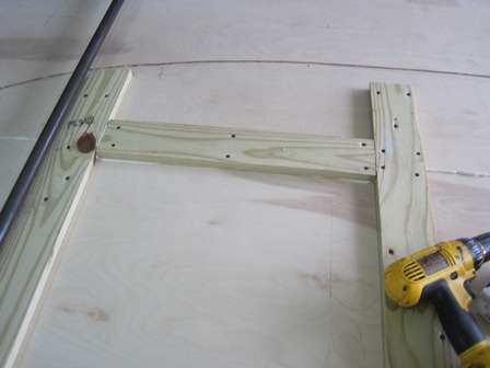

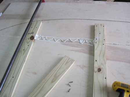

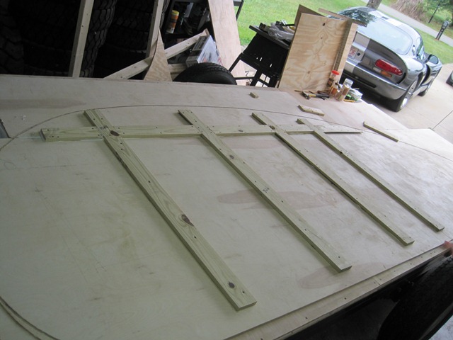

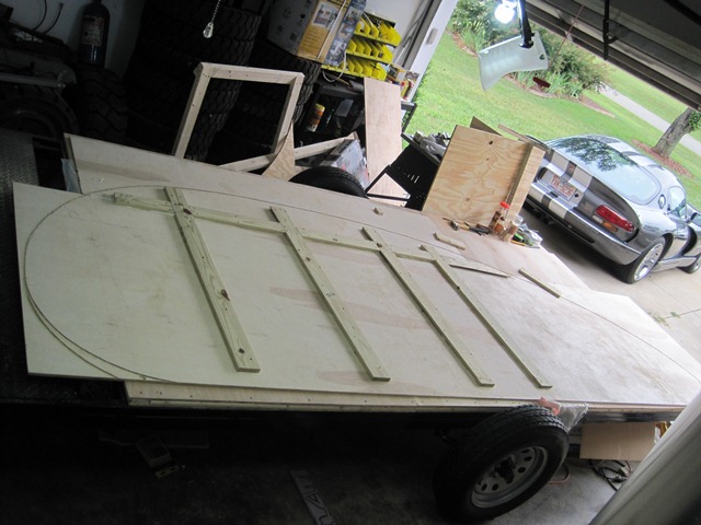

Slowly making some progress. Only made it out to the garage for a few hours on Saturday, was able to use biscuit jointer to joint together the 4 pieces of plywood, Glue them, then added some wall studs.

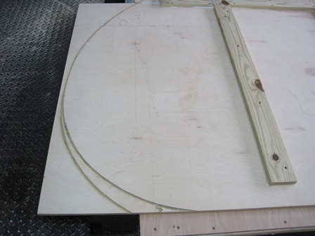

Last night I added a 2nd layer of plywood underneath the first, this will be for the other wall. Tonite I hope to finish routing the first wall, and by routing just a little deeper it will also rout out the design on the 2nd layer for the 2nd wall. Then should finally be able to stand the wall up and get a profile photo......That will feel like a mile stone for me. :)
Also I changed the front lower profile a little bit to make it not quite so rounded at the bottom.
Heres a few photos of Saturdays work
Gluing the wall studs.
New Profile routed on lower half of front.

Postby BuildingForFun » Wed Aug 06, 2014 7:34 am
Jointed, Glued, and wall studs screwed together.

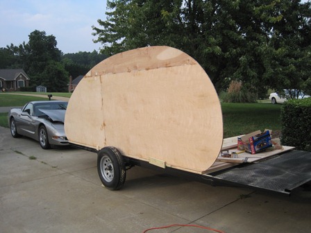

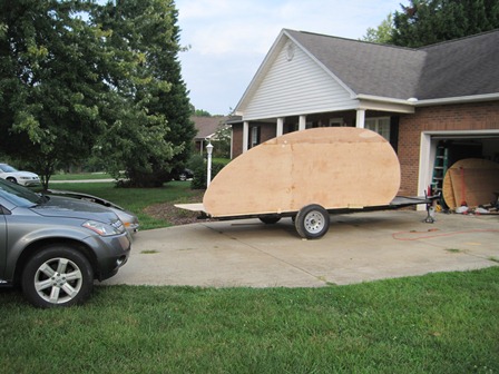

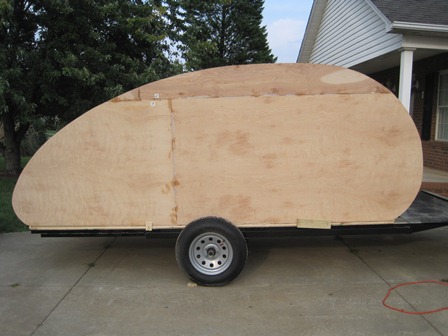

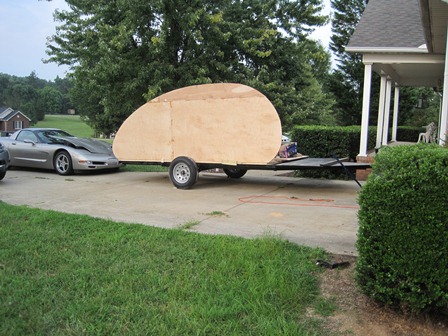

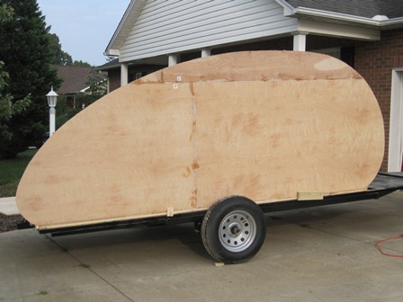

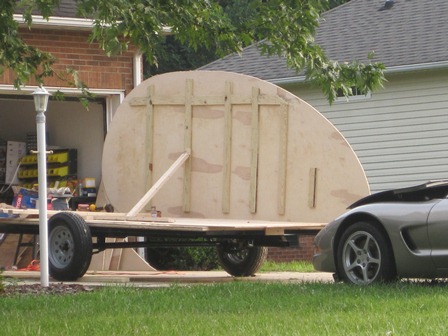

So, Last night I feel like I made it to my first milestone. I mocked up one wall for a profile photo...... :) :) :) I was so please that I didnt want to take it back down. I am very pleased with the overall shape, Just need to make one last minor change. The other thing I decided was to switch from a straight axle ( which is what we keep in stock), to a drop axle ( which will be a special order). I will make this change later. The bottom of the frame is about 17 to 18 inches off the ground right now, with a drop axle I hope to lower it to about 10 to 12 inches.
I took quite a few photos of the wall stood up (just really excited) PLEASE LET ME KNOW WHAT YOU GUYS THINK. Thanks.

Postby BuildingForFun » Thu Aug 07, 2014 8:17 am

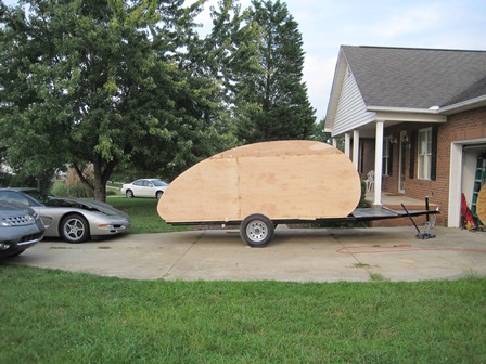

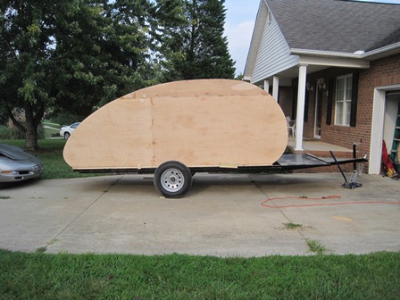

More Photos

Last ones. :?
Back Side

Postby Sheddie » Thu Aug 07, 2014 4:26 pm
Wow! That's a monster! Very nice shape. Teardrop that is. :beautiful: I hope the wife was out, she would have been hard pressed not to see it parked in the drive.

Postby S. Heisley » Thu Aug 07, 2014 7:25 pm
Sheddie wrote:Wow! That's a monster! Very nice shape. Teardrop that is. :beautiful: I hope the wife was out, she would have been hard pressed not to see it parked in the drive.
:snappy: Keeping a note on driveway occupants. Nova, Cobra, Corvette. They would all look good in my shed.
Sheddie.
Regardless of whether the wife saw it or not, I think she is going to be amazed!

Postby lee senn » Fri Aug 08, 2014 6:54 pm
Looking great! I think you really nailed it on the shape. I am looking forward to following the rest of your build. Lee
