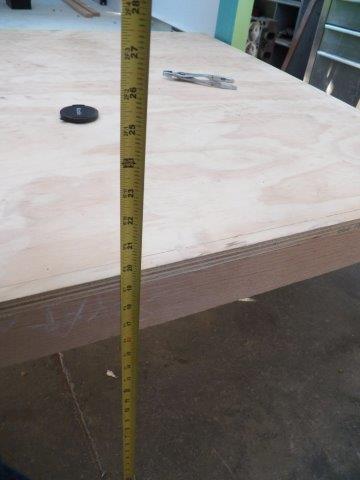

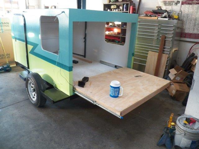

Boo and I have been kinda loafing it lately on the trailer. She has been painting the doors slowly. She finish the doors today. Then boo and I put the slide base back in. Time to build out the slide. We need to get this done for the 22nd Dam Gathering. I already reserved a spot for her!
Boo finished the doors. Just needs to take the tape off.
Slide base back in. You can see that I added cross members to the base bottom. I was always going to do that but I had to take it back out first. The inner cross member is inset a few inches so I can mount a caster in the middle that will run along the floor. Slide base is 3/4 ply with oak frame. Sides and hatch will be built out of 1/4 ply.

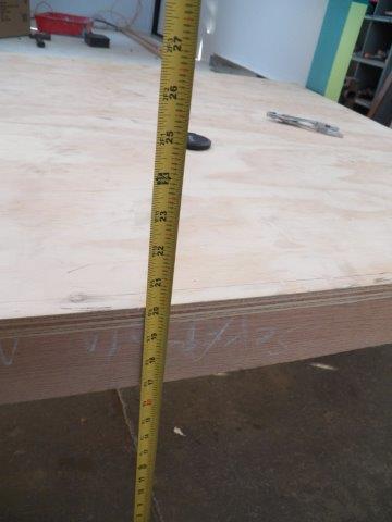

The next two photos are with the slide base unloaded and then with all 220lbs of me on the very edge of the slide. The slide only flexed 3/8 on an inch! It also slid in very easy with me on it.
I will be adding the folding adjustable aluminum legs to the slide out. To make the slide super stout when its out They are rated at 200lbs each.

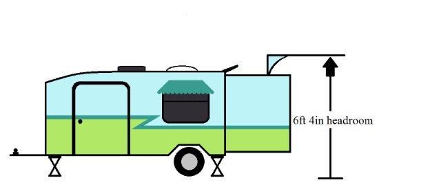

Boo's renditions of her trailer never really showed how the rear hatch was going to be built. She redid it today. It should have 6'4" of headroom under the hatch
Boo made a rendition of what the galley should look like. Counter height should be the standard 36 inches.

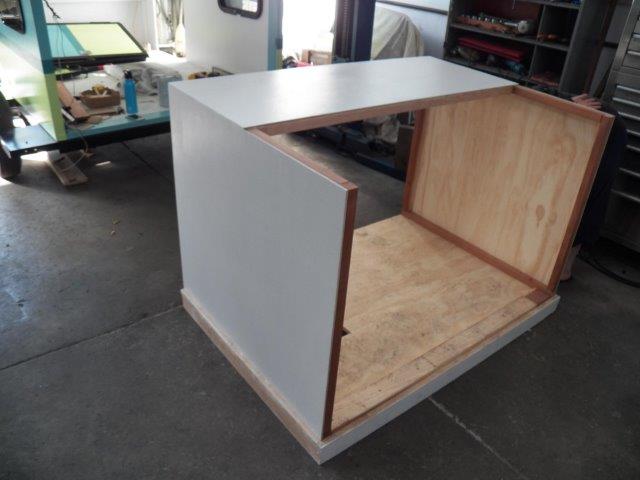

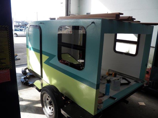

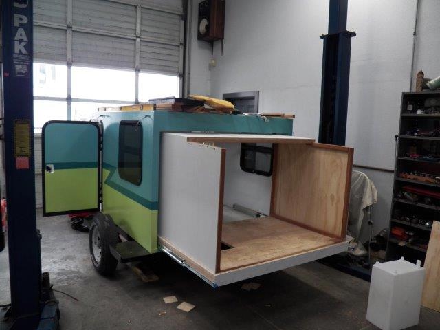

Ok, I'm guilty of being a slacker on building and posting. But Boo's got me on the big push now. We have done a few things lately. We will be building the hatch for the slide out today.

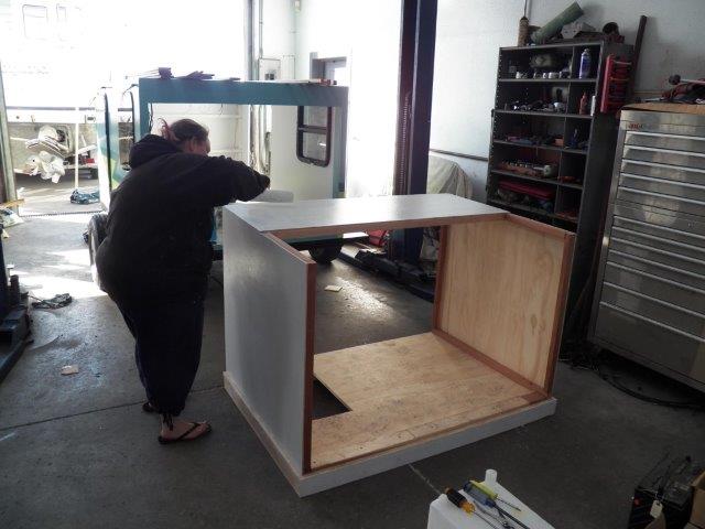

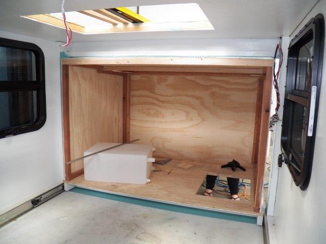

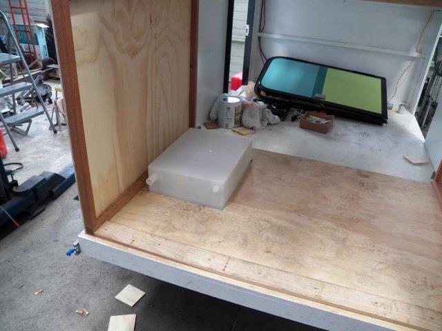

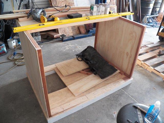

We started building the slide out. The hole cut in the floor is for the holding tank, to get it below the sink base. The slide out is sloped to the back for rain/water run off.

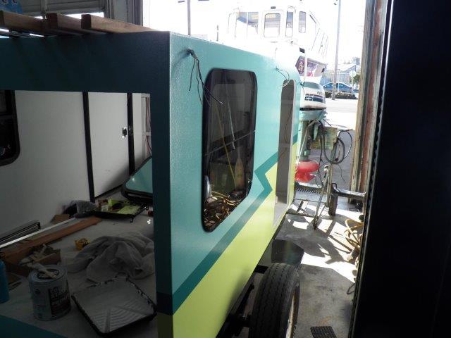

We installed the windows.
Boo primed the slide out.

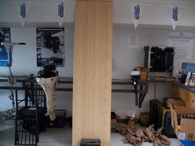

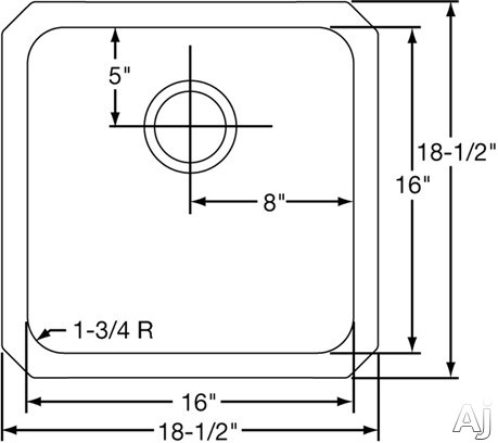

Boo bought Bamboo for the counter top. I bought a under mount stainless sink that has a bowl size of 16"x16" and 4.5" deep.
Test fitting the slide out. It fits perfect and is square for some unknown reason.

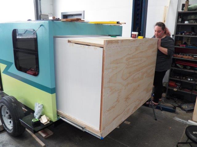

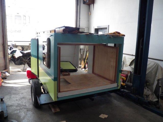

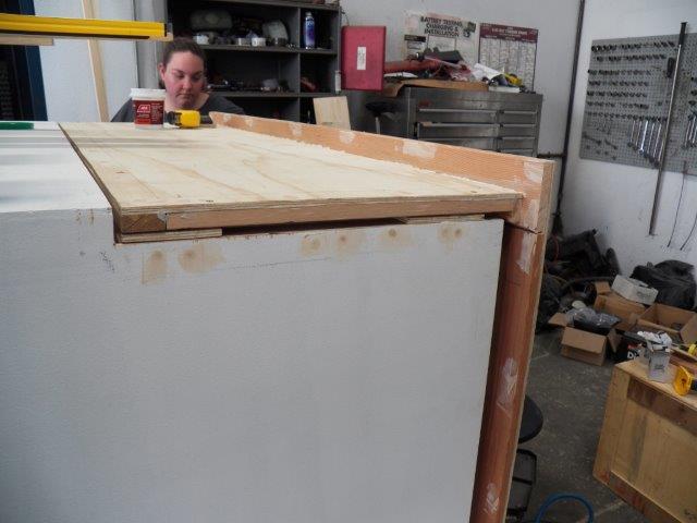

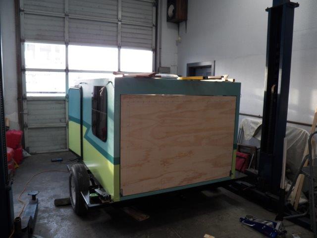

We worked on the hatch last weekend an this weekend. I have to say, this has been the most time consuming part of the whole project. We are still not done with it yet. There are so many things that have to be perfect to seal everything. Let alone open and close properly. There are three separate set of seals. One set seals the galley when it out. One set seals the slide out to the trailer when its out. And one set seals the slide out to the trailer when its it's in. We weighed the trailer today. With stuff on the roof and supplies and tools inside it weighed 960lbs. With the slide out in, it has a tongue weight of 176lbs at this time. We are pushing to make the Dam Gathering with the trailer road worthy but no where near finished.

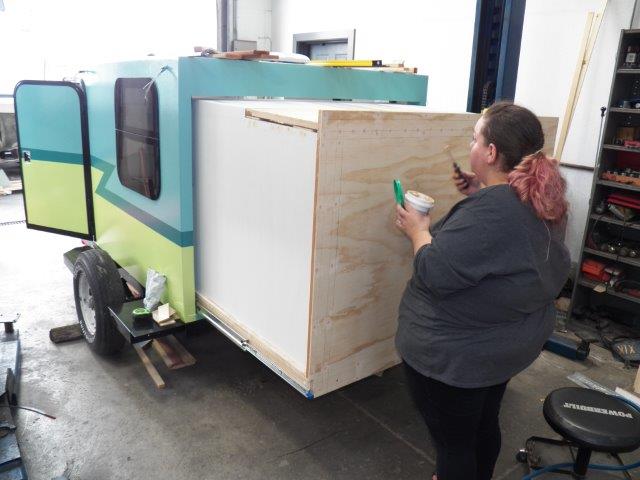

Boo checking clearances and filling screw holes on the hatch. Hatch is spaced out for seals/hinge and screwed down to hold in place till the glue dries.
Next two photos show the slide out all the way in. And from the inside with it all the way out.

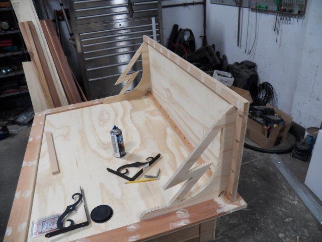

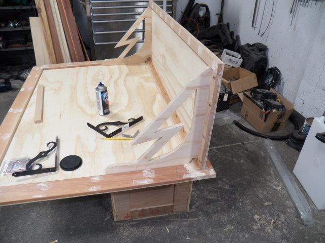

Once it was a proper fit, we took the hatch off the slide out to do more work on it. Since things a going a bit slowly, Boo decided to make some fancy corner braces for the hatch. She drew out the pattern but I had to take them over to my friends house so he could cut them out on his scroll saw. It's a Z pattern that she will paint the same color as the stripe on the trailer.

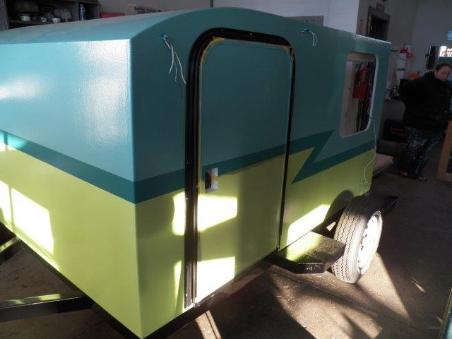

Postby Patti » Mon Apr 27, 2015 10:41 pm
Awesome lightning-bolt... well, whatever that is in the last pic. It is like the one on the sides, right? This is looking so great!

Where did you find that awesome bamboo countertop?
Michael
