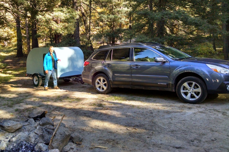

Postby ChasCABQ » Wed Jun 07, 2017 9:41 pm
I sold my teardrop trailer since I didn't need it. Sold in one hour parked in front of a friend's house Memorial Day weekend. New owner has a trailer ready for customizing. I enjoyed building it, covered my costs selling it, and had one comfortable night's sleep in the mountains in it.
Decision to sell came down to two things: wife didn't want to car camp anymore (bummer!) and I didn't want to tow a trailer just for one person.
I'll car camp by sleeping in my Subaru wagon or use a tent for now or I may buy a car top tent with the proceeds. I learned a lot of cool new things building it and interacting with all you other owners and builders here on the forum and in real life. Thanks for the help along the way!
First and only camping trip, Jemez Mountains, New Mexico
