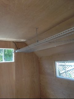

Today I installed a 12" wide overhead rack- a place to store a jacket, hiking stick, binoculars, energy bars, ramen noodles, pringles chips. A piece of plumbers strap is supporting the center.
- I might put a 16" wide one somewhere in the back. I can store extra bedding ,clothes, towels, etc., on it. I just have to make sure it won't turn into a head knocker. You can only store lightweight items on the overhead racks in order to keep the center of gravity low.

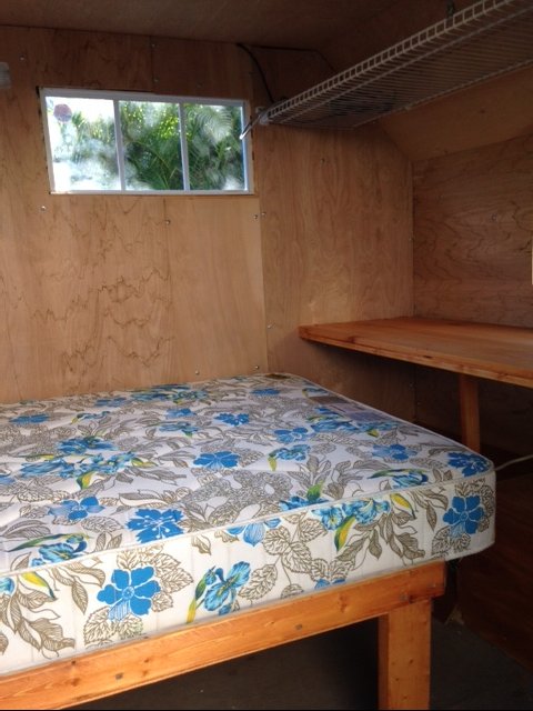

Postby Gold5one » Wed Mar 18, 2015 5:51 pm

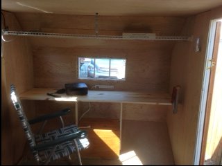

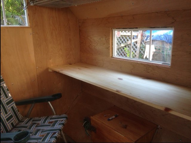

I put in a 16" wide counter today-- now I need to figure out how to finish the center-- a small cabinet or some drawers or a combination of both.Probably finish it with clear polyurethane.
This interior work is slow going-
I just realized I need some access holes in that board, for cables and cords

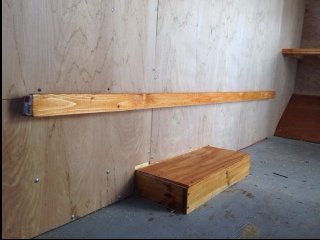

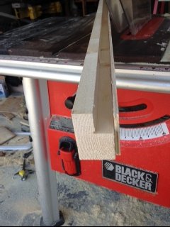

I fixed my counter/hobby bench and gained another 3/4" in width. I used a couple pieces of 1x2 spruce screwed to the back of the counter and then to the wall to give me 3 slots for wires and cables. I supported the front center, too.
I checked the operator position of a ham radio and it will be just fine. Checked how a reloading press will work out, too- for when I go to the range to develop a load for best accuracy.

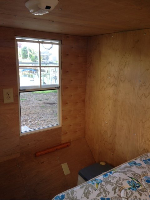

I almost got finished with my new idea today, a sliding bed - I checked it and it will work- I need one more modification to the support frame-
The way it works is like this, I can slide my bed 3 feet to the front of the trailer at night- that uncovers the porta potti in the back under the bed- and I have dressing area in the morning, too. Then I slide the bed to the rear and cover up the porta potti and recover the open space in the front of the camper.
the wall rail-
The the bed frame slide track on the wall - I will screw a small strip on the wall above the frame, so it doesn't bounce out of the track on the road.

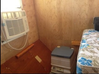

Postby Gold5one » Wed Apr 01, 2015 7:06 pm

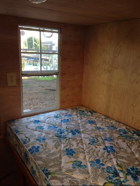

I finished the sliding bed-- and it works! Its not hard to slide and once the poly-fiber outdoor carpet is put down, I expect it to slide even easier. I wonder if anyone else has thought of doing this? A google search of this website for- "sliding bed"-- says I am the first to build one.
- slide forward for the night-
slide back in the morning-
night time-- bed moves forward to reveal the porta potti.
easy access to the potti at night-
bed slides to cover up the potti in the daytime-

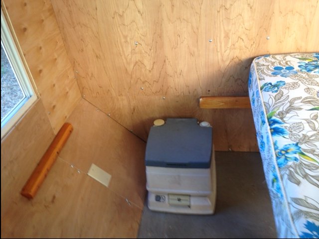

Postby Gold5one » Fri Apr 03, 2015 3:18 pm
It was pointed out to me that I have a potti with a view- :oops: - which I suppose is better than a potti in a dark closet. Today was 87 degrees, so I did a job that was on the list= install the rear A/C. I'm all done but for the final sealing and screwing the A/C down with strap. I'll say this, I'm all set for Arizona in the summertime. Low speed cool on #5 is plenty cool. I think I will bring along a quilt. My 15 yr old daughter gave me a nice colorful one to use that no longer fits her new bed.

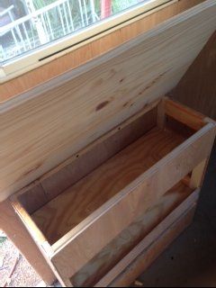

Postby Gold5one » Sun Apr 05, 2015 7:06 pm

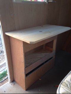

I pretty much completed the curb side storage cabinet this weekend. The battery and inverter goes in the bottom and the shelf above it is removable for access. A hinged counter covers the 6" deep storage compartment-- This curb side cabinet helps to balance the weight of the bed and A/C on the other side. I hope I can find some small plastic tubs that fit on the open shelf.
