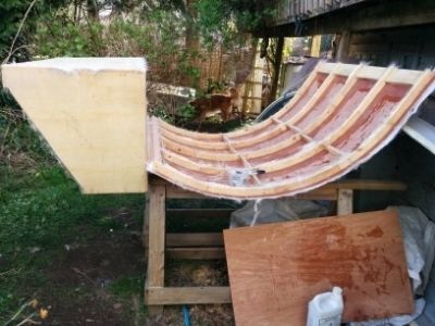

Last night I cut away the tabs on the tongue box and had a look at the joints. The tabs worked like a charm - the lid stayed square to the box and it actually took longer to clear away the cut tabs and pull the pins out than it did to cut through them. In hindsight, I should have left the back off the box so I could reach in and clean the glue that squeezed out, but it wasn't too tough to cut out with a razor knife.
I started putting putty into the inside corners with a radiused scraper to create a bit of a fillet for the glass and to fill screw holes etc. With how stiff and light the lid turned out, I decided I'm not going to glass the inside at all, just primer and (bedliner) paint. I'll still glass around the outside of the battery box to seal it from the rest of the box and the lower corners and bottom to protect it should any water get in and sit there. Tonight I'll sand down the putty I laid in last night and I'll continue with wood filler instead of putty. There are a couple warts on the outside of the box that need to be addressed so they'll get filled but I think it's just about ready to glass. While I'm in town next week, I'll stop at my marine supplier and grab a chunk of 1 1/2" piano hinge for it and the battery compartment door and a latch for both, though I'm thinking just a polished stainless hasp and a padlock for the battery box in lieu of an actual catch. The lift handle will match the one for the galley hatch and is one of the salvage ones I posted earlier. This thing is coming together...in my head at least ! :?
Last night's progress.

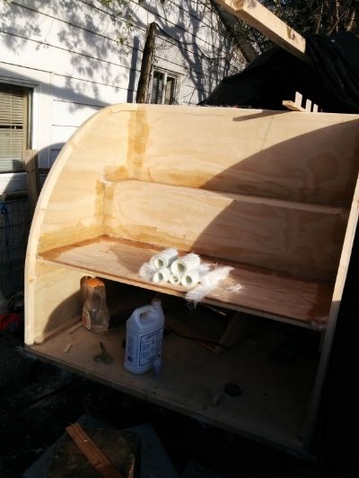

I got the galley corners tabbed in:
From here I can build out the cabinets as needed, though I am going to hold off on that until I've used it a couple times and have a better idea of what I want.
The remaining rolls of mat are to do the horizontal corners on the inside and to do the wall-to-roof corner from front to back.

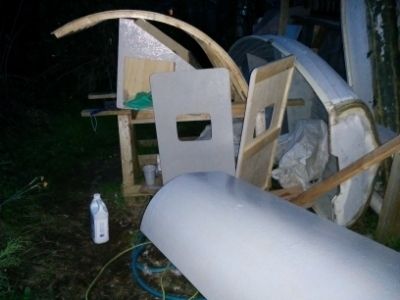

Tonight I rough-sanded the glass and got the grey resin on by literally the last light of the fading sun. It's supposed to start raining again, bringing an end to the bright sunshine we've had (that's been great for glassing !)
Except for the doors (the parts are done, some assembly required) everything is ready to start going together. If the neighbours aren't in too much of a hurry, that will happen this weekend....but I doubt it.
