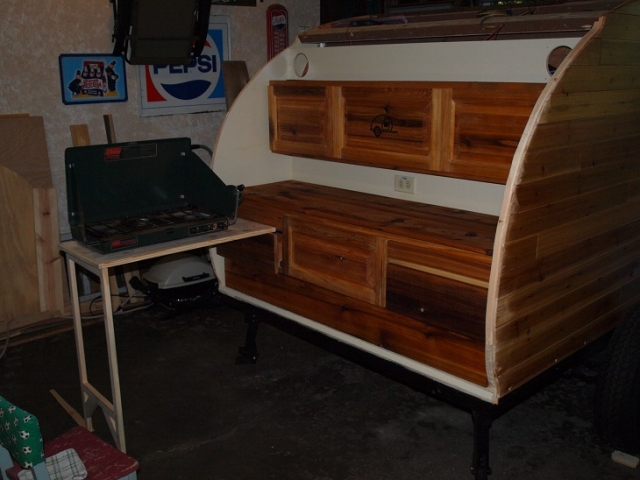

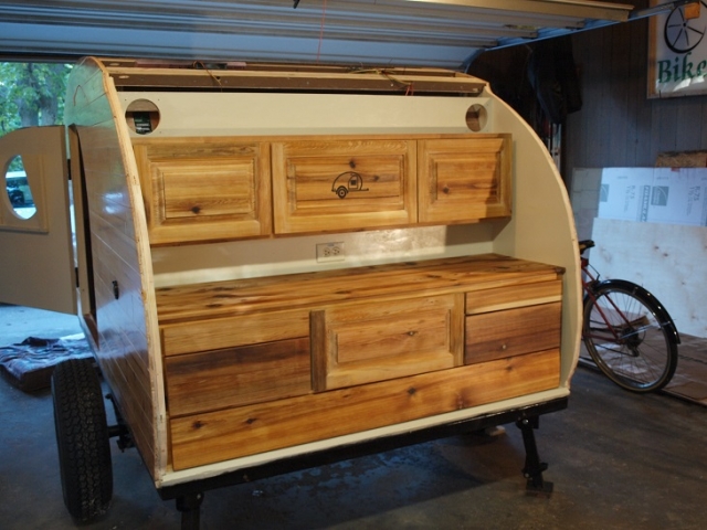

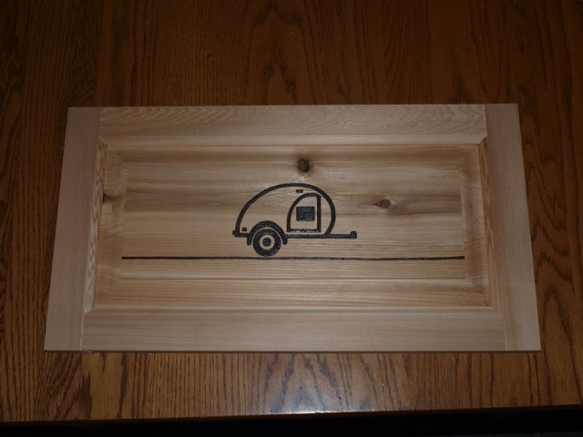

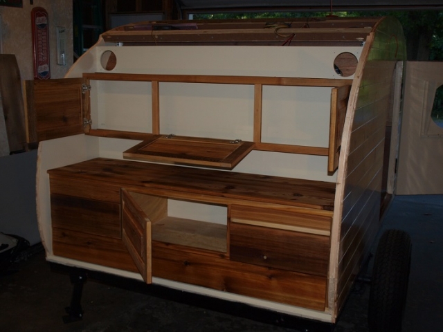

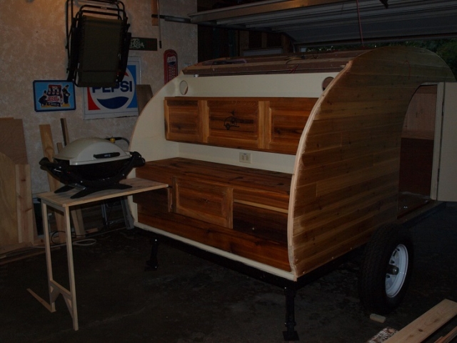

TimC wrote:Building my galley cabinets and doors. My neighbor has been asking me if I need any wood burning done; one of his hobbies. The result after seeing various TD logos...

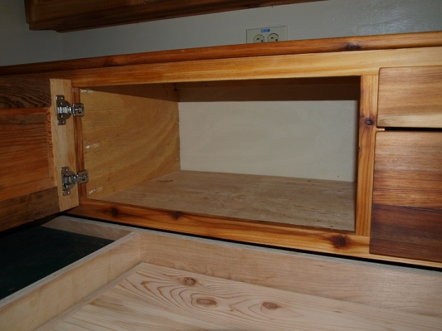

Next up is getting the cabinet doors glued up and installed. They are red cedar. I hope they hold up as red cedar is not the strongest material for attaching hinges.
dales133 wrote:TimC wrote:Building my galley cabinets and doors. My neighbor has been asking me if I need any wood burning done; one of his hobbies. The result after seeing various TD logos...
Years ago when i was cabinet making we used to rebate a fillet out or the back of door ect that were soft in nature and glue in a hardwood replacement.
You could even get a slot cutter and fit an insert on the hinge side of the door,glued in with tb2 would be strong as any hardwood
