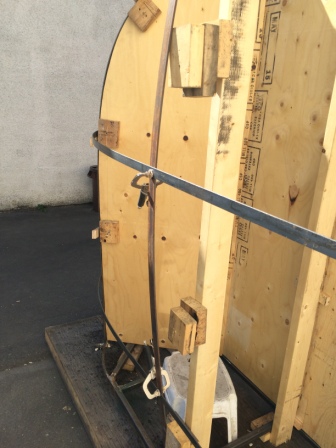

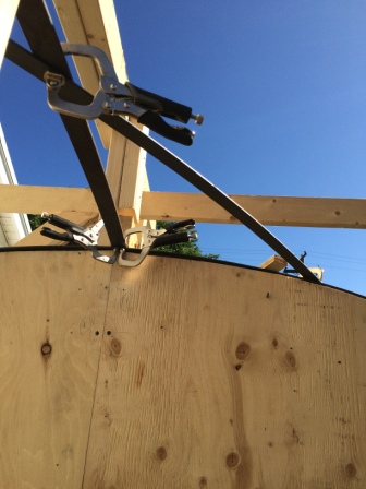

this seems to be the angle i will be working with up here
over the door.JPG (57.12 KiB) Viewed 1972 times
so far so good---that's the front/centre there

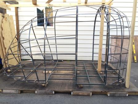

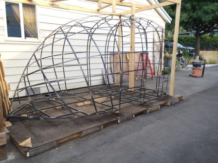

well my neighbour went out yesterday afternoon and the sun was low in the sky so i went gung-ho on the first front corner--- hopefully not a rush job.
cornering 1.JPG (82.8 KiB) Viewed 1911 times

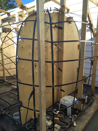

as did the rear end, the front is just sort of 'happening'--- at first i was all hung up on getting the curvature of the base to translate up the wall, but i have let go of that dream and now am letting the metal speak for itself. once the verticals are in place, the horizontals just snick right in----and with some minor adjusting to make sure the strappings are all touching at the intersections without being too pushy, clamp away !!
cornering 2.JPG (66.94 KiB) Viewed 1911 times
i lay on my back and looked up at how the curves lined up----all seems well
one of the horizontal bars up front will be removed to make room for a window, sometime soon....

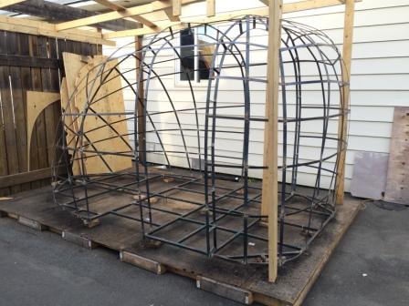

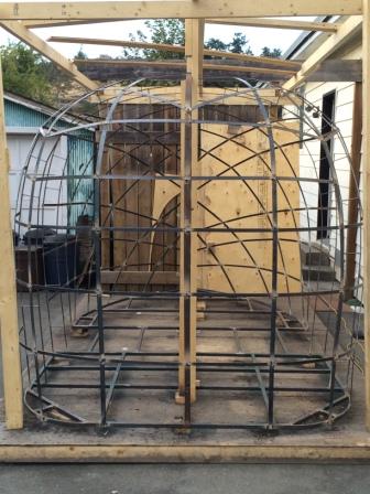

here's a front end comparison of thunderdome
full frontal.JPG (37.35 KiB) Viewed 1810 times
:beer:

Wow, awesome progress! Thunderdome is looking really good. :thumbsup: :applause: :applause:
