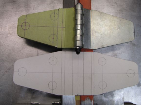

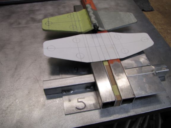

Luckily, at last i found some decent doorhinges. That was less easy than i expected.
Than i designed and made some brackets to mount the doorhinges to.

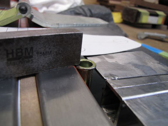

I found a kind of threaded bush system witch looks great to me. This way you can re-use the same threadhole bushes when needed.
Now to create it so i can mount the hinges flush to the outer teardroptrailer skin.
PICTURES!

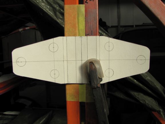

Ok, some foto's extra to see the perspective better.
The 1st. picture shows 2 brackets (the left one upside down) to show the situation.
the 2nd. picture shows how the end result should be.

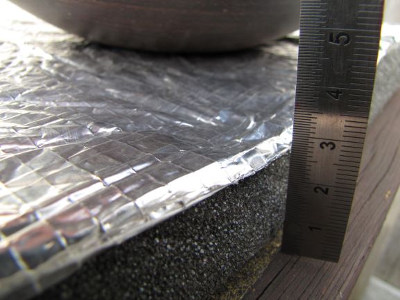

I had something a little different in mind.
It is a very old sample piece but you get the picture.
It is a type of foam with an aluminum foly sticked on it.
Apperently out of the automotive world, good bendable, also light, and 1 inch thick. Someone insulated his van with it.
But not sure of the isolation property's and the glue quality on the foam yet.

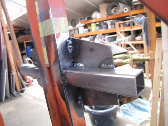

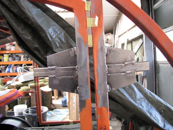

Postby smeerkees » Tue Apr 12, 2022 9:16 am

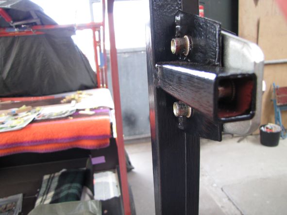

Here a little update.
Lately i have welded the hinge brackets on the frame.
PICTURES:
With enough dept for threatbushes to install, so i can mount the hinges flush to the aluminum skin.
And also a little space from the doors edge for mounting edge molding strips.
Greetz for now,
Smeerkees.

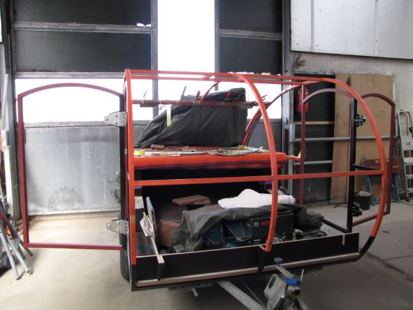

Postby smeerkees » Sun May 01, 2022 12:50 pm
Marcogs wrote:Very fu.....ing nice.
Good to see another Dutchie building a TD.
Do you have an idea of the total weight if finnished?
Gr. Marco (the dutch build)
Hello Marco,
I can give you an astimate of weight. In march of '21 i weighted the project on a truck scale.
At that moment the trailer weighted 380 kg. That included the spare wheel plus housingbracket and underfloor storingspace.
Since than i added storingspace hatch on the floor, doorframes, hatch frame, and the non structural wood parts inside.
At the moment my guess of weight would be around 450kg. The eventual weight would be somewhere around 550kg. (ish)
Goal is to stay in total under 750kg. So i can use the teardrop trailer with a "white licence plate".
In the Netherlands u can drive a small trailer including load under 750 kg. with a "white licenseplate". That means you can use a (white) licenseplate with the correspondent platenumber of the
pulling vehicle.
When u would haul sand, a total weight of 750 kg. is not much, however with a teardroptrailer (or small caravan) u (the driver of the car) are the "load" of the teardroptrailer and when driving u are in the car, and not in the trailer.
Ofcourse u can not acceed a certain maximum of total weight (car + trailer) but with normal sized car + small trailer u are way under that maximum (train) weight.
Ofcourse the max. loading rate of your axle, and braking system load must acceed the maximum (lawfull) weight +load of the teardroptrailer.
In my case that's not a problem at all.
But remember when you build a teardroptrailer weight add's up fast!
Greetz, smeerkees.

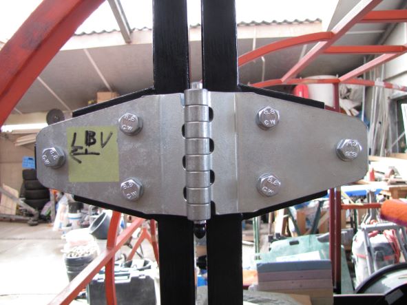

Postby smeerkees » Sun Sep 11, 2022 10:40 am
Hello everybody,
Wow that was some time ago since my last update.
Well, that was partially because of illness on my side,

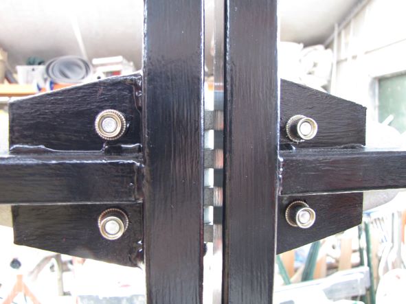

first a kidneystone that took some time and 3 weeks later i twisted a kneecap out of it's socket... :frightened:
Also took way more time to get the screwbushings (?) on the exact correct place. And by that i mean wayyyyy more time. :roll:
But at last succes, so here are some pictures to explain some more.
Con. side of this fastening methode, it takes a lot of time to get it right,
but the pro. side is when you do need to mount a new screwbushing you just drill the old one out, and "rivet" a new one in.
As i already had to do twice..
Ok, pictures!

Postby smeerkees » Sun Sep 11, 2022 11:05 am
For engineering purposes i used normal m8 bolts. hardness 8.8
but in the end i will swapp them for some nicer ones as in the pictures.
The nicer ones are also one hardness type higher. hardness 10.9
I have tried to get those nicer bolts in m8 the torx type + the higher hardness type 10.9 but no luck.
But this will do. I think the end result looks pretty nice.
