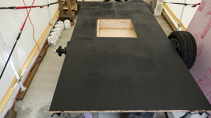

Postby RunnerDuck » Sun Mar 27, 2016 3:42 pm
OK, I know it's been a lot more days than 17 but this is my 17th day post.
While I haven't posted anything it doesn't mean I haven't been doing things with my TD. I keep refining my design and thinking about the build process which is a good thing. It always amazes me the things I come up with that I hadn't thought of before but hadn't incorporated yet which means fewer mistakes to correct later on :thinking:

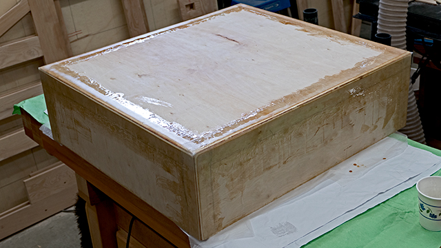

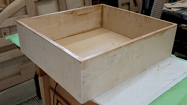

One thing I can show you is my "foot-well". I have a foot well designed into my TD so I can sit at a small desk and fiddle with my computer in the wee small hours of the morning.

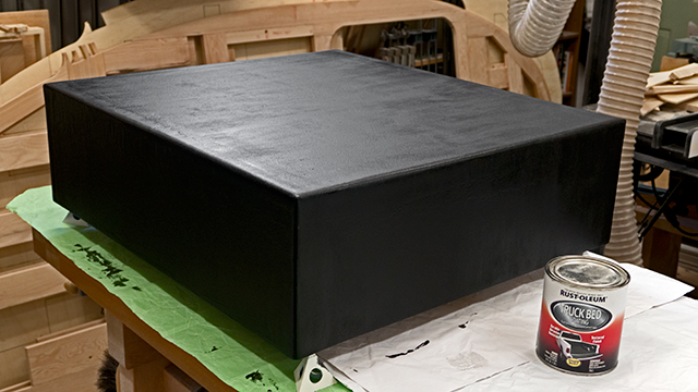

I made the box out of 3/4" plywood because it will be hanging down below the frame and I want it to be strong. I painted the top edges with epoxy resin and I covered all the outside edges with two layers of fiberglass and resin.
Once everything was dried I painted the exterior with bed liner paint.
Here are the results:
Next the floor!
Stay tuned!

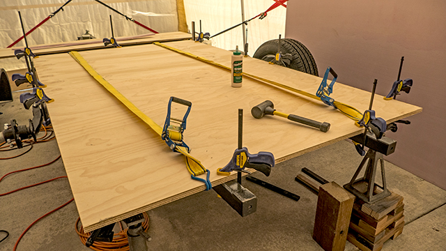

Postby RunnerDuck » Sun Mar 27, 2016 3:54 pm

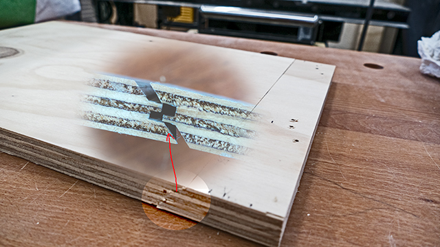

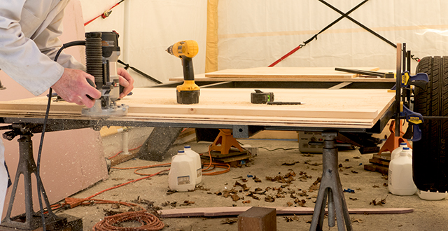

Today I built the floor. My frame is 5' X 10' so a sheet of plywood just won't fit. I cut down some 3/4" plywood and spliced it together.
I used my router with a 45 degree, Lock, Miter Bit. It provides a lot of surface to apply glue.
Here's an example of how it looks and how well the plywood fits together.
I made several passes along the edges as it's a 2" bit so slow and steady is the course.
To clamp them together I used strap clamps and squeeze clamps along the sides to keep it from buckling during the gluing and clamping process.
So far so good. I still have some smaller pieces to add to the length.
Next I'll seal the edges with a couple of coats of epoxy resin and coat the bottom with bed liner paint. Once I flip it over I'll put down the flooring which is a felt backed vinyl.
Stay tuned!

Postby Vedette » Sun Mar 27, 2016 4:20 pm
Great News Ken!
Floor looks Great!

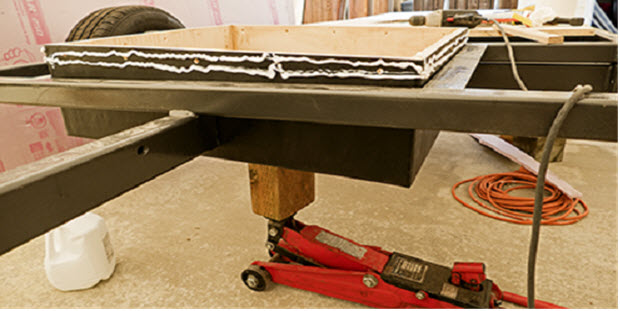

Postby RunnerDuck » Mon Apr 04, 2016 2:02 pm

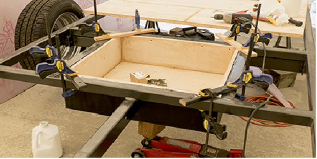

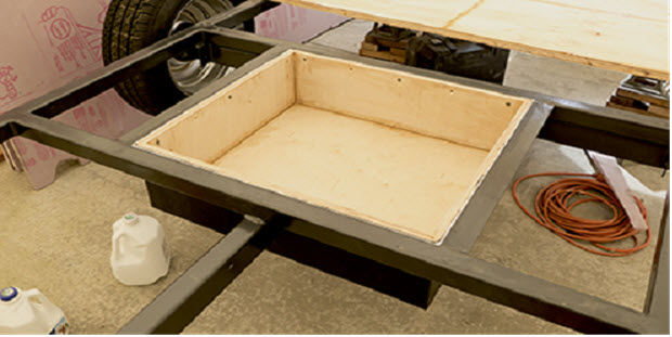

Making progress again. Today (three days later) I installed my footwell!
Despite suggestions on leaving it out until I'm done with the interior so I'd have a nice place to stand I went ahead. Because of the way I have my footwell is cut it was just easier to do it without the floor on.
I'll use the footwell for my feet when I sit sideways at the desk I'm going to have. You'll see that come together in a few months or sooner I hope.
Meanwhile here's how I installed my footwell.
I lowered it onto a jack stand and got it within a few inches of being in place. Then I applied silicone all the way around.
footwell install 2.jpg (50.69 KiB) Viewed 2659 times
I put cauls on all four corners to hold it flush to the top of the frame. I jacked it up until it was snug.
footwell install 3.jpg (52.43 KiB) Viewed 2659 times
I inserted the screws and smoothed out the silicone and I'm good to go!
footwell install 4.jpg (46.13 KiB) Viewed 2659 times
Onward to installing the floor.

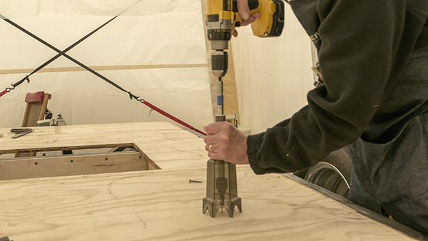

I'm making good steady progress. I now have the floor glued and screwed to the frame. I used countersunk self drilling/taping screws. To get the countersink to the correct depth I dug out my really, really, old Black and Decker Drill Guide. It's kind of a lot to handle and sort of wobbly but by golly it worked.
I marked the shaft with a piece of tape to set the depth, held it flat to the floor and drilled away.
Drill hole.jpg (169.61 KiB) Viewed 2852 times
I pre-drilled the holes in the frame and then installed the screws. It worked perfectly and I now have a solid floor.

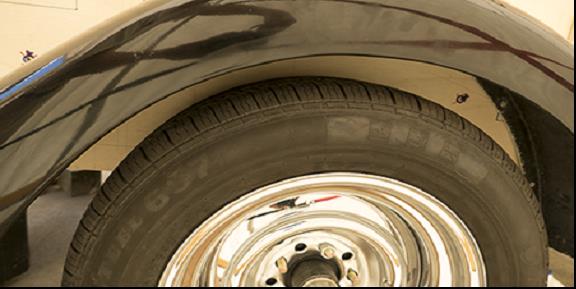

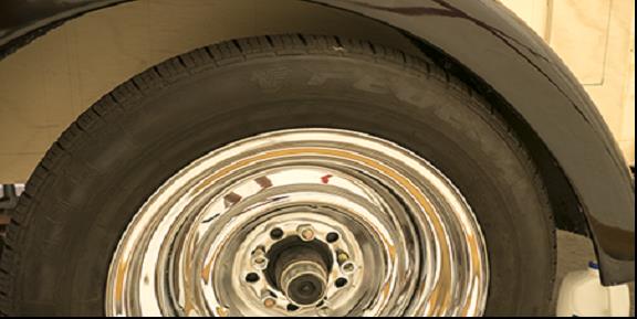

I mounted a fender and wheel to check the alignment and damn, it was not good.
I made an adjustment by moving the "T-nuts" for the fender 3" forward. Ahhhhh, much better.
