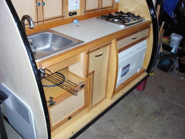

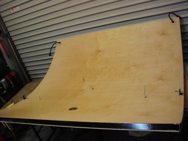

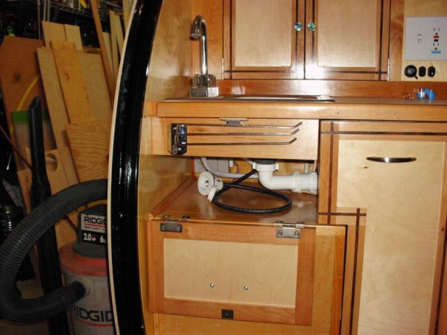

Here's the under side of the galley with the birch glued on and a few coats of poly.
I'm getting closer. :D

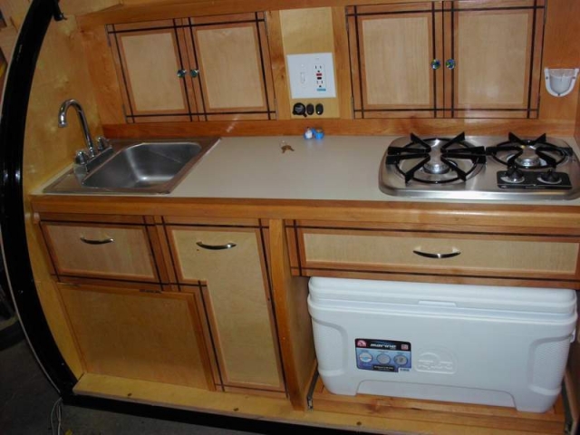

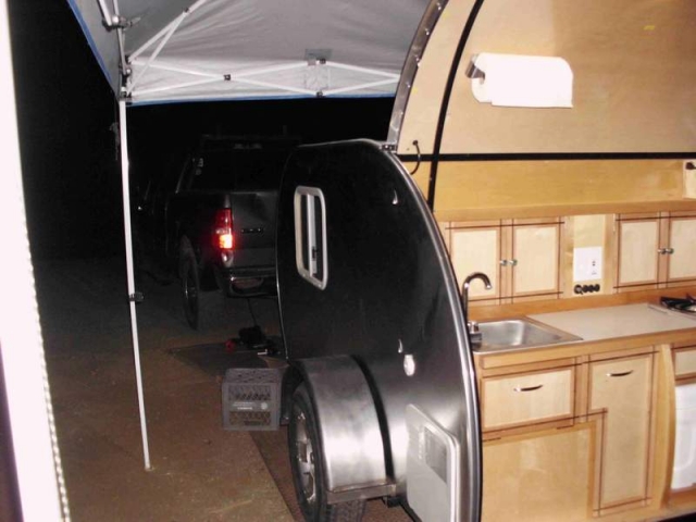

Postby ELM » Tue Jul 19, 2016 11:31 pm
Here's an update. I got the hatch back on and it still fit good but I needed to in large the holes where my latch rods go into the side of the frame. I need to take a picture of the hatch installed.

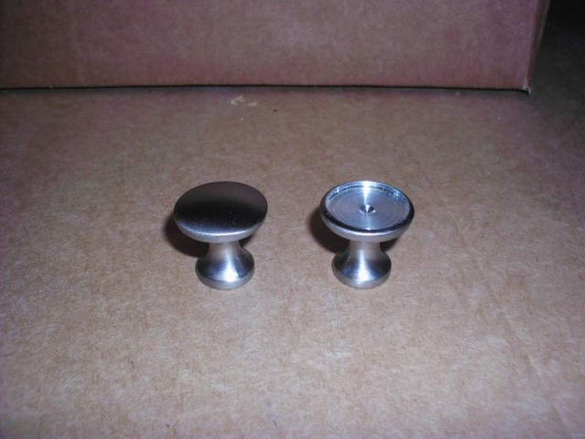

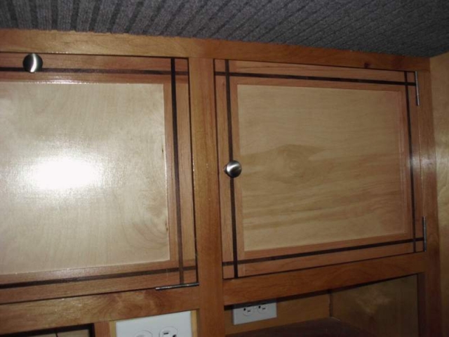

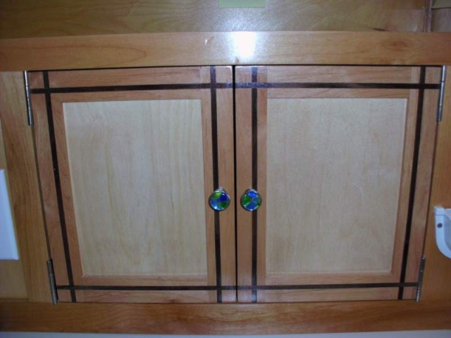

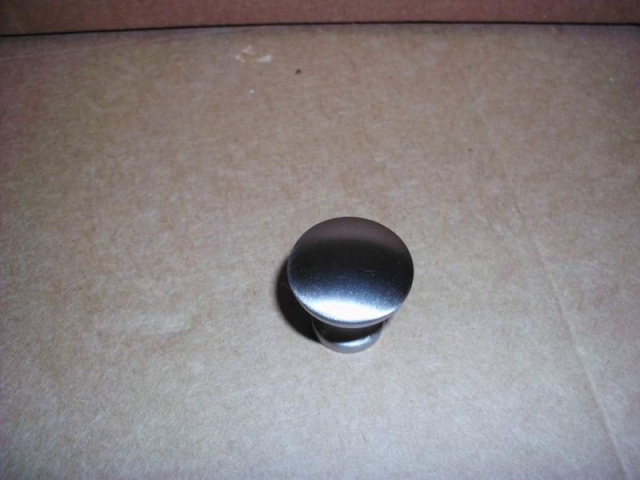

I found some knobs I like for the most part.

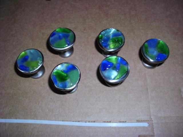

I decided to jazz up the knobs a little. First I machined a dash in them.
And then I epoxied some glass we found at Glass Beach in Fort Bragg CA about a year ago.
Next I finally found a place to put my towel hanger that found about six years ago and thought it would be nice for a Tear Drop trailer that thought I would like to build some day. :D
And the towel hanger opened up.
And then closed up. I think the Galley is very close to being done. :) I think the only things left to do is install the Galley lights and a handle for the ice chest tray.

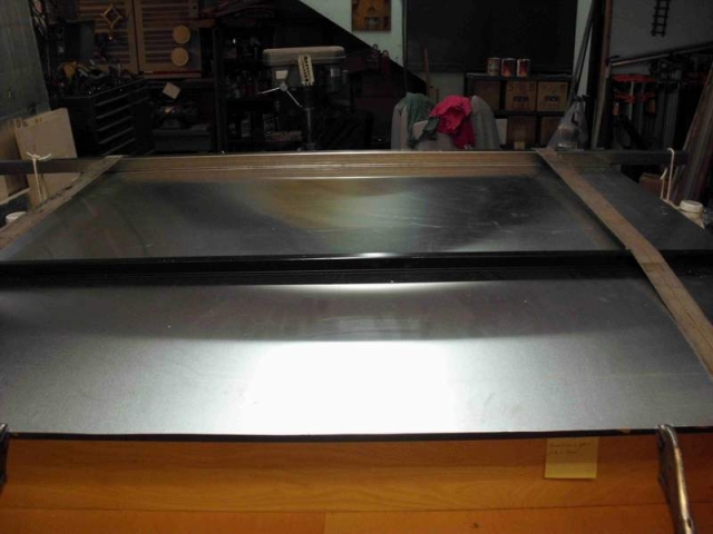

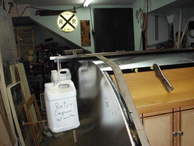

I picked up the Aluminum yesterday 103" x 25' x .040 and I started cutting it today. Man that's a big piece of Aluminum to deal with. :o

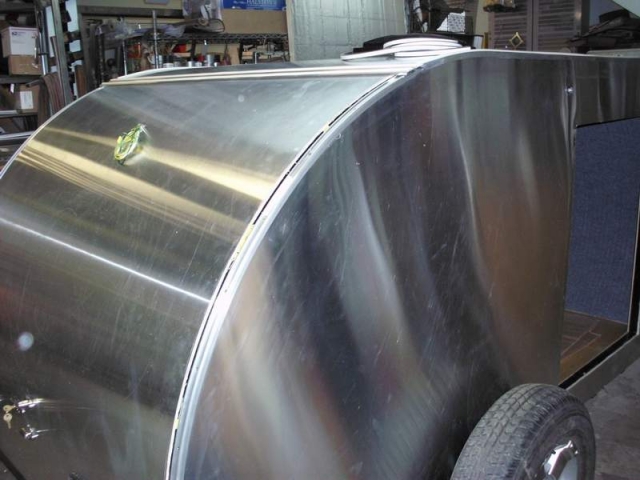

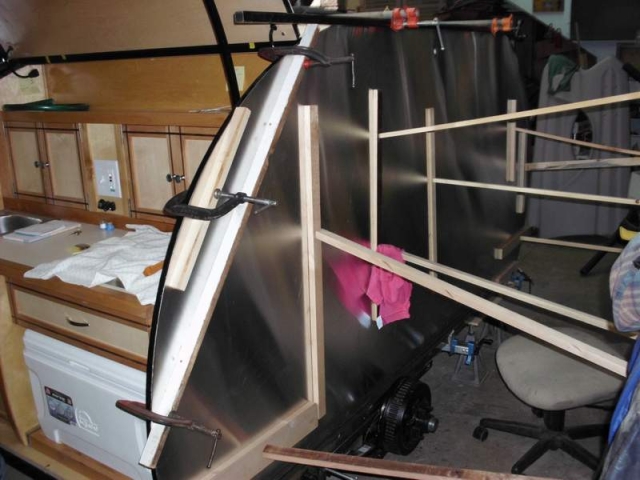

Postby ELM » Tue Jul 26, 2016 3:26 pm

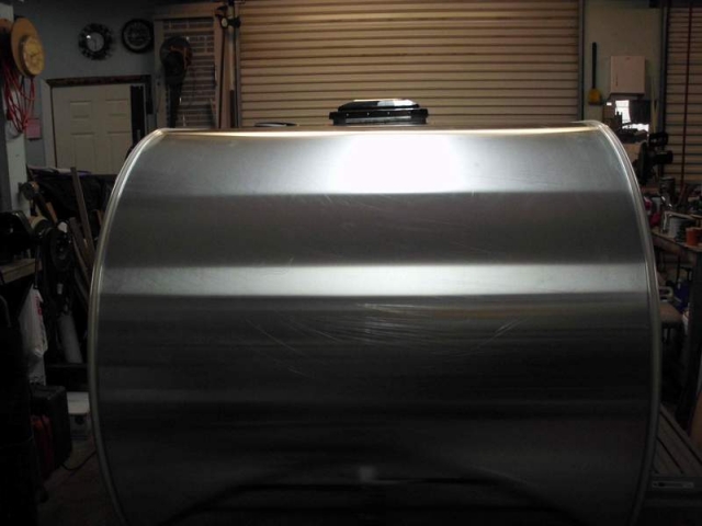

All of the aluminum skin is on the tear drop. :D Image.
I've got the hatch hinge on and the hatch on the trailer for good this time. Image
I've started putting on the aluminum corner moldings.

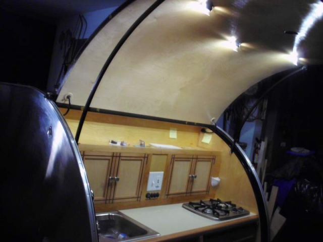

Postby ELM » Thu Jul 28, 2016 2:17 pm
I have all of the aluminum trim on except for the hatch trim. It should be here next week.

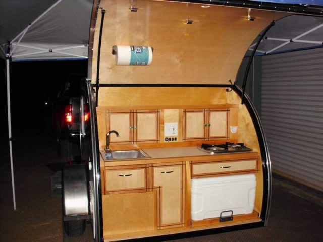

Hatch lights installed and working. I used three led license plate lights.
I'm working on the running lights and brake wiring now.

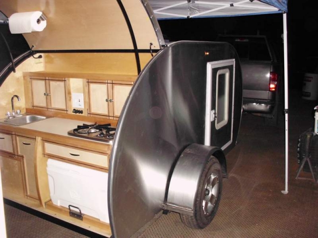

Postby ELM » Thu Aug 11, 2016 12:09 am
I've been busy working on the aluminum trim and a lot of little things that needed finished up.
Here's a picture of the galley all finished up. :D ( I think )
In this picture I have the left fender on but I still need to do something with the outer lower edge. :thinking:
The right side fender is on and the door that took me a day and a half to shrink down from a full size door and screen door.
I built a new center core with aluminum on the outside and Baltic Burch on the inside. It turned out very good but a lot of work. But I work cheap. ;)
