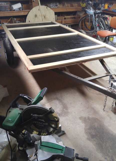

I got a little more done tonight--cut out the pieces for the deck's frame.
They're not screwed together yet, and, obviously, I need to turn the subfloor over so the tar faces the road, but I laid the pieces out temporarily just to make sure they fit. And check it out: they're. SO. RECTANGULAR!
I wish I could just do more of this tomorrow, but, sadly, I have to go to stoopid work. So unfair.

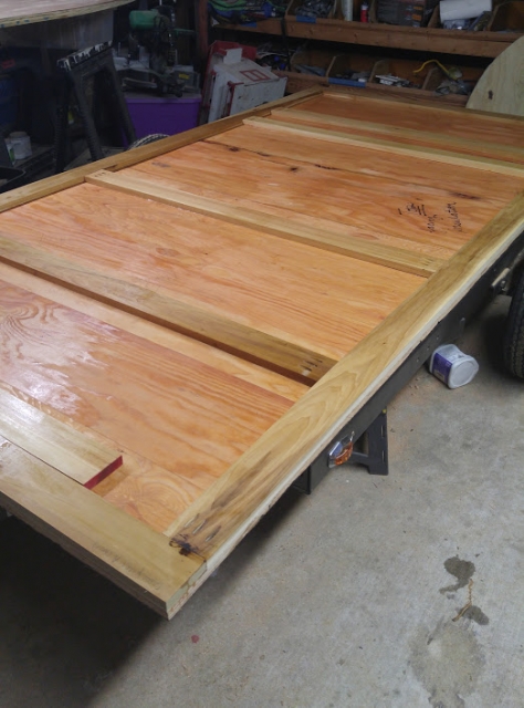

Deck frame assembled without incident!
Well, I spilled my iced tea on the deck, but other than that--smooth sailing.
I did a dry fit of the frame, unwillingly, but with the dutiful sense that it was the right thing to do. Which it was--allowed me to see that slight warping meant that some crosspieces weren't perfectly flush where they met the outside pieces. So when I did the permanent gluing + screwing (which sounds dirty, but also like a bad idea), I was able to more or less fix those alignment issues and make everything nice and flat.
There are a couple of extra pieces in there based on Nobes's recommendation that I provide support where bulkheads will attach. The main pieces are spaced to lie under where the seams in the floor will meet.

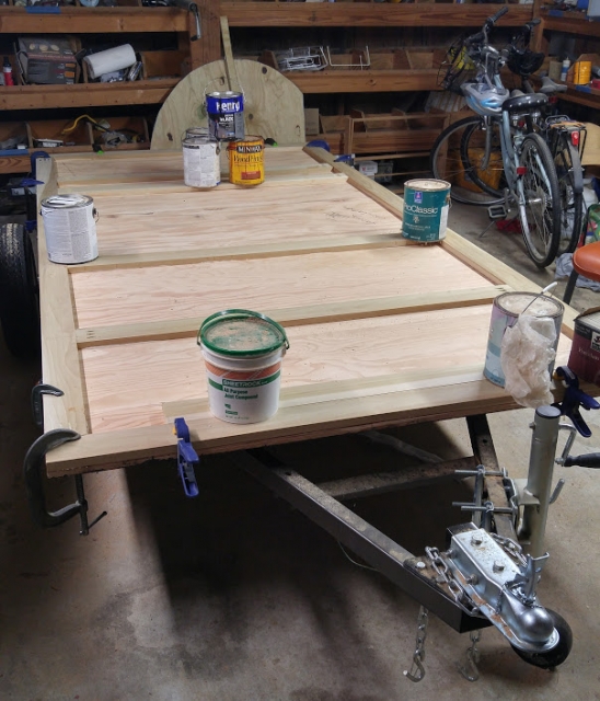

I'm on a roll, so I applied The Mix tonight--a fairly generous coating of 2/3 polyurethane to 1/3 mineral spirits.
Tomorrow I'll try sprinkling some water on the deck to see if it beads up or sinks in. If the latter, more Mix. If the former, time for insulation!

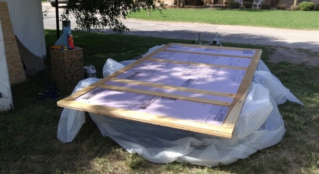

We insulated and topped with 1/4" plywood, and now: we have a floor!
For the insulation step, I used some epoxy from Home Depot to stick the foam to the floor--it came in 8-oz kits, and I bought 2. Three or 4 would actually have been a better choice, but it isn't like the insulation panels are going anywhere, so I'm not going to lose sleep over it.
The foam panels are slightly thinner than the 1 x 4s, so I had the bright idea of using Puff-e-foam to fill in that shallow cavity above the insulation. I was thinking the challenge would be to weigh down the 1/4" plywood so that it didn't bow up as the Puff-e-foam expanded. I had WAY overestimated the power of the Puff-e-foam. It turns out, 1 can contains a pretty minuscule amount of foam--not nearly enough to form a solid layer across the surface of 1/3 of the trailer. So we used it around all the edges and filled in the center with whatever was left. Flexing upwards from the inexorable force of expanding foam was SO not an issue.
I had only bought 1 can (again, totally overestimating the awesomeness of the Puff-e-foam), but fortunately, Mr P had a couple of spare unopened cans kicking around the garage. We used all 3 completely, and still didn't achieve a solid foam layer.
But we topped with the plywood and weighted it down, so hopefully the foam dispersed horizontally under the weight to provide a little extra support for the floor, which was my main goal.
We fastened with PL Premium (I'd bought 2 tubes--also not really enough--there is a theme here) and reinforced with a brad gun.

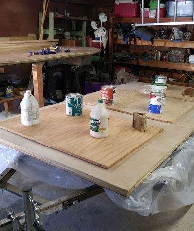

The workstation--note the plastic swathing--I was just sure that foam would be oozing and squirting and exploding all over the place, which is also why we worked outside. Eh, well.
The finished product, curing. Next step will be to coat with The Mix and screw to the trailer.
