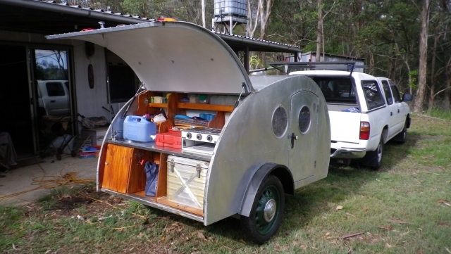

Its been a STRUGGLE to get the teardrop to the stage where Nicole can use the tear to go to the Woodford Folk festival and camp in it but she has just driven off, admittedly she is a bit nervous having never towed a trailer of any sort before but she assured me that she would be going slowly and taking it very easy. Of course there are many things that still need to be done, for instance I have not hooked up power to the TV or the stereo, The stove needed a longer hose to the gas bottle so Nicole will be using her single burner stove although I did hook up all if the interior lights and the extractor fan and the all important solar panel.
As it turns out my hatch skin is entirely screwed on rather than being riveted because of time constraints and the struts that I have are not Up to holding it up so I have Jerry rigged a prop made out of a golf club with its head cut off but those are things I shall fix after Nicole brings it back home in a weeks time

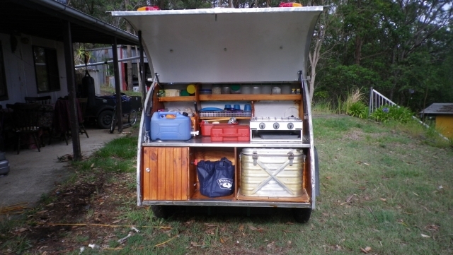

I do wish that I could have got everything sorted but after working all day Christmas eve and most of Christmas day there really was just no time to do everything even so My galley looks pretty good even if the water and gas are not hooked up!
If you look closely you can see the there round LED panels that provide my Galley lighting they will eventually be put under the same sort of Glass and chrome fittings I used inside but that needs rubbers that I have to order from the UK

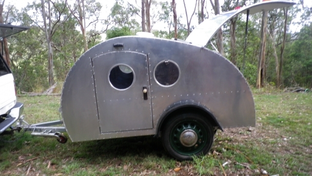

I have one external light above the LHS door

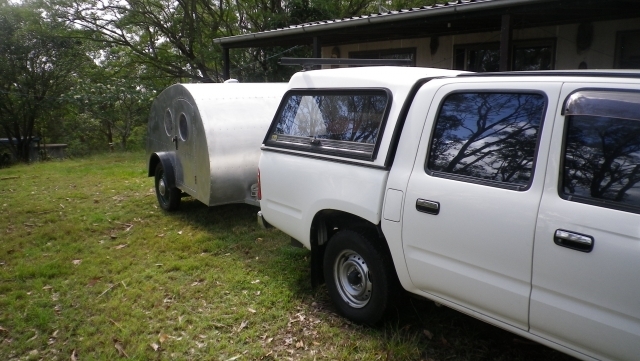

My teardrop fits very nicely in the shadow of our Pickup and I'm guessing that we won't even notice that its there most of the time

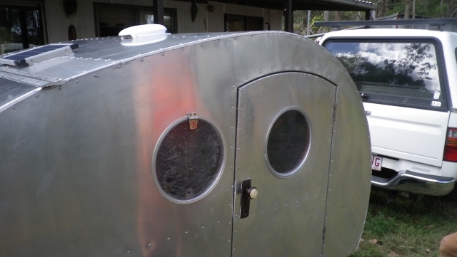

This window pane is a nice snug fit bit I made the other one just a touch too small and I will be replacing it with another one that I will cut today
