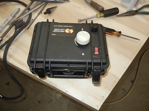

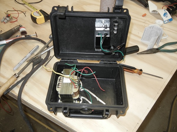

Now during the time I was waiting for the epoxy to set. I went to putting together the parts I had been waiting on to redo my power supply.
In this pic I had already installed the power switch, fuse holder, dimmer switch.
In this pic it shows the inside layout. By the time I knocked off I had all the wiring done inside the box. I just need to pickup some AGC 5 glass fuses then I can power it up to find the wires I need to use for power out to the cutter.

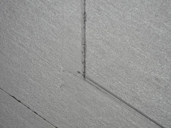

On the foam I did today. Here is a hint I have not seen posted on here in any builds. I could have taken a lot of time and tried to measure out all the angles and stuff. A faster way I have used many times in making gaskets in automotive works. I layed the foam on top of the wall section. Then I took a board and layed on top of the foam. I took a large rubber hammer and hit the board around all framing inside the wall. That compressed the foam only on the wall framing. Here is a pic.
Then I used a T-square to mark cut lines on the foam. Seeing as how I was only cutting 3/4". I just used a box cuter. Total time for cutting out the foam on that wall was about 30 minutes.

You need to maintain a steady speed threw the cut. If you slow down it will leave a divot. If you look at the foam in the pic any dark lines in it was a slow down point.
A good power supply helps. My charger only supplied 12 volts with maybe one amp. There wasn't enough resistance to fully turn on my charger. It was only giving me voltage and no amperage. So it was slow cutting. My power supply that died was giving me three amp's.
Rig a spring up on the cutter wire to hold tension. I didn't on that adjustable setup I made. NI-chrome wires stretches a lot when hot even at the low amp's I was feeding it. With the wire tight at the start of the cut. By the end of a cut the center of the wire was about 2" behind in the center of the span. A larger power source would have helped there. If I slowed down to keep the wire straight it caused divots on the outer edges.
It was a flush cut with top of wood. On the alumin ears I added to the clamp. I put a notch just deep enough in the rounded corner to just hold the wire in position. I'll get a better pic of the working end tomorrow. I wasn't quite done with it when I took that one.
Thanks for the tips and I let me think of it a second here. What is needed is more power or heat to be produced in the wire. I do not know which diameter your Ni-Cr wire is, but with the same voltage for the same length and diameter, the steel MIG wire has less resistance Ω so it will be hotter vs. Ni-Cr, so the cut could be quicker.
My hunch here is really the cutting temperature required for XPS is quite low while Ni-Cr wire is usually used with higher temperatures. Steel would be stable and durable for a long time for this kind of cut. The mig steel wire I was using was slighly turning dark, and was never needed to be glowing hot. It is not my idea, I just copied it, the credit of the tip for using the mig wire and manual charger belongs to this forum member ghcoe, who documented quite well how he used charger and mig wire for his foamie #1 build (http://www.tnttt.com/viewtopic.php?t=54099) . Cheers, you are doing a very nice work on your trailer!

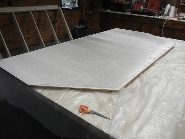

Postby Philip » Fri Nov 25, 2016 6:29 pm

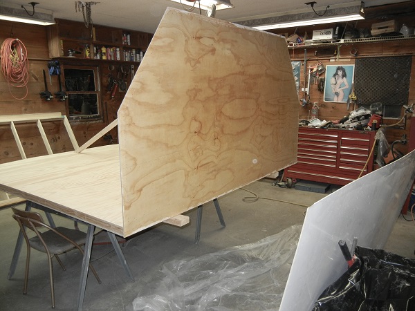

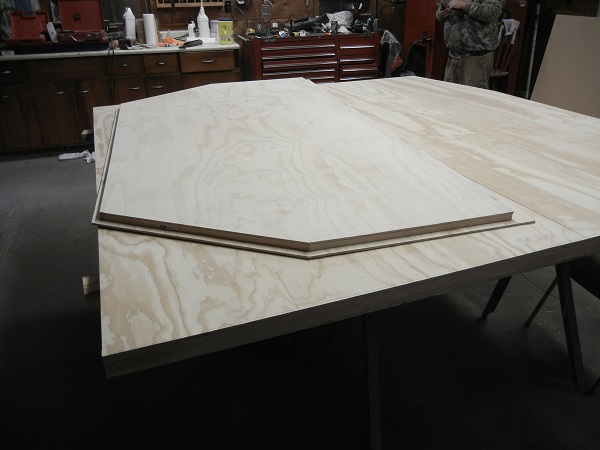

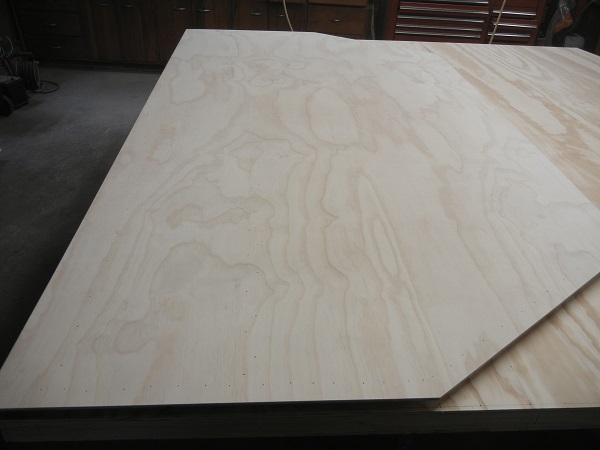

Yesterday I installed the inner ply on the wall. This morning I routed off the excess ply.
I flipped the wall over and sanded it with a D/A and 180 grit paper to remove layout lines and so on.
I then used a tack cloth to remove all sanding dust. I layed out glass and cut to rough size and epoxied it down.
Tomorrow I am going to sand it down with the D/A and put another coat of resin on it.

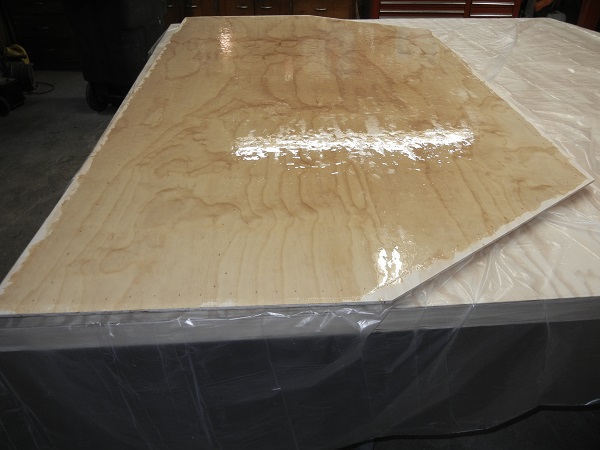

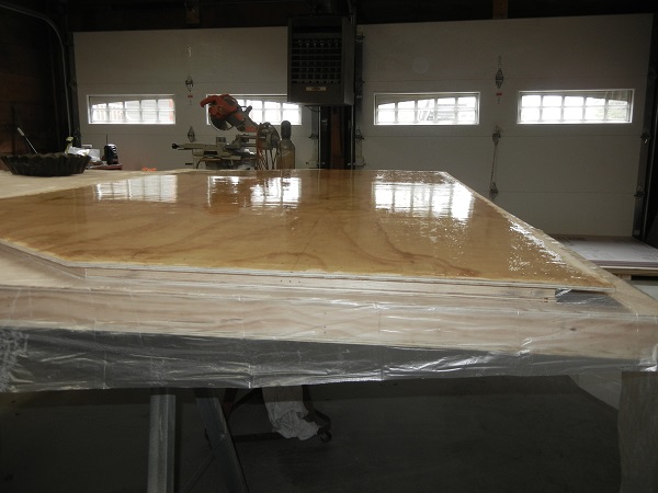

This morning I sanded off the panel with 180 sand paper. Then the second coat of epoxy went on.
On this coat I tried a trick of using a putty knife to spread the epoxy. I found a couple of videos on U tube showing that. On a first layup I didn't have much luck with a putty knife. It would move the glass around to much with the thick epoxy I am using. So I used a paint brush on the first layup. For a second layup on a flat panel the knife worked good. I used a 8" drywall knife I had laying around.
BTW I could have skipped the second coat if I had wanted to. After sand out the small areas I had to retouch I could have skipped and used automotive spot putty to fill them with on final finish work.

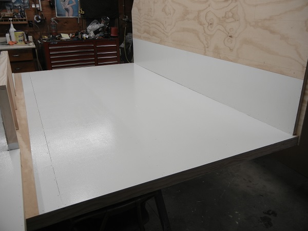

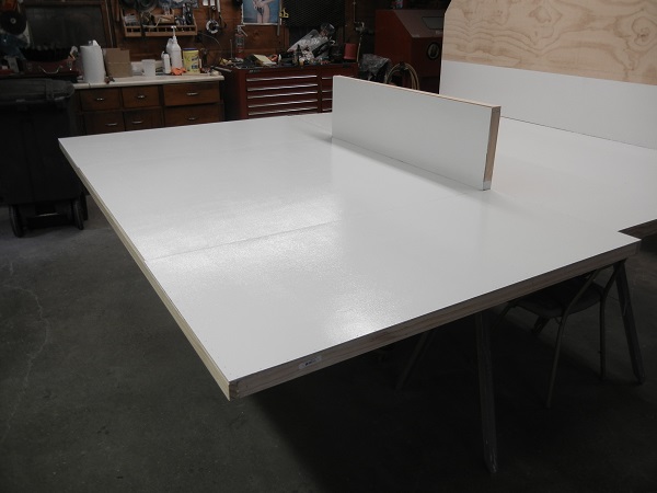

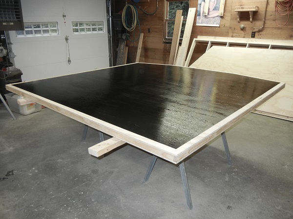

Postby Philip » Mon Nov 28, 2016 2:23 pm
Yesterday I flipped the base over to paint the bottom side. It was do that or paint it on a creeper. :lol:
Today I put down two coats of oil base paint.
Now I have to wait till it drys good. Then flip it over and install the wall I have finished.
Now for the members wondering why I didn't paint all the way to the edge. I will be running glass over the corners to the bottom when I do the wall installs. I don't want to glass over paint. I'll just spray the over run areas when I paint the outside of the camper.

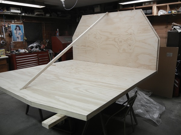

Postby Philip » Thu Dec 01, 2016 7:00 pm
The last couple of days I have been doing other work around the house. Last night I got the base unit flipped over. Today I installed a cleat to mount the wall against. I then installed the wall when help showed up.

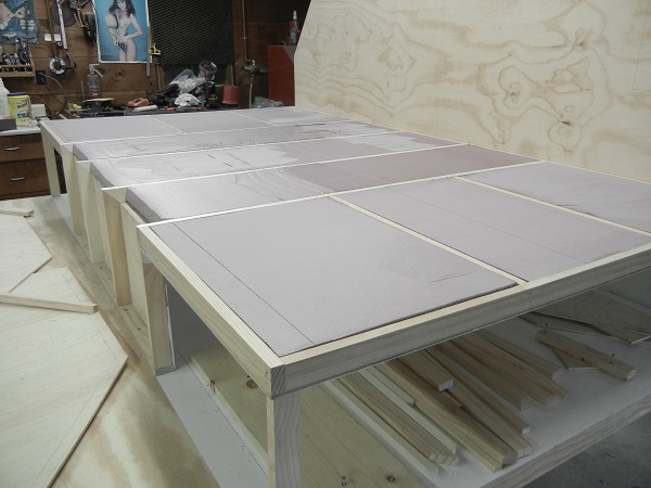

I figured I better get back in here and throw out a update.

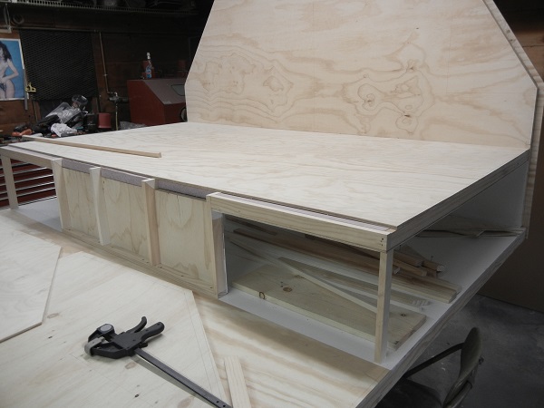

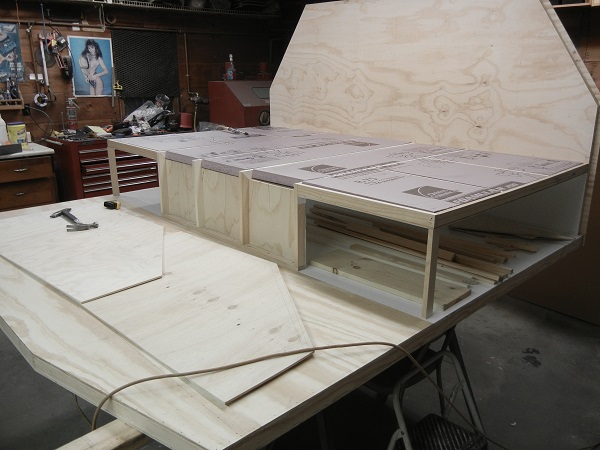

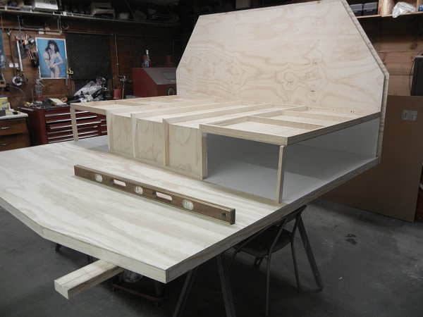

Started building the raised platform for the bed. I them painted the bottom side and the area it will cover on the frame work. Sorry I didn't get any pic's before the paint work.
Today I flipped the frame over and installed it. BTW Those props you see under the ends of the platform will be removed after the lower outer wall is installed. The frame will attach to it.
After I got that installed I moved onto installing the insulation into the frame.
Tomorrow I'll get the foam sanded flat and throw the top decking on.
If you look close in that last pic you can see the outside wall sections for the rear of the camper. I spent a while on those trying to figure out the angle for the outside center sections. The rear end walls do not have the same angle as the front wall. With the clipped corners the camper needed to match the flatbed. Those 11 degree angles threw off the center angle.

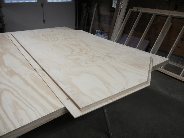

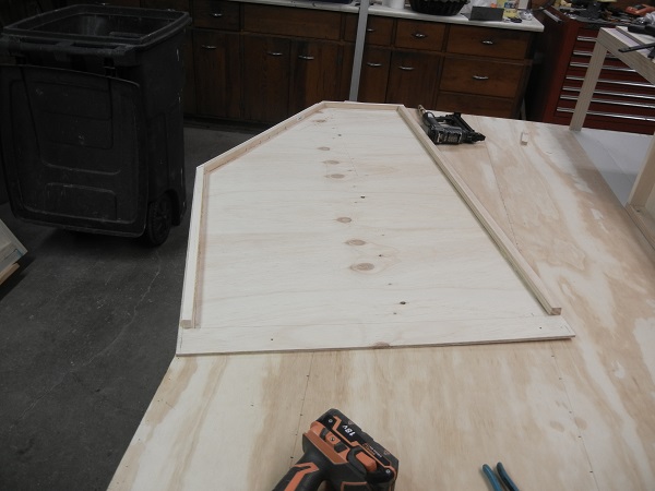

Today the first thing to do was skin off the excess from the foam.
I then threw a sheet of 3/8"s ply on the deck and nailed it down.
After that I moved onto the passenger side rear wall and started doing the frame work inside the wall.
I still need to frame a door opening into it before the inner ply goes on.
