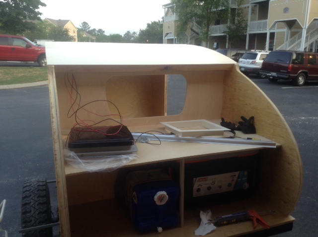

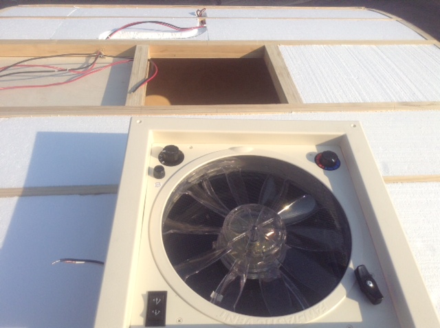

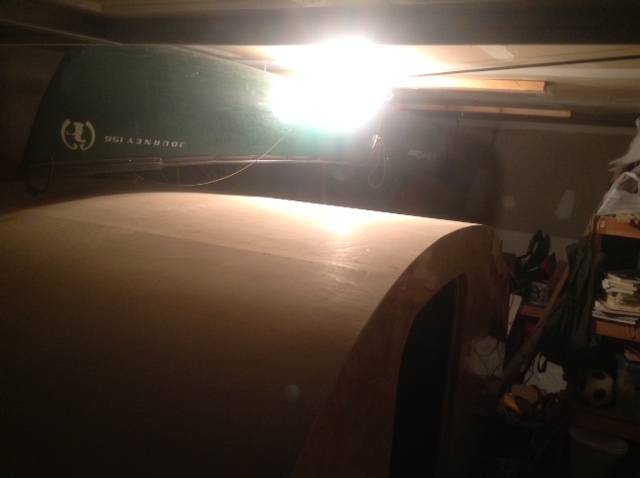

Installed the second sheet of plywood on the roof after finishing the wiring for the cabin light and fan. Also started on the tongue box this week. It'll hold the group 27 battery, charge controller, battery disconnect, portable solar panel, and Weber Smokey Joe with a bag of charcoal. Can't imagine camping without it, and couldn't find any other place to store it. No pics yet.
I almost made a critical error by forgetting to mark the wiring location before installing the plywood. :frightened: Checked for a short between the wires with an ohm meter after realizing my mistake. Thankfully none of the staples hit the wires where they pass thru the spars. :)
In other news, the hurricane hitch, tail lights, fuse block, and disconnect have arrived. Ordered the battery, and awaiting delivery. Group 27 may be a bit too large, but better to have and not need than to need and not have. Only a bit more expensive and a little bit larger and heavier.
Fan
Roof 2
Sorry about the dark pics. It was late when I finished.
Roof 1

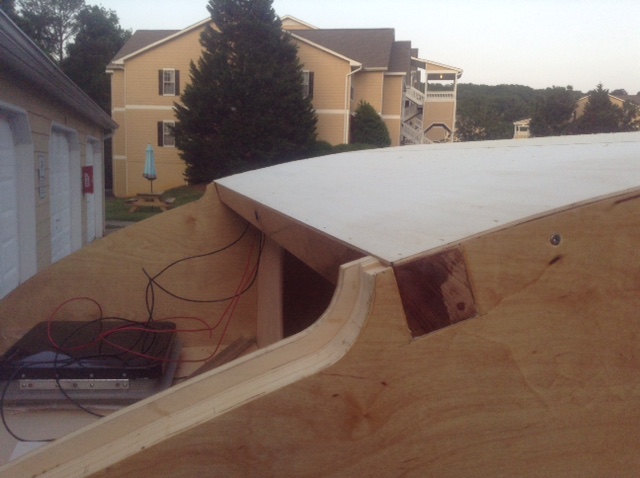

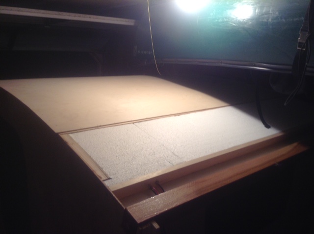

Postby kokomoto » Thu May 11, 2017 7:58 pm
Installed the final sheet of plywood on the roof along with the hatch spar tonight. :D
Roof 1
Roof 2

Tonight I tried to get a new pattern cut for the doors. I made a huge mistake by not following Steve's manual closely. When I cut the door openings in the walls. I didn't cut it carefully so as to have a nice pattern to use on the doors. They are both slightly different as a result. Soooooo, now I have to painstakingly mark and cut a tight fitting pattern for each door. :NC lesson learned. Read the dog gone manual, and follow it.
The hurricane hinge arrived. It looks like Iike it needs a 1/4" gap between the spar and the top edge of the hatch. I cut mine my walls with a 3/8" gap. A minor setback, but one that needs to be addressed. I just need to fix it without messing up the hatch fit at the seal. It's probably going to need a modification to the hatch outer sides.

Postby KCStudly » Tue May 16, 2017 6:52 am
Can you just laminate a 1/8 thick shim to the face of the hatch hinge spar and avoid changing gasket profile of the hatch?
Re: Off-road Teardrop Design/Build
Postby kokomoto » Tue May 16, 2017 8:26 am
KCStudly wrote:Can you just laminate a 1/8 thick shim to the face of the hatch hinge spar and avoid changing gasket profile of the hatch?
A brilliant idea! :thinking: That sounds like it just might work. I'll look into it. Thanks a million.
Just wondering....the hatch spar is already epoxied with RAKA. I presume sanding the spar a bit and using something like PL Premium will work for getting a good bond between the shim and spar.
kokomoto
Posts: 244
Joined: Tue Oct 18, 2016 3:18 pm
Location: SE Tennessee
Postby KCStudly » Tue May 16, 2017 11:45 am
kokomoto wrote:....the hatch spar is already epoxied with RAKA. I presume sanding the spar a bit and using something like PL Premium will work for getting a good bond between the shim and spar.
Yes to scuffing it up, but Why not just use more epoxy?
Do the screws go thru the face of the spar or in from the top? If through the face, the shim will be clamped by the screws in the end anyway, so I guess it isn't that critical.
