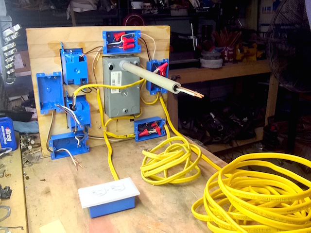

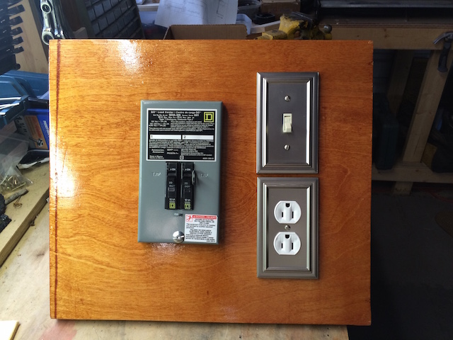

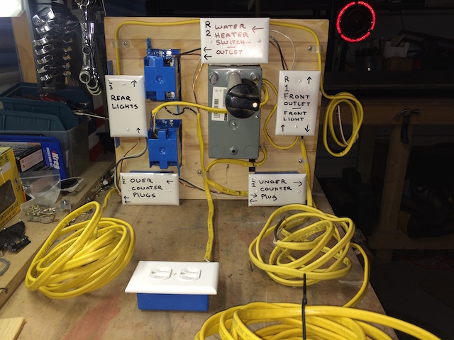

Two junction boxes with circuit runs left to go and I'll be ready to install the main panel under the bed, the face will be facing out. On the front, the switch toggles power to the outlet under the bed that the water heater plugs into and the outlet is just an outlet

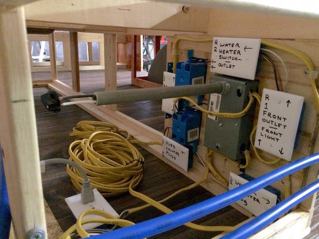

Wow that was more than I expected it to be but the load center is 100% done and all my long runs are measured and cut and tucked under the bed ready to go for when I get the ceiling in. With only two circuits there are a number of junction boxes but I labelled then right on the covers for easy reference. I did a 3 way light switch for the rear lights so I can turn them on when I walk in the door and turn them off when I am in bed which is cool and the only thing left is to fully enclose the entire panel back in a big box.

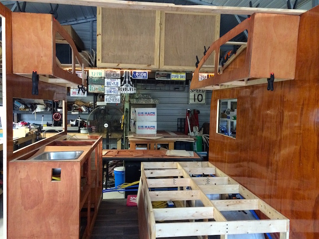

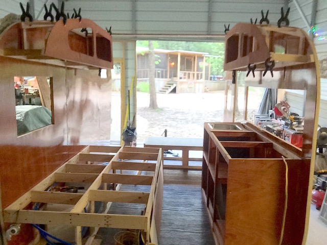

Back to carpentry! the upper cabinets are built, just need to glue the face frames, then stain the inside and poly the outside and hang from the walls for real! I have been imagining this for a long time so it is really cool seeing them clamped up there for the first time.
