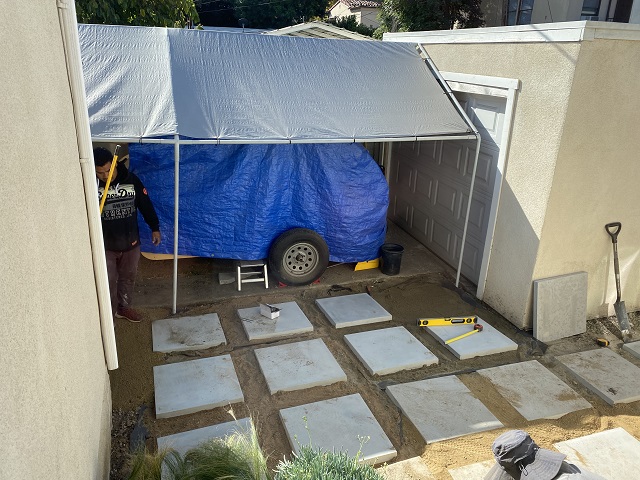

It's gonna get tougher in the next few months too. We decided to put our house on the market and I have to finish the landscaping!
Finally finished this fence...
163299 163300

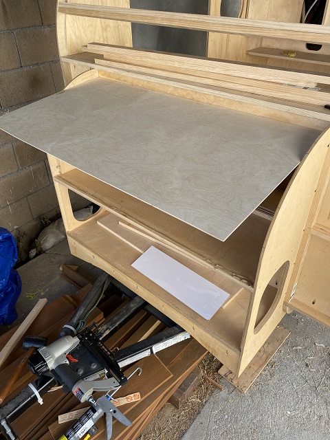

This is a bit of a milestone: got the headliner for the storage box installed.
I figured I would start here to get the hang of it, before moving on to the main roof.
It wasn't too difficult to bend the 1/8" ply to this 12" radius. But I imagine that it will be much more difficult to do the 6" radius bends at the bottom!
I might try soaking those before attempting the bend.

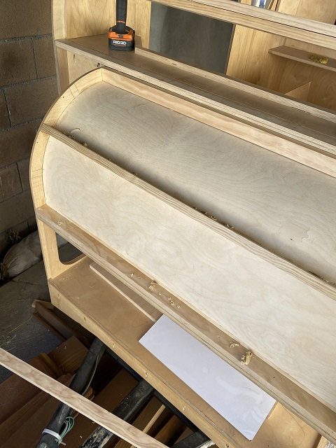

Postby eLink » Mon Oct 19, 2020 5:00 pm
Got the headliner in today. But there were lots of lessons learned.
It was supposed to be easy... front edge fits into slot, add a bead of glue to the wall ledge and staple from front to rear. The rear edge then gets glued and stapled to ledger.
163516 163517
I think my biggest mistake was not having a helper. Once the glue was on I switched into panic mode and several things happened:
Missed on my first staple.
163522
Forgot to check the staple depth setting. I think many of them went right through!
163518
Had a really hard time getting the rear edge to stay down. Got a few more shiners in the process (thankfully this area will get hidden though).
163521

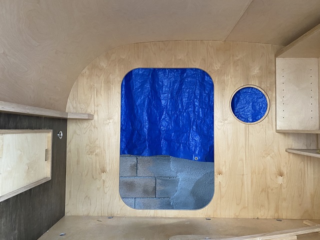

The ceiling kept popping off the ledge, probably allowing the glue to prematurely set up before I could staple it down. Hence the gap. Not the tight joint I was hoping for! Guess I will be caulking that joint after all.
163520
Splintering from the staples popping and being pushed back in.
163519
Big sigh. :(

I took Tony's advice and did my best to squeeze some PL Premium into the gap. It definitely mitigated the squishy joint!
I will go back over all the joints with some wood colored caulk. If that doesn't look right, I'll go with thin wood trim as Noseoil suggested.

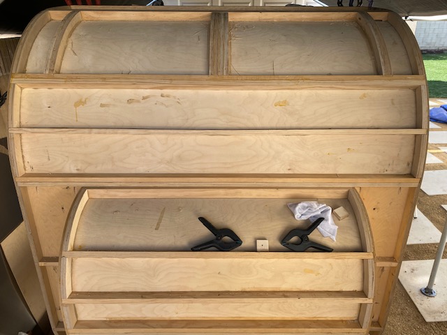

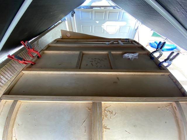

Update: I got the roof framing just about completed this weekend.
I see why a lot of people go on to build more than one camper. That way they can apply everything they learned from the first one!

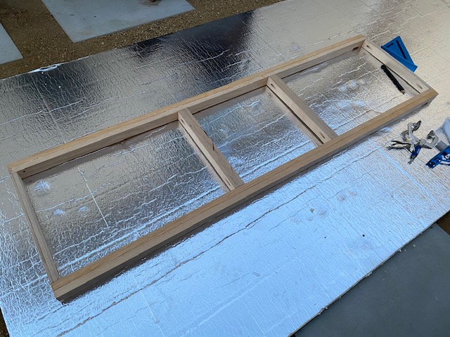

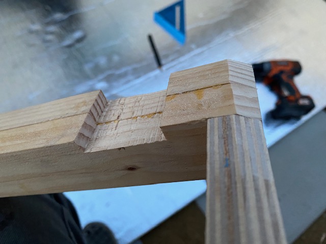

The skylight framing turned out ok, but I found that gluing the pieces "in-place" did not go so smooth. I couldn't seem to clamp things right, so there was a little bit of shifting and misalignment.
So then I decided to build the vent frame assembly separately. This worked out so much better! Everything nice and square!
Blocking along the sidewalls seemed to be sitting proud of the roof profile. Probably because of the staples and glue along the wall ledge. At first I just figured I would just have to follow up with a belt sander. But then I realized that all I need to do is give the blocking and spars a slight bevel along the bottom edge. Makes it fit tight to the wall and flush to the roof line!

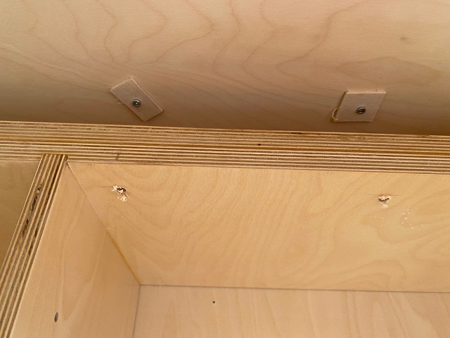

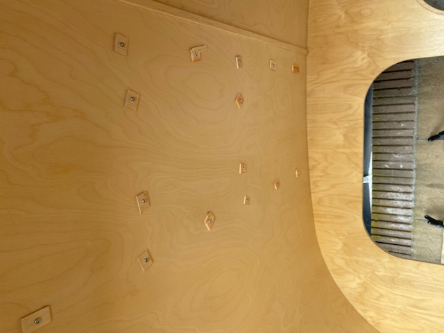

I wasn't feeling comfortable with crown staples for the headliner, so I opted to use 1" Kreg screws to join it with the spars. I will remove them once the glue has cured. Screws alone will dimple the plywood, as I had discovered for the first few spars. Even with the drill set to the lowest torque setting. So I used little pieces of 1/8" ply to prevent that.
Here is my other moment of panic. See what I had to do there?
Lastly, I won't use single 1x spars again. I used "select" pine, but the few that I used still sagged and warped. The doubled-up spars stayed straight and worked well.
