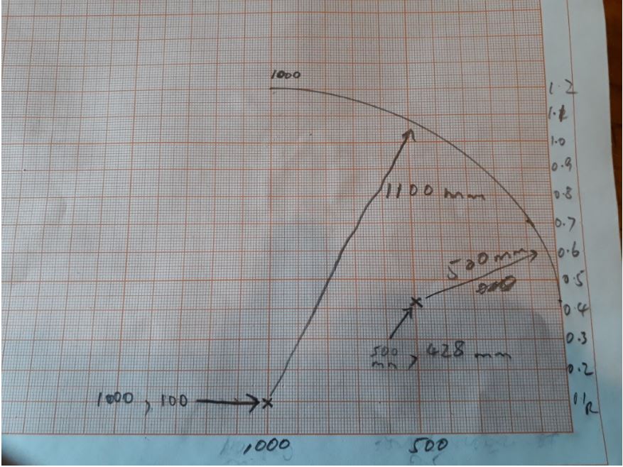

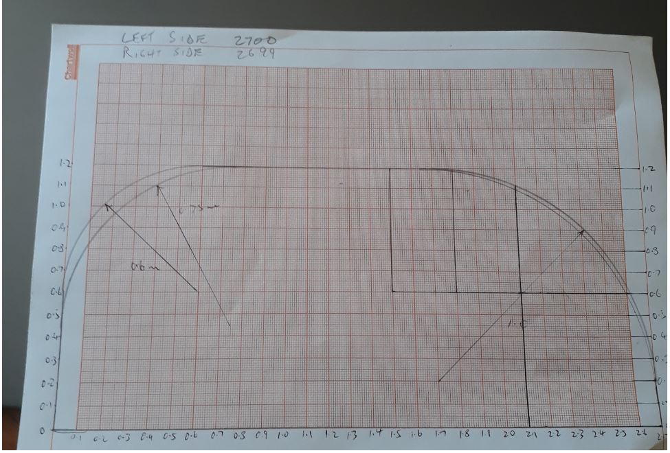

Here is the rear profile.
Rear profile.JPG (117.14 KiB) Viewed 3777 times
Starting from the rear end of the sheet, measure in 1000mm top and bottom and draw a line.
Measure up 100 mm and draw a line parallel to the bottom of the sheet that interesects the vertical. This gives the pivot point for an 1100mm radius that starts from the top edge at the 1000mm mark.
measure in 500mm from the rear end of the sheet and draw a vertical line. Measure up 428mm from the bottom of the sheet and draw a line that intersects the 500mm line. This is the pivot point for a 500mm radius that will intersect the main curve at coordinates 89mm in from the end of the sheet and 709mm up from the bottom.
I was able to machine the 1100mm radius, then come back and round off the transition into the vertical rear of the sheet with the second 500mm radius.
Very satisfactory result.

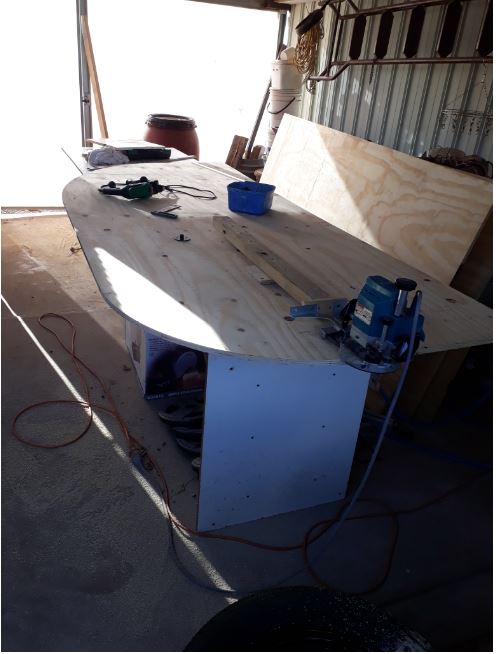

Fairly happy with the first side.
Followed up the rear cut with a simple 600mm radius at the front
Cutting front radius.JPG (50.25 KiB) Viewed 3773 times

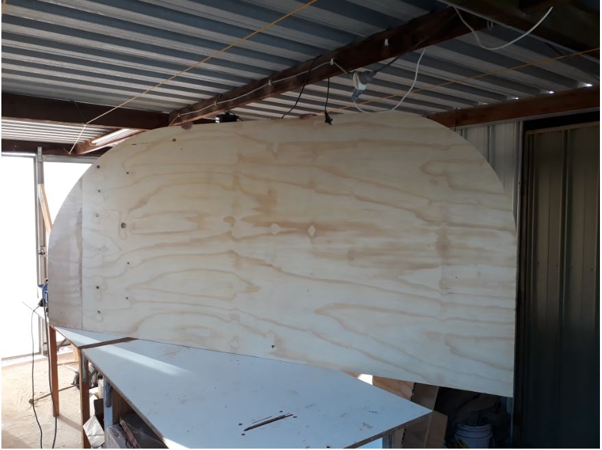

Completed profile.
I will trace this onto the next sheet. I'm going to operate from the pre-determined fixed points for the radii, but a pencil outline from the first sheet will alert for any mistakes.
1st side.JPG (70.37 KiB) Viewed 3773 times

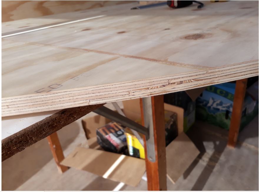

The other thing I'm pretty happy with is the internal appearance of my "triple lap scarf"
splice after machining.JPG (68.69 KiB) Viewed 3769 times

Mate, just a heads up on your radius. I had a 600mm on the front of mine and 6mm marine ply only just bent around it with a few stress cracks I had to sand back. That said I also had 480 for a portion of the hatch and that worked OK. If you can source 4mm that would be better.

Thanks mate. Making the decision on the radius has been a major impediment to my progress. I read about your adventure with surface checking, and it gave me pause.
My local choices are 4mm marine ply or 2.7mm luaun ply.
The 2.7mm luaun ply is so flexible (local joint uses the alternative spelling) but is "interior bond" so a bit unappealing.
The 4mm was recommended by a local bloke who built a beautiful semi-displacement boat that he used for commercial fishing.
He followed that with a replica of a 1950's model bondwood caravan to tow behind his restored FJ Holden.
He's a control room operator at work, and when I got seconded over to his plant to assist with the metallurgy for a while, we found time for a decent discussion one quiet-ish night shift.
Anyway, he reckoned 4mm marine ply is plenty strong enough to clad a tear drop and bends OK.
I looked it over at the store, and I could pick up the top sheet and flex the full 8 feet sheet a little just by hand, hanging onto the long edge. This made me think it doable.
The Benroy drawings show a 19 inch front radius, 600mm is a touch over 23.5inches. So I said bugger it, time to "piss or get off the pot".
I calculated that, if you wanted to leave 25mm at each end of the curve for fastening the sheet, max radius is 732 mm.
If I absolutely have to, I'll put little tiny kerfs through the surface veneer on the inside of the curve. That can be hidden and will effectively turn it into 3mm 2 ply. I have a pointed bit that will fit one of the routers, and I could easily set it for say 1mm, if soaking the sheets in hot water doesn't do the business. Of course at 600mm radius, and say 10mm spacing, it'd be something like 90 cuts. :)

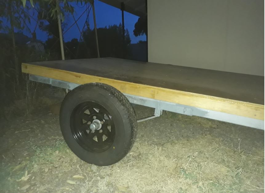

Got a little done today.
My new 1000 kg axle turned up during the week.
I hit it with the pressure washer and gave it a lick of zinc rich paint.
Then my son and I transferred the hubs (I showed him how to re-pack a bearing with a blob of grease in the palm of your hand) and bolted the axle in.
Put the new wheels on too.
Waiting for Monday now so I can drop the money for the doors and hinge in the vendor's bank account.
New axle.JPG (175.83 KiB) Viewed 3638 times
New wheel.JPG (69.63 KiB) Viewed 3638 times
