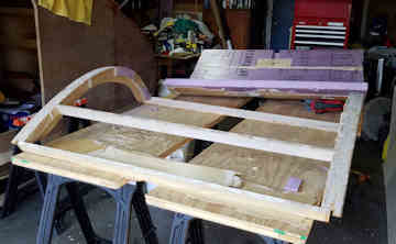

I finally got all those staples pulled. Well, except for the ones in the bottom spar. I wanted to see if I was going to keep it before I put any more time into something I was just going to cut away in the end. After I pulled the last one, I rolled it back over and went after it with the jig saw. Here is the end result
20210403_184639 Small.jpg (35.66 KiB) Viewed 1717 times
There you can see what I am keeping in the front and what was thrown away in the back. The next thing I did was get the hinge reattached and put the remains of the hatch on the cabin. After close inspection and a second opinion, I determined the twist was gone :D Here is is back on the cabin
20210403_200943 Small.jpg (37.35 KiB) Viewed 1717 times
Sorry about the focus. It is a little fuzzy but there it is. I started cleaning up the glue and found that the Dremel Rigid Scrapper that I have for my oscillating tool works well for scraping off the glue without cutting away the wood. Though it struggles with the areas that still have plywood attached. I think with this scrapper, I will be able to clean up the spars and rails very quickly. Afterwards, I think I will go over it with the sandpaper to clean up any little bits that are hanging on. Tomorrow, I will pull it off the cabin and clean up the under side and hopefully, later this week, I will get the new spars cut down to size. Next weekend should see the spars attached and, hopefully, the inside skin reattached. I can see forward progress around the corner and that's a good feeling.
I do have one question. Will I need to block the new spars. I will attach them to the blocking that is already attached. Do I need to use blocking to lock the new spars or will the two pocket hole screws be enough? If I need to make new blocking, I will need to make new a new template since I got rid of the old one trying to make some space in the garage.

Postby tony.latham » Sat Apr 03, 2021 8:42 pm
The skins will lock the spars in place. No new blocking needed.

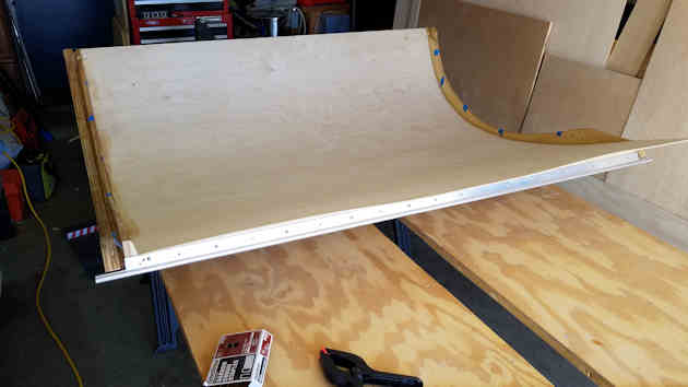

Postby JoeGrz » Tue Apr 13, 2021 7:47 pm

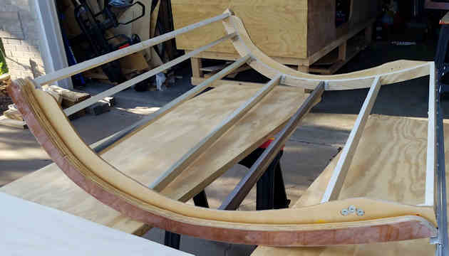

This past weekend saw forward progress again. The hatch has a full set of spars and the inner skin. Thanks Tony for replying back on the blocking. Not having to put that in again saved a bit of time. Looking at it to lay out the spars again, I found that the third spar was placed at 10 inches from the previous spar on one side and 11 inches on the other side. I'm not sure if that caused the twist when they all staggered but I appear to be past it now. Since I had difficulty holding the spars in place last time, I made a little jig to hold each end in place while I checked my measurements and secured the ends.
20210410_112241 small.jpg (39.57 KiB) Viewed 1633 times
I would like to say that this was my idea but I copied it from the other book I read to figure out how to build a teardrop, The Handmade Teardrop Trailer by Matt Berger. He placed his roof spars prior to the ceiling and used a similar jig to hold the spars in place before they were secured. One fixture on each end worked well for holding the spars in place and allowed me to check and double check the measurements between each spar. Rather than place the spar over the cut off, I set the new spar next to the cut off on the 11 inch side. The frame was secured to the cabin with the hinge so that the hatch would be in the same place as the previous build. After the spars were in place, I checked for twist and all appears good. Here is the hatch with the spars in place prior to receiving the inner surface.
I trimmed the 3mm plywood down to fit between the gussets and secured the skin the next day. Instead of stapling the top and securing the next row with screws, I lined up the sheet and secured it with screws then stapled it along each spar. Something that I noticed after the third view of Tony's video is that the bottom spar shouldn't remain perpendicular to the curve but should line up with the end. Since I haven't done that, I will need to build a piece to reinforce the skin on the bottom. Here is the inner skin before the end was trimmed
20210411_134407 Small.jpg (40.77 KiB) Viewed 1633 times
The blue tape on the gussets is how I marked the spar locations. I drew a line between the pieces of tape and placed the staples along the line. After the skin was trimmed, I mounted the hatch back on the cabin and still no twist. I would like to place the blocking for the attachments, wiring, foam and exterior skin next weekend. The exterior skin may be a problem since one of my pieces of plywood was too short for use as the inner skin. I will have to see if I can pick up a sheet or if I will have to order one in. I also will need the weather to cooperate. They are calling for rain this weekend which means that the garage won't be open to build in.

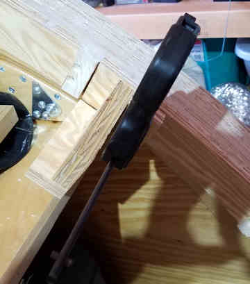

After two weekends of working, I have a hatch!! The construction of the hatch went a little different than I planned originally. I put my blocking in and was getting ready to drill the holes and run the wiring when I decided that finishing the interior surface would be a whole lot easier without wires flopping around in the way. I was expecting to put two coats on last Sunday but it never got out of the low 50's so the varnish didn't cure as fast as I needed to get the second coat on. So this past Friday was a lot warmer and I managed to put on the last two coats. Saturday I was able to place the foam and attach the skin.
western traveler wrote:Is it possible that you racked it when adding the second skin?
I know that earlier I said I thought it was not from the skinning process but now I am not so sure. I went to align the plywood with the bottom spar and I could not get the skin square on the frame. the bottom spar like the rest of the build was not perfectly square so I may have put the twist in making it square. To hopefully put everything on without twisting it, I started at the hinge end and worked to the curve. I, because I didn't want to pull two sets of staples if I had to redo the exterior again, started with only one row of staples down the side. Don't do that! Run two sets on each side. 1/8 or 3mm plywood may bend but it doesn't want to. At about the 3rd interior spar, it wouldn't bend without the second row of staples down the side to hold it in place. Here is the hatch on the cabin.
20210425_111458 Small.jpg (35.74 KiB) Viewed 1426 times
Sunday, I took it down, removed the hinge and rounded the edges. There wasn't time to put down the fiberglass so Friday, weather permitting, It will be glassed and I will fill the holes and low spots later in the weekend. Maybe Sunday.

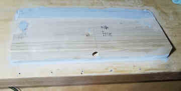

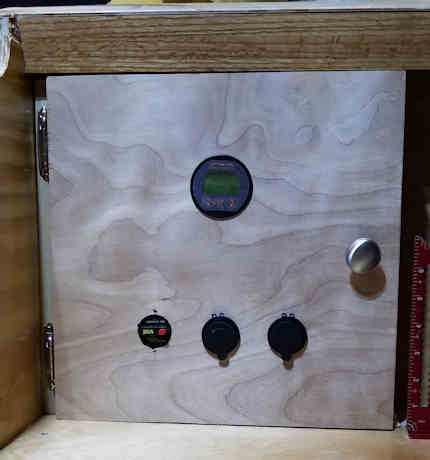

The other task I was taking care of was my electrical enclosure. It was something that I could do at night as time allowed. Here is what I have come up with
20210425_201920 Small.jpg (40.38 KiB) Viewed 1426 times
the top is my power meter/charge indicator then below I have a 20 amp breaker/switch and two 12 volt outlets. The hinges are stiff so I was thinking that I can get by with the pull shown. As I am opening and closing it, I am beginning to think that I will need to use one of the latching pulls like I am planning for the drawers. It is not finished yet. It will get its varnish when I finish the drawers.

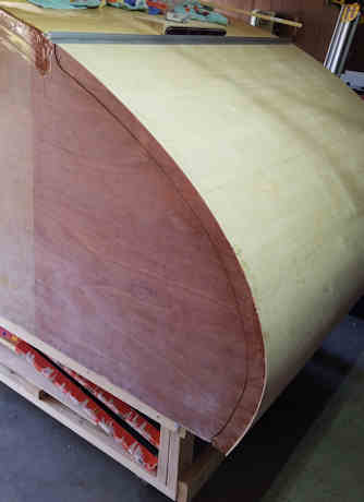

Postby JoeGrz » Wed May 05, 2021 6:36 pm

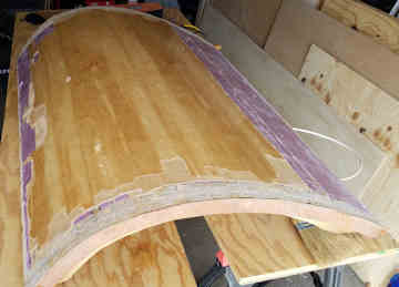

The build creeps forward. Last weekend I fiberglassed the exterior of the hatch. Back to where I was before I found the twist! :D Other than that, there was not much to add. I had very little epoxy left after the hatch. Since there was not enough epoxy to thicken and stick the brake light on the top, I attached it with the construction adhesive and secured it with two screws. I ended up filling the the gaps and smoothing the back of the block out with body filler. Here is what that looked like when I finished
20210502_202951 Small.jpg (27.13 KiB) Viewed 1343 times
I put a piece of glass cloth over it and then the last little bit of resin over it tonight. Other activities of note are that I finished the wiring and can turn the lights on with battery power and I am playing better with the welder. I actually have beads that look close to the way they are supposed to. I won't put the chassis together yet but I'm closer.
Next up, I will fill the holes with the body filler and prime the cabin and hatch. Next post will hopefully show a white teardrop cabin. Of course, the other thing that I have to do is weld. I don't think I'm far but I'm not there yet.

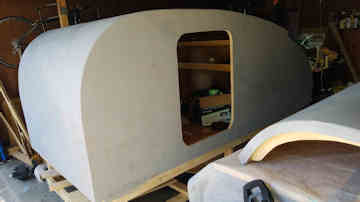

Last weekend, I filled the holes with body filler and primed the cabin. I now have a gray teardrop cabin
20210509_163128 small.jpg (29.83 KiB) Viewed 1240 times
Getting there was quite a learning experience since I had never used body filler or the Rust-Oleum primer. Start with the body filler. I think I threw away as much as I put down. The trick to that in my case is to make very little because, unlike the wood filler, it becomes unworkable in a few minutes. I got a little bit of working time going light on the hardener but not much. The primer was an experience too. I was planning on something like the latex primer for the house. This stuff had no thickness to it. It dripped and ran down the walls faster than I could work in some areas. Not only is the cabin gray, so are several areas of the garage floor. And Tony, you were right. The primer highlights the low spots. I have some more filling to do.
