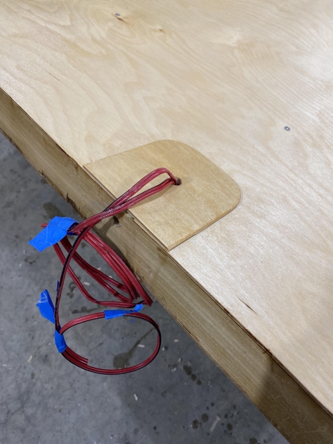

I notice that the top spar of your hatch has a hole for wiring. If what I'm about to describe has already crossed your mind, good job thinking ahead better than I did. When I built my hatch, I attached the inner skin, ran my wires, insulated, and then attached the outer skin. I then stepped back and realized that I was going to be pinching my wires between the hatch spar and the first spar on the hatch with them running through the top spar the way they were. With some careful trimming with a box cutter, I was able to trim the interior skin back enough to pull the wires back and through the interior face of the hatch.
The picture below shows my fix for it. You can see the original hole through the spar if you look closely. With them ran this way, there is no wire pinching. I believe Tony ran his through the interior side of the hatch as well. I just wasn't paying close enough attention as I was moving through this stage.

Garth,
Thanks for pointing that out!
I had it in my mind coming up through the bottom with the wires in a split wire loom but I was being so careful with alignment and not wanting to make a mistake it slipped my mind.
Great catch! I would have been faced with the same situation…
