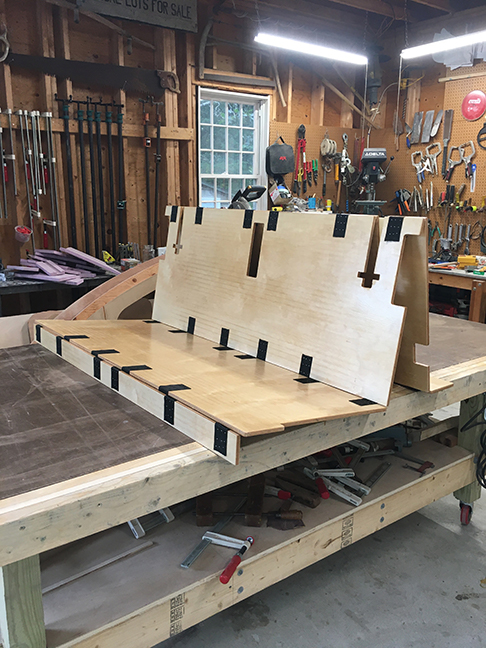

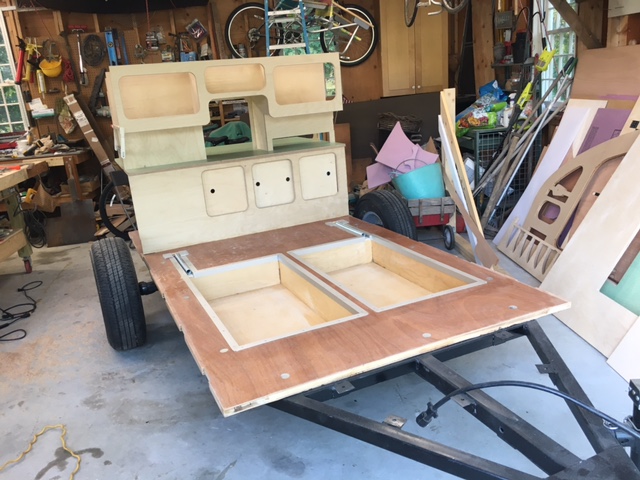

Postby Capebuild » Sun Jul 18, 2021 4:21 am
July 18, 2021

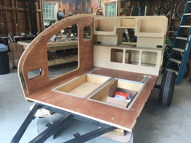

Thank you all for the encouraging comments. Perfection is something to strive for, but from my experience (and many others, I'm sure) there always seems to be something that's "not perfect" and you wind up focusing on that hiccup.
Us humans.
At any rate, fiddled with the other side and got that fit in place. That side was actually pretty close to just fitting on without much adjustment.... which is a good and a bad thing. Meaning I'll have to further adjust one side or the other so both sides line up symmetrically. But for now I'll leave the fits as is and make further adjustments after I get the 3 layered side panels all glued up and ready to be permanently installed in place.
John

Postby Capebuild » Fri Jul 30, 2021 4:50 am

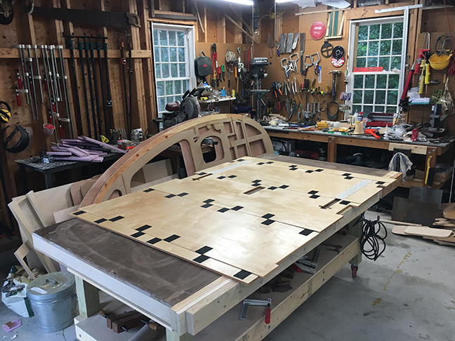

July 30, 2021

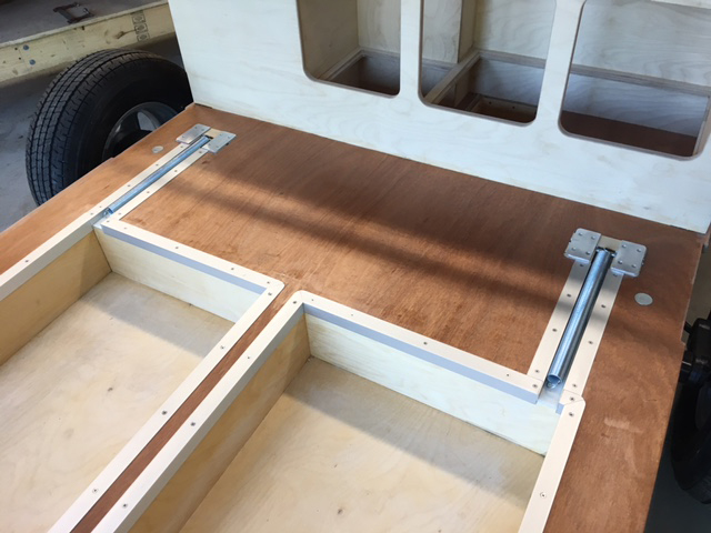

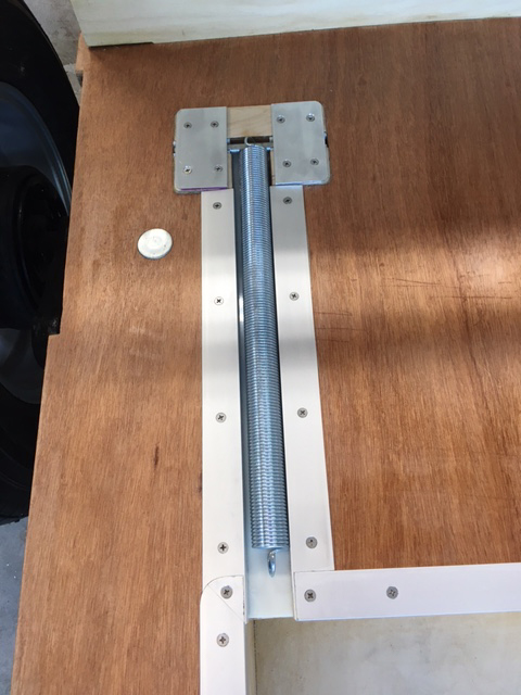

I've been working on the bed platform which will support the mattress and also fold up to a couch position.
Shown here just on the worktable (bed position and couch position).... won't install it into the trailer until I get the wall assembly attached as there are
Delrin slider tracks that will be installed under the platform and they get placed up against the inner wall sections.
John

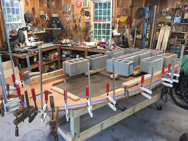

July 31, 2021
glued up the exterior panel to middle skeletonized panel. Good thing I had my wife to help... had to move fast spreading out all that adhesive and stapling all down with crown stapler. You read about others doing this and kind of remember their comments about "moving fast" during this operation, but when you get to actually doing it, you see what is meant by "move fast"........I think it went okay. Probably used too many crown staples and went through that single tube of 939 in no time. luckily had some PL3X to complete the job. Will order more 939. Also got the tracks finished which will house the springs for the bed / couch platform.

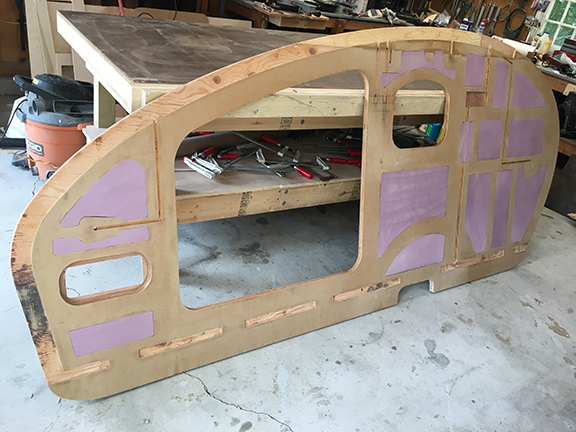

Aug 1, 2021
Today removed the clamps and cinder block weights on the first side panel glue up, filled the staple indents with Bondo type filler, and orbital sanded. Also fit in place the 3/4 inch insulation panels (friction fit).
Next up is to glue up the interior panel to the assembly. (third panel making up the left side).
Looking at this now I might have been able to cut a bit more wood out of the middle skeletonized ply to reduce weight... but all in all not sure it would have saved all that much (weight). Once I get the interior side glued in place I'll weigh it.. .just curious.
John

Postby noseoil » Mon Aug 02, 2021 9:15 am
John, if I remember correctly, the side panel with one skin in place on our trailer weighed in at 34#. This was with the 3/4" skeleton wall & one layer of 1/8" Baltic birch glued in place & trimmed, no insulation either. I believe it did have the ceiling rabbet cut into the perimeter as well for this weight.
137905
noseoil
Posts: 1822
Images: 670
Re: CapeBuild Build Journal
Postby Capebuild » Mon Aug 02, 2021 11:18 am
Thanks for that poundage info Tim. Spurred me on to put my panel on the scale. Very heavy, compared to yours at 34#s. My 3/4” middle panel and outer .238 okoume panel with insulation weighs in at 59#s. I also weighed what will be the inner panel, .157” okoume, that alone weighs 10.6#s. So seems if I don’t make any revisions the entire 3 section side wall assembly would wind up at about 70#s.
The 3/4” MDO panel alone weighs 39#s.
Looking at where I can remove some material from the middle MDO panel and try to reduce the weight.
Thanks again.

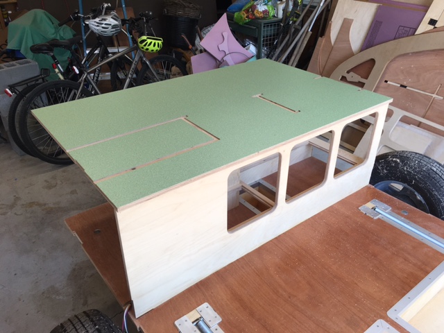

Installed laminate which covers kitchen/galley area and extends into cabin area. We ordered this laminate (kind of a retro boomerang design) 3 weeks ago. The local supplier said it would take 3-4 weeks, so very happy with the timing in which it arrived. If I had to do it again, I would have applied to laminate to the ply substrate and then had it CNC'd with the dados cut into it. Had to cut in the dados for the cabinetry after the CNCing. A bit of a challenge but came out.
Today, dry fitting the cabinetry. Now that we see it in "real life" making a few changes before finalizing it and gluing up. Had planned on having the monitors, readouts and switches in the lower left galley side, but now moving them to the upper center opening, galley side, to allow for more "kitchen" space. Also the opening on the right, inside cabin area was going to be a drawer and that will now be just a solid piece of wood, no drawer. The middle pass through from galley into cabin will be fitted with a 2 piece screen opening vertically with the bottom section sliding up. Installed the sliding doors in the cabin. Will be making some adjustments to those to tighten up some of the spacing between the panels.
Also, not shown, glued up the 3 piece (with insulation) right wall assembly. I'll step out on a limb and say gluing up the wall assemblies will probably be my least favorite activity of building a teardrop. Not a lot of time to get everything clamped down and not have the pieces kind of slide around out of sync. I had some alignment pins in the outer ply to the middle section which worked well in keeping the layers aligned .... but not for the inner wall to the middle wall. That was a bit of challenge. But persevered.

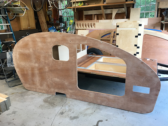

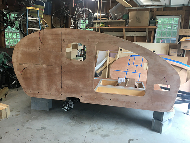

Postby Capebuild » Sun Aug 22, 2021 3:07 pm
It's been a while since I've posted any updated shots...so checking in and sharing some progress and progress shots.

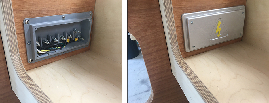

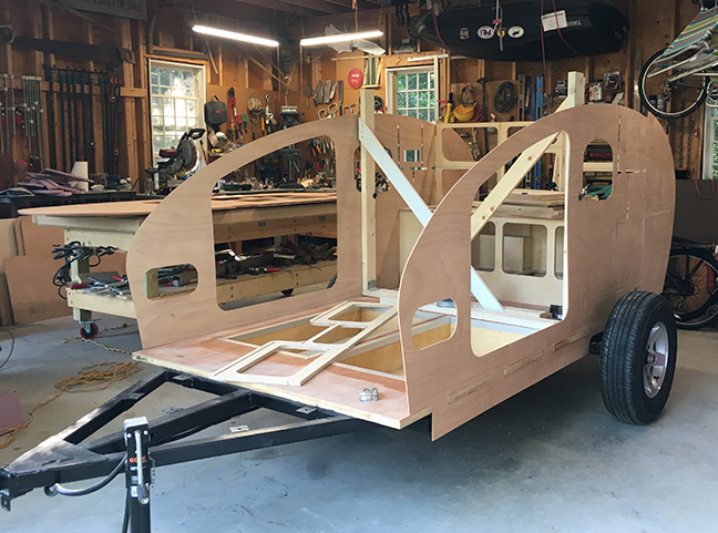

Got the 2 sidewall assemblies all glued up. Installed one wall today. The tab and slot configuration on the bottom of wall where it mates with floor worked out well. I got some flat headed ledger lock screws which really pulled the wall against the floor nicely (round shapes running along bottom of wall). On the other hand, the cut in dados (into the side wall) that were to match up with the cabinetry did not work out so well. I guess in the end it wasn't "so bad as I thought" but getting all those sections to line up was a real pita. Had to go back into the dados in the sidewalls and tweak them to get every thing to fit. If I had to do it all over again, I would have made all the cabinetry walls fit flush against the sidewalls. So be it.
I had ran all the tow vehicle wiring from the 7 pin connector back to the rear of the chassis. When I created the side wall for that side I made a channel in the MDO middle wall skeletonized section where all the wire would run up through the wall. So that worked out well. Fed it all through the opening and pulled it all up into the junction box I made (3-D printed)... shown with the cover made also. All the house battery wiring will run up the other sidewall in a similar channel.
Going to start install the elex components tomorrow. Got everything collected (minus the battery charger which should be here this week). Should be easier to place and screw down all the components with the other wall not installed yet. From the manual I see it's clear the solar controller needs to be mounted vertical (not horizontal as I had originally planned) due to heat up and air flow considerations. Also suggested to mount controller on flame proof board. Probably a "lawyer" thing, but I'll do it. Seems to make sense.
