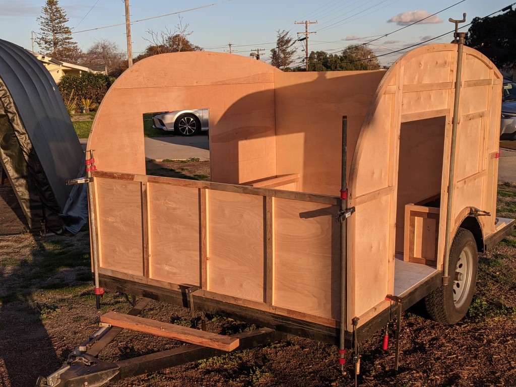

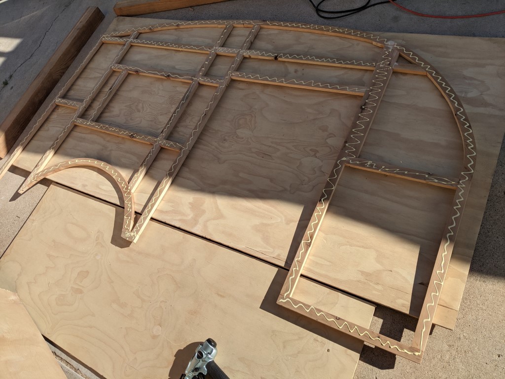

One of the best milestones was reached yesterday when I finished the frames and attached the inside paneling to the walls.
Glue here.jpg (183.89 KiB) Viewed 2501 times
Walls up.jpg (237.01 KiB) Viewed 2501 times
So much done and so much to go! 8)

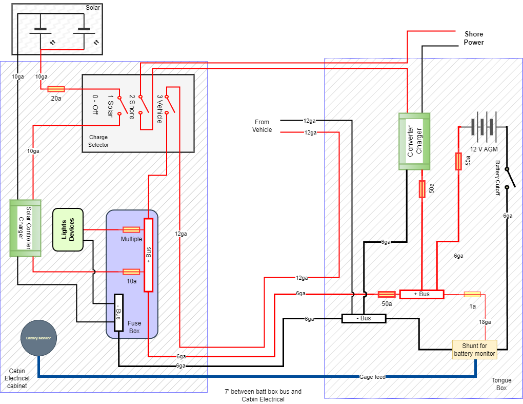

On the electrical side of things I have converted my electrical schematic to a wiring diagram. I needed the schematic to understand how things worked in a DC system. I need the wiring diagram to actually build it.
Main Electrical Wiring Diagram.png (159.86 KiB) Viewed 2501 times

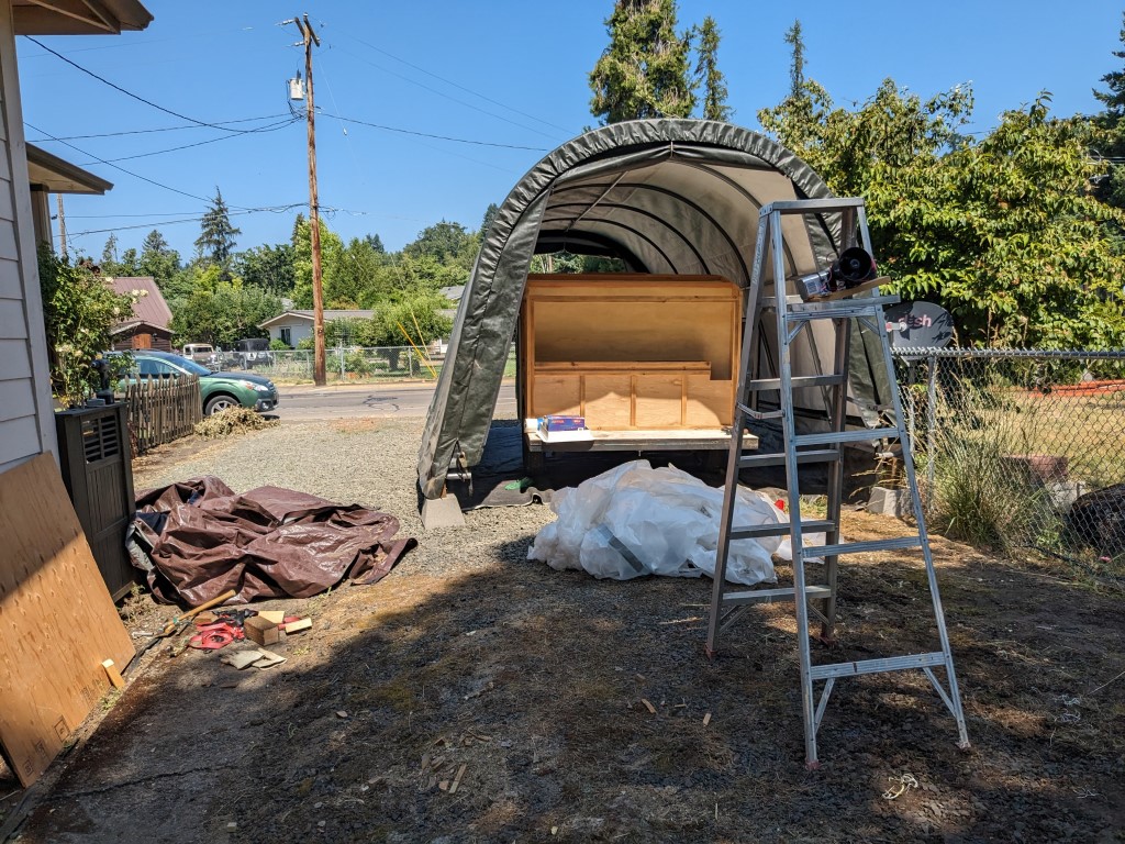

Once we got settled in, which took about 10 weeks, I got reassembled the carport. This is way more important in Oregon due to the rain.
Carport assesmbled.jpg (315.34 KiB) Viewed 2429 times
Carport sweet Carport.jpg (297.48 KiB) Viewed 2429 times
So, after all of that I will be starting back to work. My hope is to have it done by the end of summer. Then we can run it thought some short tests, trials and tweaks locally in preparation for a big trip in the spring. We are talking a couple of months on the road in Idaho, Montana and parts beyond.

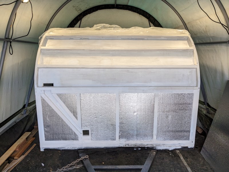

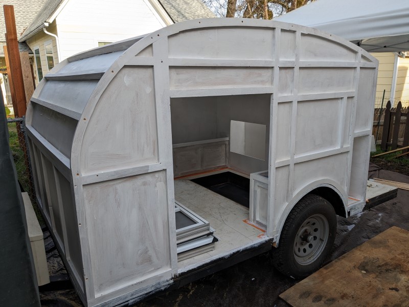

The first issue I ran into was mold. I had started my project in sunny and dry southern California. After moving to Oregon I put my trailer in its carport but it was no longer wrapped in plastic in hopes I would work on it soon. The months rolled by as we were busy getting back into our life in Oregon. The medical issues also kept me from even thinking about working on the trailer. When I did go out to check on it last month I was shocked and my heart sunk to find that all the exposed wood was covered in a greyish/greenish mold, or mildew. So rather than moving forward I had to clean the mold off and put a mold resistant primer on the whole thing. (See pictures). This ruled out having the interior staying wood because the mold had robbed the wood of its beauty. Since the outside was going to be PMF anyway there was no loss there. That is what the mold resistant primer was for in the first place.
The great news is that though medicine and an exercise routine I have been starting to have better days and I am very happy to be working in the teardrop again. We have late spring as a target for getting it done and then a long trip to Idaho where we hope to move next year. OK, on to the pictures.
This is the trailer with the finished primer coat.
Primer coat inside and out.
Primer Coat.jpg (113.37 KiB) Viewed 2082 times

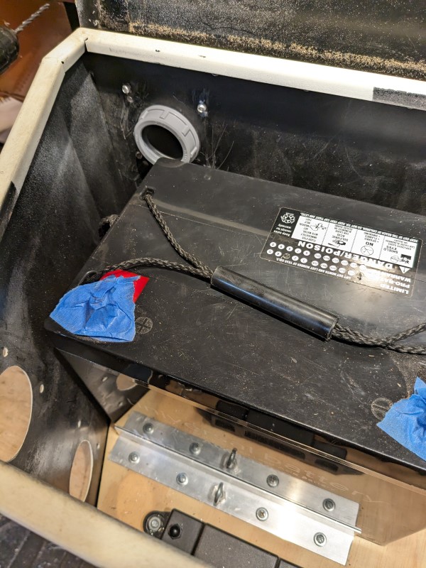

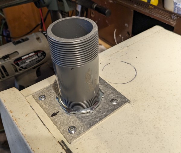

Progress was made toward getting the electrical system installation started.

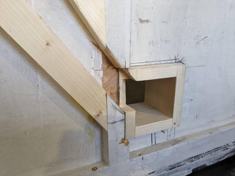

I was working on solving the challenge of getting electrical from the tongue box into the front wall and then up to where the interior panel will be with the fuses, solar controller, charge selector and usage meter.
The pass through is behind the battery.
Electrical box.jpg (142.51 KiB) Viewed 2080 times
Conduit from the outside
T4-Electrical Conduit.jpg (67.64 KiB) Viewed 2080 times
Electrical access box.
Electrical Access.jpg (98.46 KiB) Viewed 2080 times
I have plans for most of the trailer that I made, however like this challenge, I did not engineer every aspect of its construction. This is where custom really takes on a more vital meaning.
It's good to be back at work. Pray that my health holds.

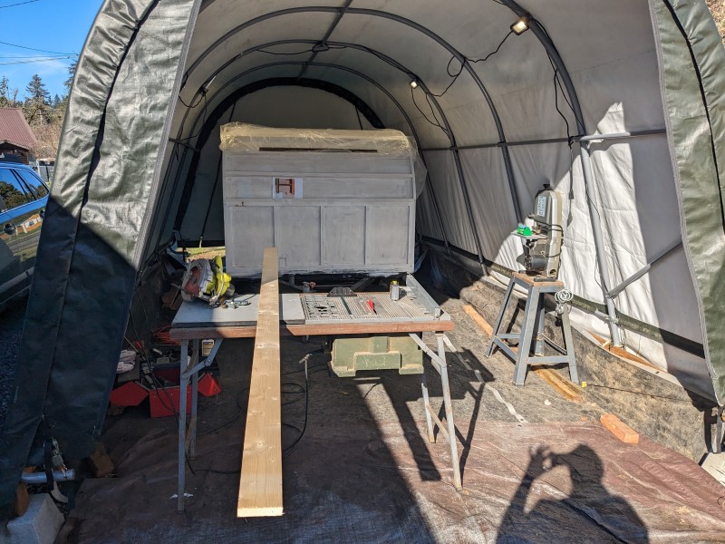

Here is my new workspace. Still no garage and now, no sold driveway. My driveway here in Oregon is gravel.
New OR Shop.jpg (152.1 KiB) Viewed 2078 times

Postby tony.latham » Wed Feb 07, 2024 2:22 pm
On the electrical side of things...
The only thing I caught was no disconnect between your panel and the controller. Without that, if you disconnect your battery, you can damage some controllers. Certainly my Renogy works that way.
Re: The Tiny Tillson Teardrop Trailer (T4)
Postby BLTillson » Thu Feb 08, 2024 1:13 am
Right, thanks, I think we talked about that before. I will take a look and make sure I make the appropriate changes. I had read in other placed that the Renogy was susceptible to that kind of damage.
