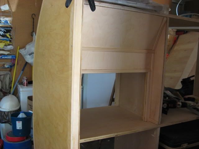

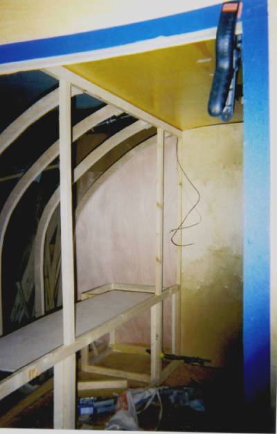

Postby Miriam C. » Tue Nov 14, 2006 5:32 pm

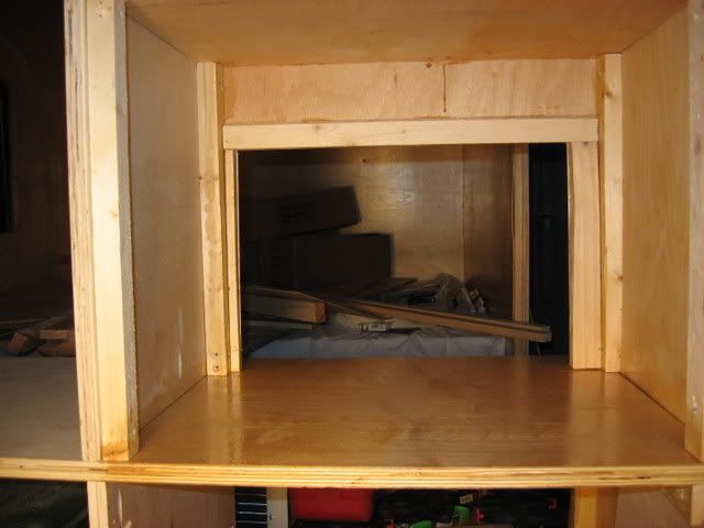

Finally a decent picture of the problem bulkhead wall. As you can see it needs paneling. I am going to try to put sliding doors on the top middle and an open cubbard for the tv in the upper right. The lower left has the air and the lower right will have the battery/electric.
The center will house the cooler and hopefully have access from the inside, with some manipulation.
Suggestions are always welcome. Thanks in advance.

Postby NightCap » Thu Nov 16, 2006 12:47 pm
You're trailer is extreemly nice. Just thought you ought to know. :thumbsup:

Postby Miriam C. » Thu Nov 16, 2006 1:27 pm
Thank you very much Kevin both for the compliment and for the solution to my problem. I think I can send two doors going right like the sky in your signature. :D
I forget the simple stuff. :?

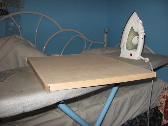

Trimming out the TV shelf with iron on Birch strips. Works great.

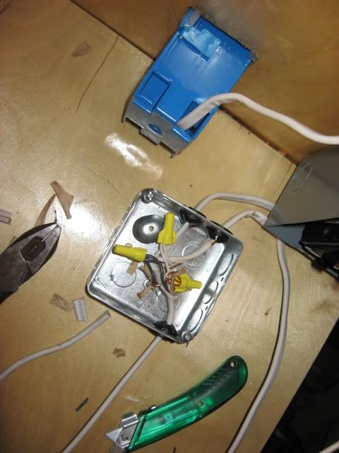

The 120vac is wired. I have decided to put the air conditioner and TV on one circuit and the galley on the other.
The air conditioner only pulls 4.9 amps. (edited)
Postby asianflava » Wed May 09, 2007 10:47 pm
Miriam C. wrote:The air conditioner only pulls 4.9 watts.
Amps? Don't forget that it's starting current is much higher.

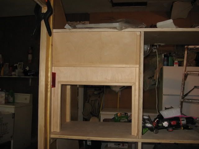

Postby Miriam C. » Thu May 10, 2007 11:13 pm
The electrical is now on the wall and as far as I can take it till my stash gets in. :)

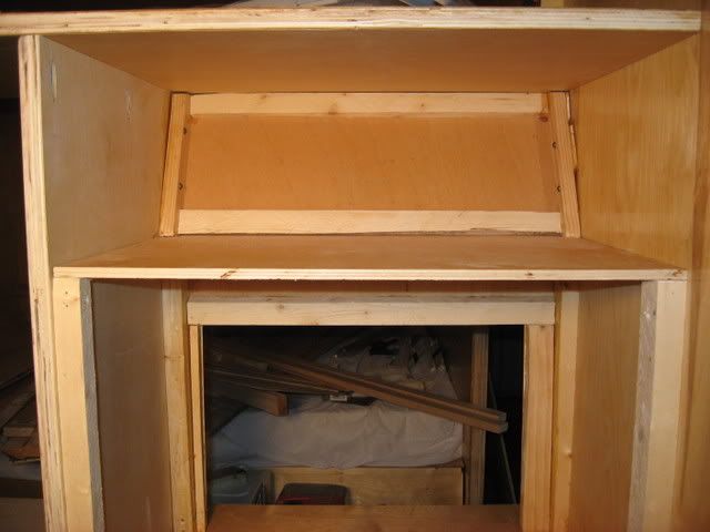

Just waiting for the varnish. This is the air conditioner cabinet.
The back of the air cabinet. This ends up a galley shelf.
The back air cabinet. This will be closed off---I think---any advice greatly appreciated. :worship:
