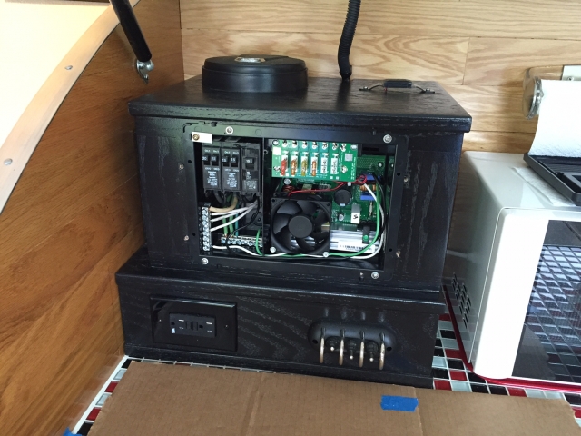

I finally had a chance to get back to the garage. The converter exchange is finished and working! :worship:
The new converter is not at wide as the old, so I need to fill the prior screw holes before snapping on the cover plate.

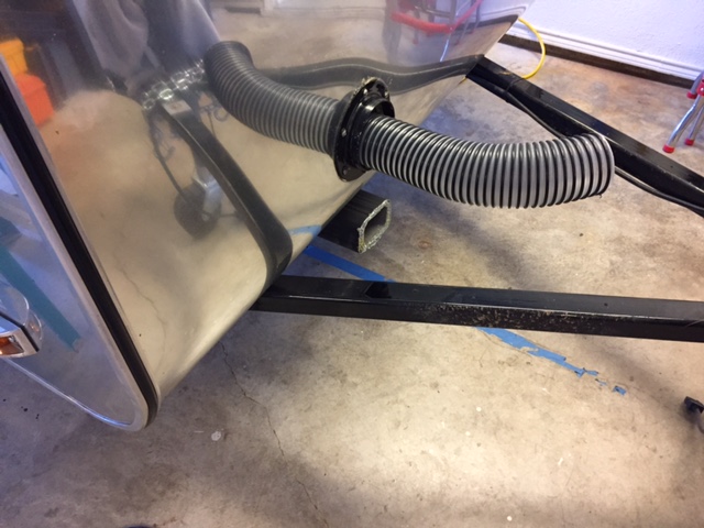

I finally freed up one day to work on the teardrop. I finished the electrical upgrade and started the replacement of my (non-working) PetCool with a standard window air conditioner.
My PetCool was mounted in the tongue box. The deconstruction took most of the day since:
a) The installation was built with "permanence" in mind and was never intended to be removed, and
b) The tongue box was more than just a transportation container for the PetCool.
The Petcool was mounted in the tongue box. Supply air was ducted through the back of the tongue box and through the front of the teardrop into the interior headboard cabinets. The return air was ducted from the galley wall, along the bottom of the teardrop, up to the bottom of the tongue box. The tongue box also had a 120v outlet to power the PetCool.
All of the above had to be removed so I can (hopefully) re-use the tongue box for the new window air conditioner. Below are some deconstruction photos:

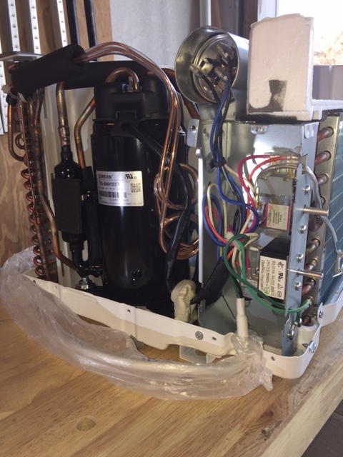

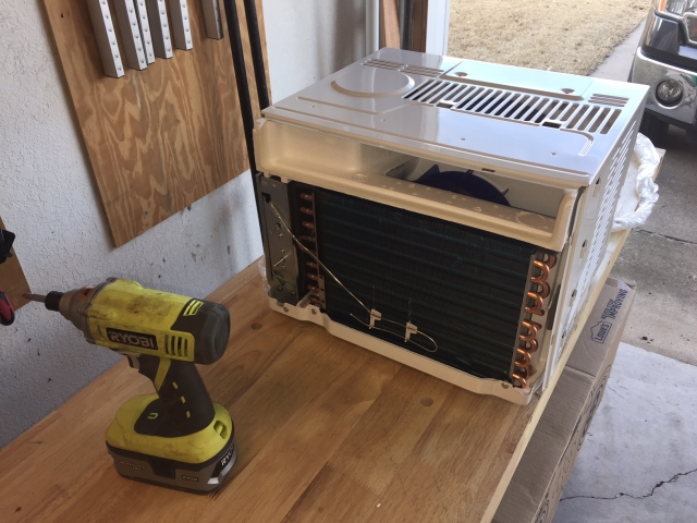

Had a few hours on Saturday to work on the replacement air conditioner project. My plan is to modify a window unit to permanently mount it in a tongue box and to change out the controls so that it can be thermostatically controlled from inside the teardrop.
The first step was to disassemble a perfectly good and working window AC unit that I had purchased. Similar to my original PetCool installation, I plan to duct the supply air and return air. The front plastic cover will be replaced with sheet metal plenum and ducts, so I removed the cover and put it in the trash bin.
The window unit had manual switches and controls that worked off of line voltage (120 volt AC). These won't work with the residential (24 volt DC) residential thermostat I plan to use, so the next step was to remove the window unit shroud so I can get to the controls.
In the picture, you can see the thermostat and fan speed controls. These will be removed and replaced. At the very top you can see the capacitor for the fan motor and compressor. Most likely I will remove this too and relocate it in the same project box where the 24 VDC transformer and motor and compressor contacts will be. (The project box will be accessible so that controls and capacitor could be serviced without removing the window unit.)
I didn't get a picture of it but I also started building a setup to test the thermostat, transformer and contactors before I start working on the plenum and ductwork. Hopefully I'll have something interesting to show next time.
