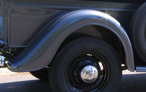

Aggies fender.JPG (52.33 KiB) Viewed 3889 times

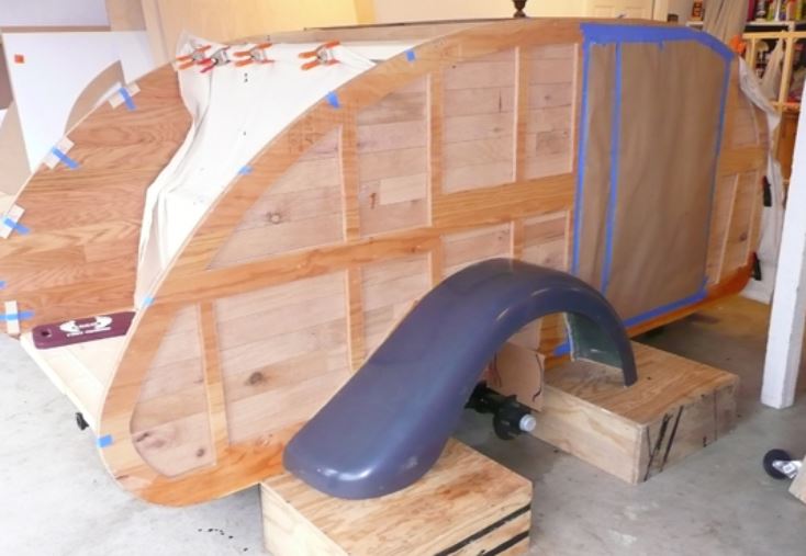

Today I was working to hard in my shop & it warmed up to 65* I was sweating so I found something else to do; so I went through all your posts as this is the first time it has come up since I joined?
I had a notpad out and used it! Outsanding build.
This picture had me thinking.
But then I realized I already built city bumpers and my fenders won't fit :thumbsup:
My fender.JPG (51.01 KiB) Viewed 3889 times

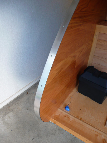

aggie79 wrote:
The rest of the time, I spent fitting trim. It was the same procedure - cut and fit in place, remove trim, add sealant, and re-fit in place. I added trim to the galley sidewalls, door jambs, and doors.
I still have a little more trim to install. Then I can re-install the doors, and install the seals and windows, and the Silver Beatle will be campable - sort of. Oh - I guess I better get the trailer lighting installed too.
Gig'em :thumbsup:
Quick question on where I can find the above trim? Is this just flat aluminum or does it have a slight overhang on one side to ensure the side sheet edge is covered??

Postby Graniterich » Fri Apr 23, 2021 7:18 pm
Very nice, and does it have a leg, right angle lip or is it flat?

Postby aggie79 » Mon Apr 26, 2021 3:05 pm
Absinthe wrote:Quick question on where I can find the above trim? Is this just flat aluminum or does it have a slight overhang on one side to ensure the side sheet edge is covered??
I am currently in the process of ordering aluminum for my trailer and want to ensure I purchase the correct pieces.
The trim has a very small "leg" perpendicular the flat. It is known as aluminum edge trim or counter trim.
I hate to mention this, because the procedure is dangerous, but I ripped down the width of the trim on my table saw to match the sidewall thickness. I did so by fastening the trim to a scrap board using the same fastener holes but with temporary screws instead of the finish nails used in the installation. If you do this, please use all safety guards, a very sharp (new) carbide saw blade, and vertical and horizontal featherboards (with saw fence clamped down) and be aware of binding that could cause kickback.
