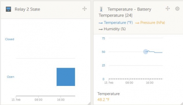

Postby bdosborn » Sun Feb 13, 2022 11:40 pm
lfhoward wrote:I installed a programmable timer on the battery heater circuit, so that the heater’s thermostat would only be energized from 6 am to 2 pm (when sunlight is available to recharge). It has made the battery’s charging system completely autonomous.
I've been commissioning the van electrical system and digging into the relay settings of the Cerbo GX. It has two relays built in that that you would have found handy. One can be used for generator control so it has time of day and SOC settings that would function the same as the timer you added. The other relay can be turned on and off by a Cerbo GX temperature sensor, ideal for a battery heater. I plan to use the temperature controlled relay to control my battery heaters via a 12V Bosch type relay. I also plan to use the relay to disable the inverter/MPPT/DC DC chargers at 2C. The temperature graph and relay state info shown in the VRM is pretty spiffy:
The Raspberry Pi has GPIO pins for a relay that can be used to control a generator too (according to the GitHub Venus description but its a bit vague on what pins they are), it would let you adjust your battery timer remotely via the Venus software. You'd need to use an opto-isolated relay to connect to the Pi GPIO.
