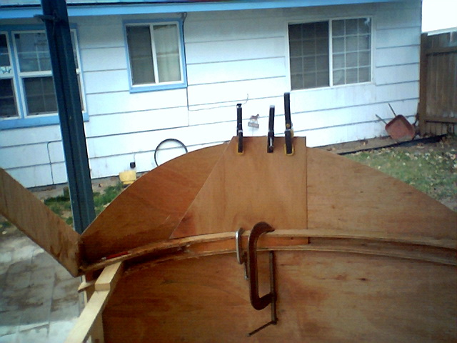

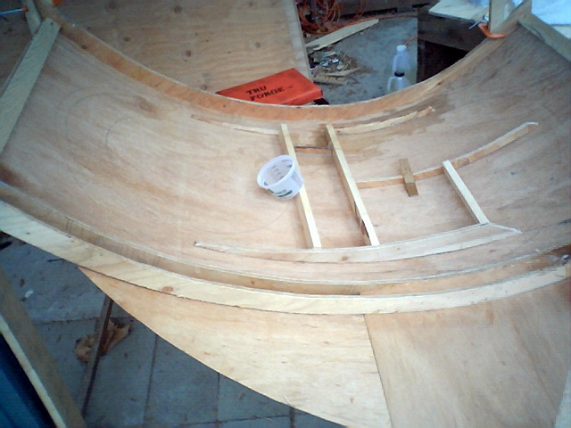

del wrote:Worked on the fenders. Moved them ...... down one inch so my inside floor will be flat.
angib wrote:del wrote:Worked on the fenders. Moved them ...... down one inch so my inside floor will be flat.
The fenders may have been at their previous height because that was where the wheels go to at full bump. Moving the fenders down may mean that now, at full bump, the wheels smack into the fenders.
Andrew
