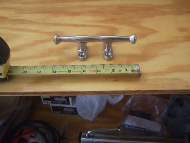

Amongst everything else, it hit me I needed some kind of handle to open the hatch. I've scratched my head for a while on this one.
I happened to stop at Bass Pro to look for a charger inlet to use for shore power. I didn't find anything exciting on that end, but did find this:
The perfect nautical themed hardware. Seasense #50062425

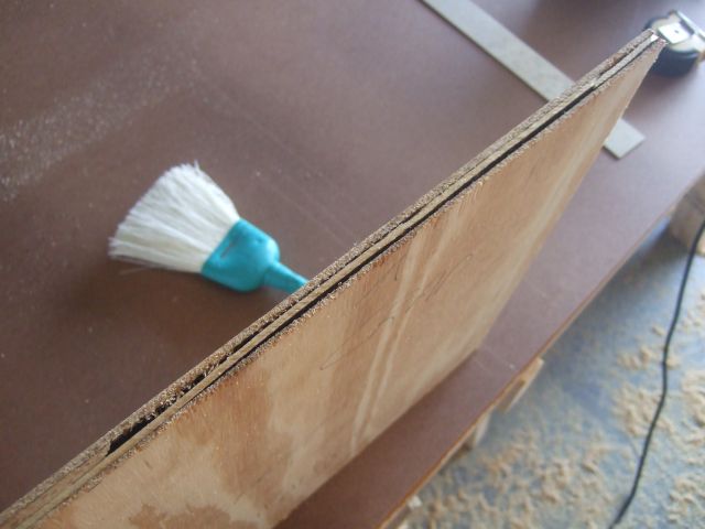

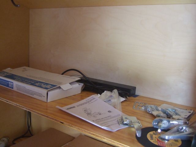

Some miscellaneous pics.
Quality wood, don't ya love it.
A deck cleat hatch handle mentioned above.

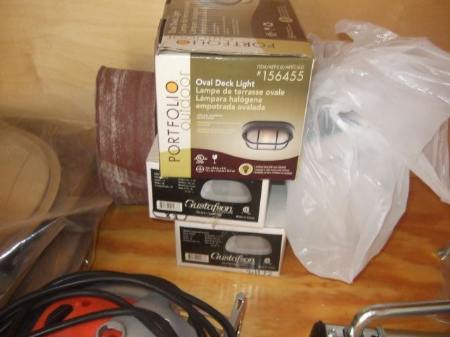

Lights. The "deck" light will probably become a galley light mounted to the hatch.

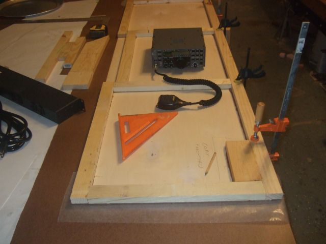

Postby Sparksalot » Sun Aug 24, 2008 4:50 pm

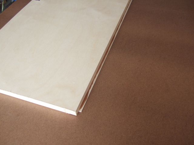

The galley bulkhead is done and in place.

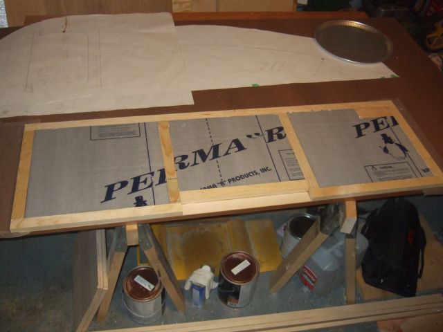

Insulation before the galley skin goes on.
If'n you're wondering about the "extra" blocking at the top corner, it's to allow for some coax bulkhead fittings for ham radio use. The radio here is an Elecraft K2.
I left a lip at the top of the cabin side skin to hold a piece of 1/2" backer rod in place to seal the irregular gap at the top of the bulkhead.

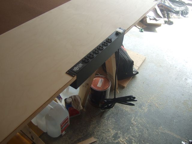

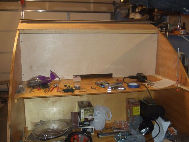

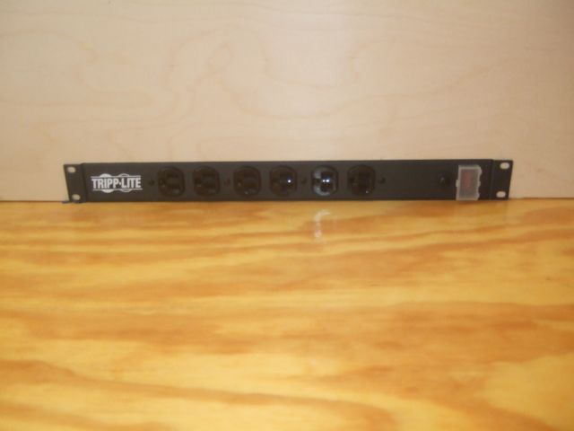

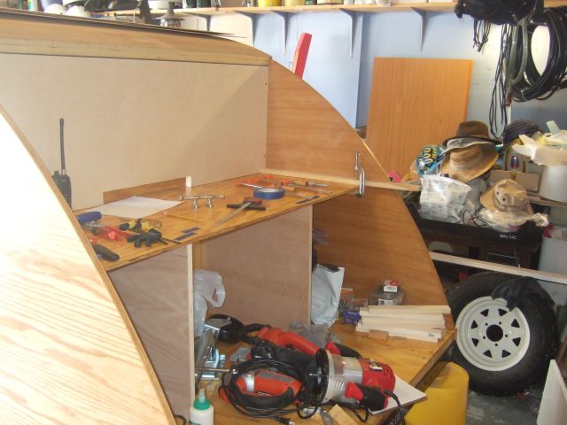

Postby Sparksalot » Sun Aug 24, 2008 4:57 pm

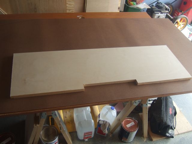

The notch at the lower edge is cut out.
The reason for the notch. This is a power strip for a 19" equipment rack. It has 6 outlets on each side.
Galley side.
Cabin side.
Galley overview.
Supports for the shelf are test fitted. They will also carry the inboard drawer slides for the stove and ice chest.

Postby 2bits » Sun Aug 24, 2008 5:36 pm
Dang! :applause: I am loving that AC power rack! If I didn't already have the holes cut, I would do something like that. Very simple and elegant solution! Nice flag too, I know what it means! :ok:
