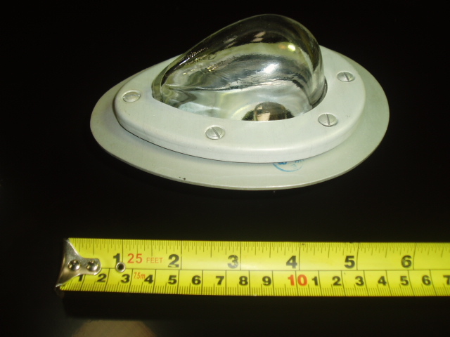

have brought some teardrop shaped bodyside lights from an ebay seller in the UK.
they are navigation lights for a jet fighter.
intend to use some on the roswell.
reckon they will look good on any teardrop.
if you search ebay for the keywords "jet teardrop lights" they should turn up.
the seller ships worldwide.

Now those are cool. And the price is right, only $12.50 for two of them. Too bad the shipping to the US is so high. Also, I wish they were flush mounted. But really nice find! :thumbsup:

I don't know much (if anything) about jets, but most private aircraft (Beech, Cessna, etc.) have 28VDC systems. This allows more wattage with less amperage than 12VCD does. So you may have to adapt these to accept a 12V bulb.

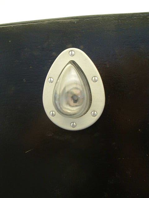

I have the same lights fitted as porch lights on our teardrop. They accept regular 12v bulbs . A 5 watt bulb is plenty when its mounted on the side
Ive sandwiched the light onto the side. The larger plate is on the inside.
I was stunned when I got mine , as they were packed up and sealed in 1963 :shock: :shock:
