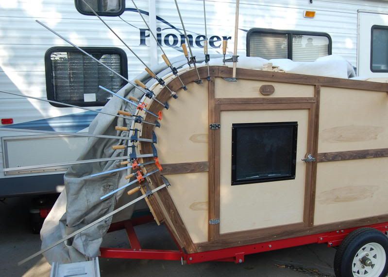

Miguel what an EXCELLENT build you have going!
Your steamer is not going to bend kiln dried wood. It only works on green, naturally cured wood.
Instead of cutting the strips in three, try four smaller ones.
The comment about a block on top, and on bottom is correct. And, your bottom block should be the entire width of the item being clamped. Just using the clamps with one block lets the wood get deformed, like you see on the end clamp. That is what is happening to the whole lamination.
You could probably just use individual blocks on one side, but the upper (as seen in your photos) should be wide enough to be under the whole width of the lamination.
You need to start clamping from one end, and progress to the other end clamp by clamp. You can't put a clamp on each end and work towards the middle.
Good... No... GREAT job.

thank you, john. i didn't know it wouldn't work with kiln-dried wood. lesson learned.
and again, thank you all for sharing your ideas and tips.

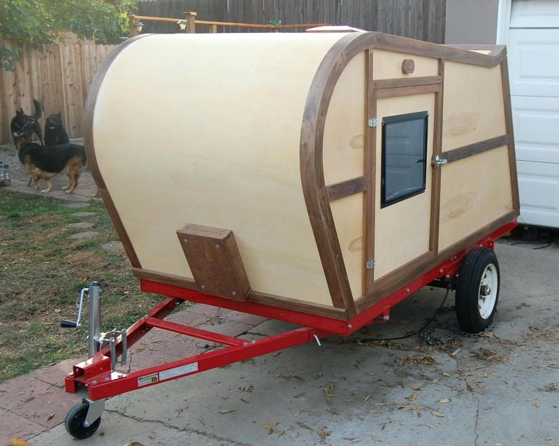

Plan C worked. I cut the trim to a thickness of 3/16" and it bent nicely without a need for steam. I won't build the trim up any thicker as I think it looks nice this way...and it cuts my work by two-thirds!
I also plugged all the screw holes on the side trim.

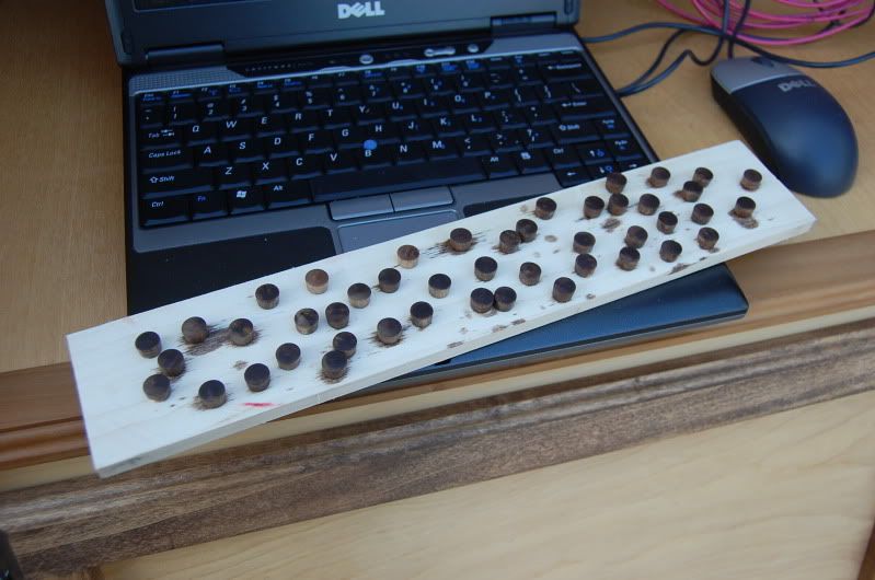

Yay! That one layer probably looks great all by itself yah. That just looks scary with all the plugs sitting on that laptop haha
Thomas
2bits
2bit Member
Posts: 5132
Location: Lake Tawakoni, TX
Postby green_eyed_diablito » Thu Nov 12, 2009 11:00 am
that does look scary (the plugs on the laptop). i stained them while sitting on the floor, and just put them up there to dry. that's my company's laptop and i can't afford to destroy ANOTHER one. i destroyed one last year in a motorcycle accident.

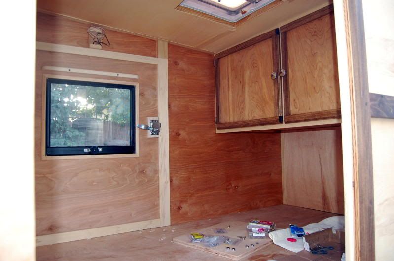

the hatch is insulated with 3/4" EPS. this shows part of the sandwich (before the interior skin was attached). off to the left you can see the exterior frame with a rabbet that the sandwich was put inside of.
here you can see that i goofed and ordered the hinge just a little too short. i ordered a 48" hinge, forgetting that the outside width of the tear is 49.5" - i will seal the gap with rubber weatherstripping.
i also finished the interior trim around the windows. the door skin is lighter than the walls because i have yet to seal it.

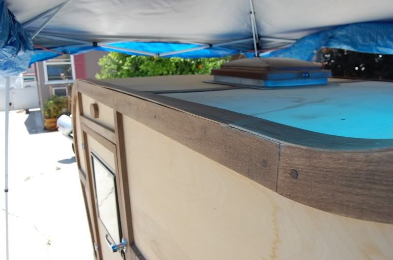

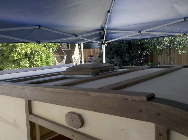

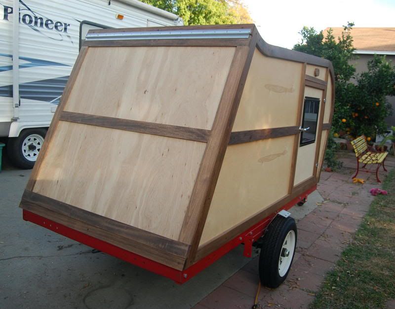

although the TD was covered (with a car cover and a blue tarp) for the last six months, the 1/8" thick trim on the roof managed to warp. the trim on the curved sections is fine (i attribute that to it being under constant tension on the curve).
i took off the warped trim and replaced it with 3/4" thick trim. i rabbeted each end of the new trim so that it overlapped the ends of the curved 1/8" trim - this gives me some assurance that it won't warp. although functional, i was not pleased with the look. the thicker trim looked like it was an afterthought, installed to cover a mistake. i decided to make a luggage rack so that the new thick pieces look like they belong.

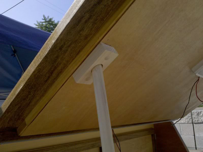

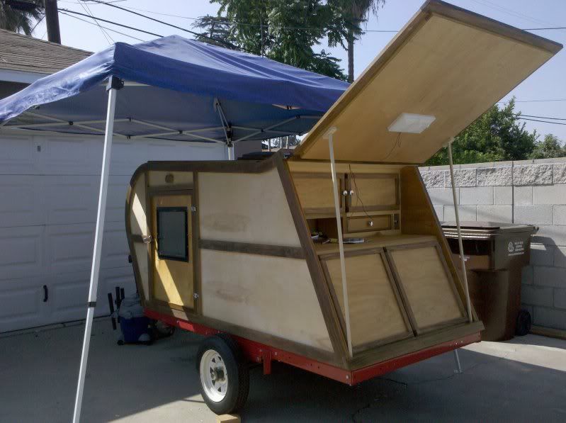

i have also figured out a simple way to support the hatch.
i made brackets to support the tops of the struts - the bottoms rest on the galley floor. i will varnish the brackets and struts to match the hatch.
