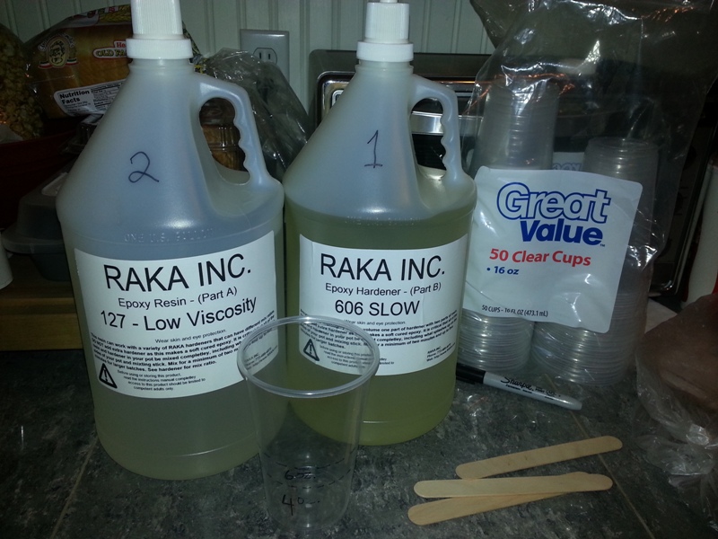

I started fiberglassing my first wall today. I am using epoxy from RAKA.
Here is a picture of the epoxy.

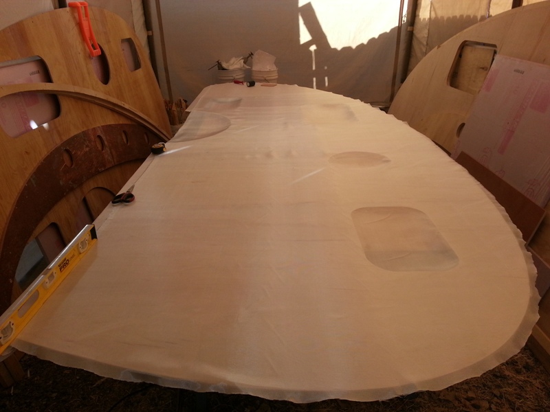

The fiberglass rolled out and ready.

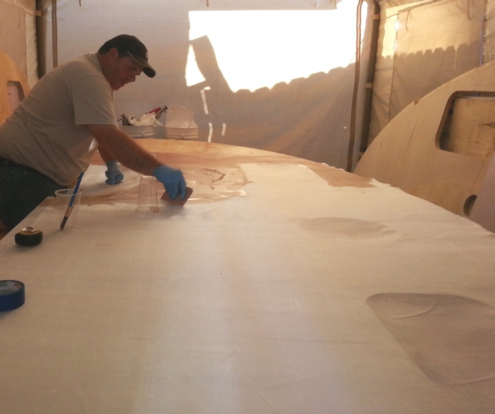

An action shot of me spreading the epoxy.

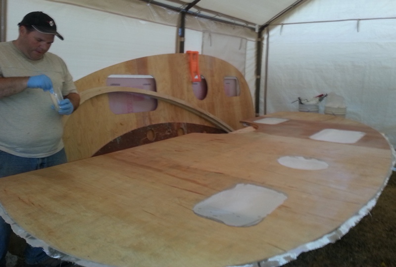

This is after I got the fiberglass wetted out.
So that is where I am for now. It is still wet so I do not know for sure how it will turn out, so far it looks ok.

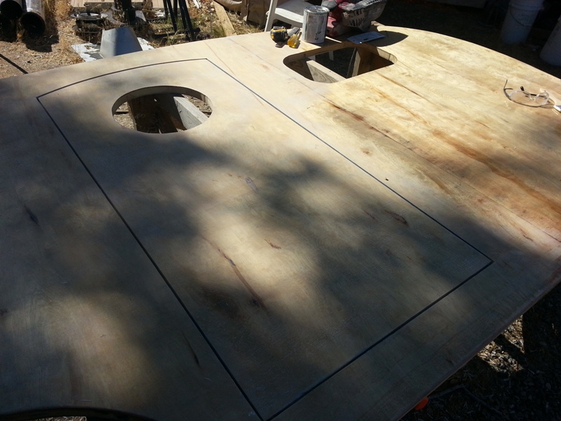

Got both walls fiberglassed. Got the door cut out and just about ready to start putting the walls on the floor.
Here is a picture of the door cut out.

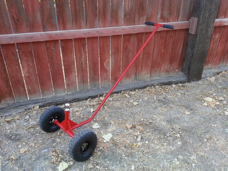

Since I will be having to move the trailer around I decided to build a trailer dolly to make it easier.
Dan

Postby Fishingtomatoseed » Thu Oct 18, 2012 2:05 am
Dan,
What was your process of cutting the door out?
Fishingtomatoseed
Posts: 261
Images: 9
Joined: Sun Aug 21, 2011 4:47 pm
Location: North Texas
Re: Modified 2+2 trolley top - Door cut out - page 7
Postby danlott » Thu Oct 18, 2012 5:56 am
Fishingtomatoseed wrote:Dan,
I was going to skip over that, since it did not go anything like I had planned. But since you asked I guess I will share.
I cut the door out of my side profile template. I then clamped the template to the wall. I used a router with a bit holder that holds 1/8" rotozip cutting bits. This is also how I cut the ledge along the top of my walls where the spars will set. I made multiple passes about 1/8" deep until I got all the way throught the thickness of the wall. It worked fairly well for cutting out the ledge, so I thought it would be ok for the door.
Well it did not go so well, not sure what was going wrong. The router bit wanted to keep drifting and the cut was pretty sloppy. I also broke all 4 bits that I had. After I broke the last bit I gave up on that process. I then decided to finishing cutting out the door with a jigsaw and clean up the edges with a belt sander.
I cut the dook out the rest of the way with the jigsaw. I thought all was ok until I removed the door and realized that the blade had drifted almost 3/16 of an inch is some spots. Note to self: DO NOT USE CHEAP JIGSAW BLADE FOR SOMETHING THIS IMPORTANT!!!!
To fix this I used bondo with fiberglass fibers to build up the areas on the door and the cutout. I then used a straight edge and router edge trim bit to trim the edges. On the curved part I just used a belt sander. I will also put fiberglass and epoxy over the edges.
Postby KCStudly » Thu Oct 18, 2012 11:59 am
Looks good, though. Nice straight lines and an even gap. :thumbsup:
Posts: 9617
Postby Fishingtomatoseed » Thu Oct 18, 2012 4:21 pm
KCStudly wrote:Looks good, though. Nice straight lines and an even gap. :thumbsup:
That's what I was thinking KC.
Dan. Looks great and thank you for sharing. So the bondo with fiberglass in it. Thanks for the tip.
