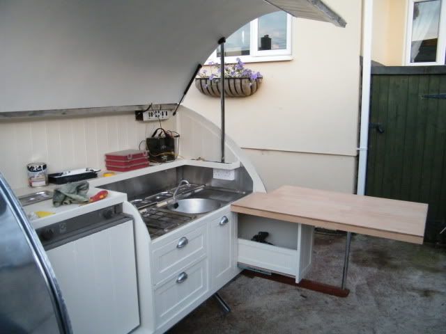

We've had a right busy summer with loads of fun trips. Thypods been great, but I wanted to get out int the new trailer before the weather changed.

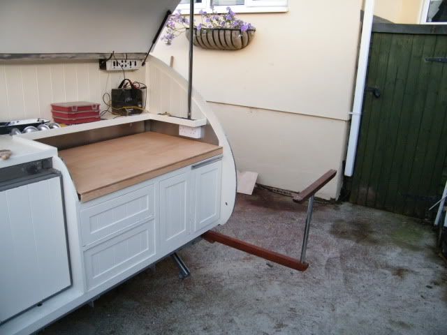

There wasn't too much more to do to be campable, and one of the things was the worktop.
I've used an internal door this time, and clad it in laminate. It's turned out a lot lighter than the one on Thypod, and almost as sturdy.

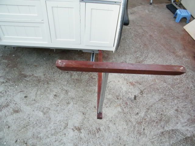

The mahogany sits into the chassis
It's got a hole recessed in it to take the chrome support, and a second mahogany timber that has a couple of dowels in to locat in the worktop. The worktop is an internal door, clad in a lamiate panel.
I've used some caravan window hinge to slide the top on
With the work-top in place, there's plenty of access for the box drawer to slide out under the top
Plenty of access for the sink too.
The chrome tube locates in a bit of shaped mahogany, to hold the hatch up (another of the jobs that needed doing)
I'm not sure the mix of light wood top and dark mahogany works .....I might have to paint over the supports :roll: :roll:
I've got around to putting the inner skin on the hatch. It's firmed things up a treat. I've had to box out the lower section to hide the back of the rear lights, and the bar lock . I've still got to close the ends off, but we're campable. I added a couple of strips of led lights that give a very blue light. :lol:

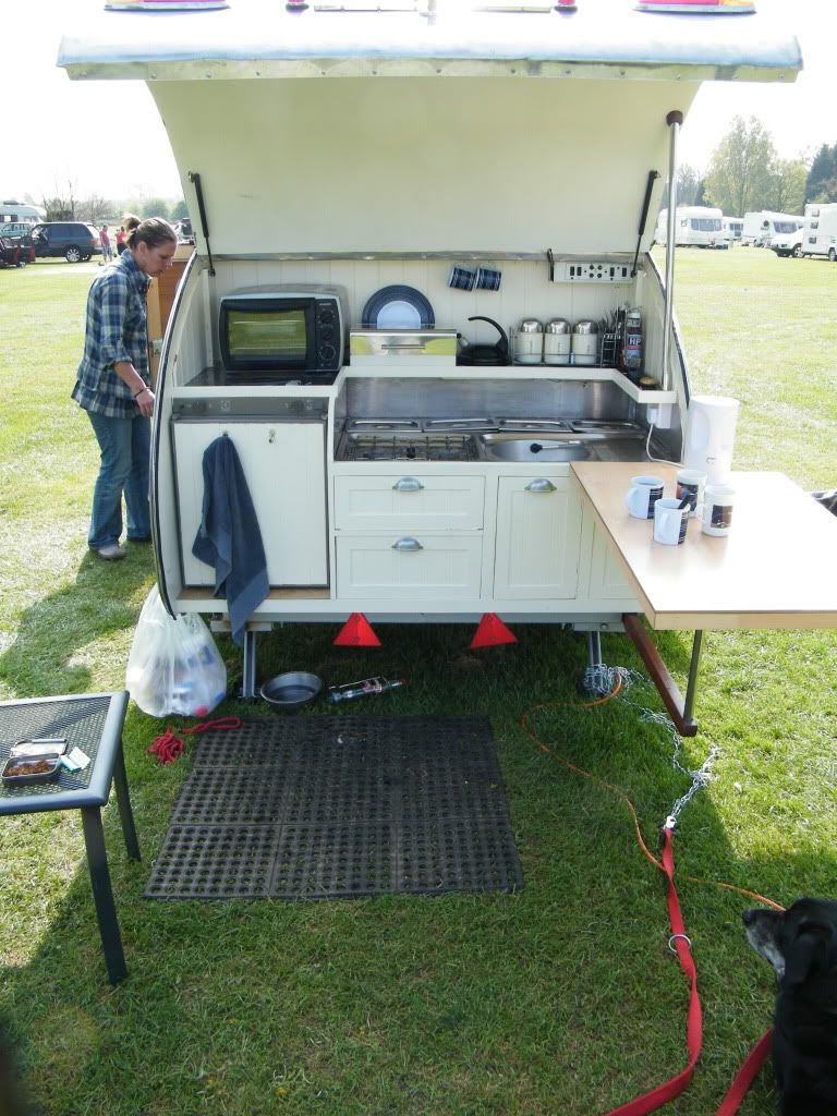

Postby jackdaw » Fri Sep 16, 2011 5:03 pm
We've been using the trailer for a year now, and all is well :D :D

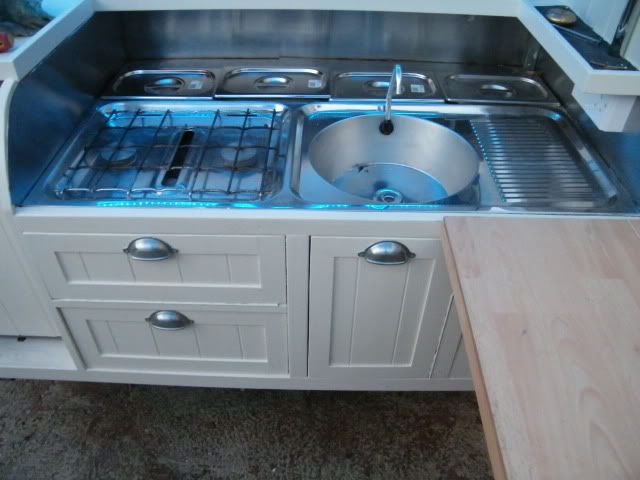

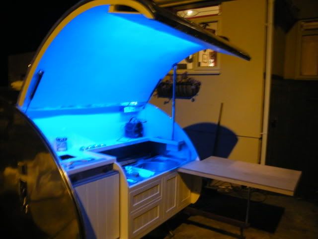

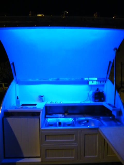

The galley has been fitted out with a bread bin , plate rack, oven , and all the necessities for a great trip.

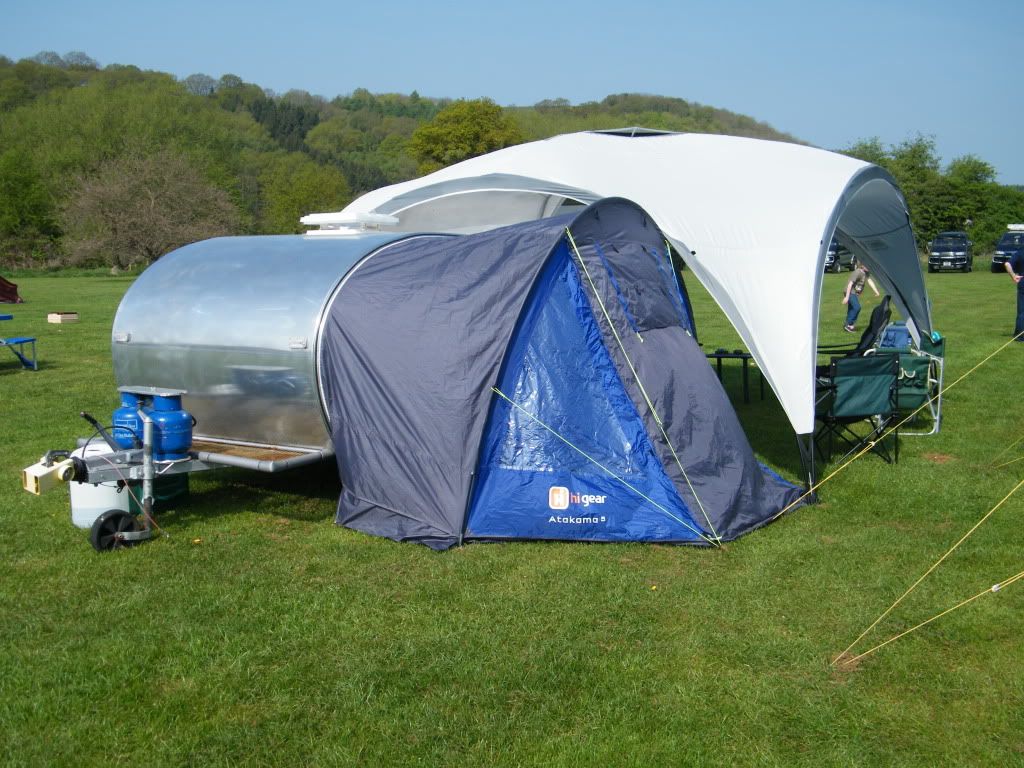

The side tent has been cut down, so it fits inside the event shelter. It has a door at the back so it connects the space from the trailer to the galley nicely
Sometimes we take Scooby with us on our trips, and he's been mostly happy sleeping in the side tent. About a month ago we went on a trip, and he got spooked with the thunder weather. We thought it best to let him sleep in with us.... but he insisted on taking up 1/3rd of the bed.

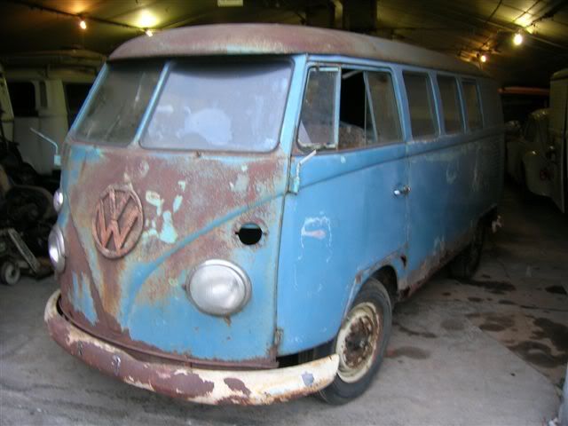

November 2010 we bought a new tug.... well it was new to us.....A 1964 VW split screen in poor shape....
It spent a year in the welders....had had the bottom 6" replaced, Loads of new metal was needed to make it good again.
This is how it looked in it's most bare shape
We finally got a solid shell back last Christmas, and have spent most of our time this year rebuilding it. Firstly preping it for paint which took ages....Then fitting it all up once we'd painted it. I'm happy with what we've done, and chuffed to bits with the end results....
