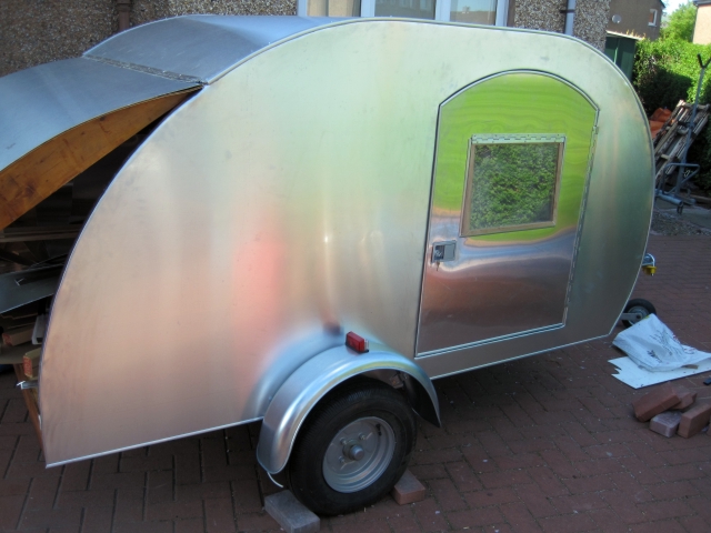

This weekend I have added the wheelarches...

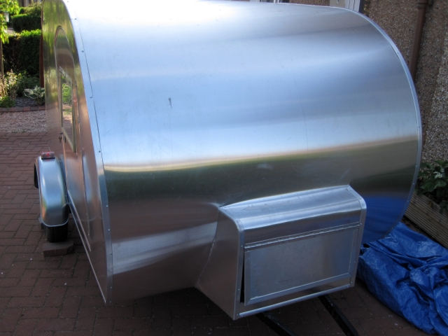

... and finished the battery box...

I cant believe how quick it has all come together Al. It looks off the shelf

Just great !!!

It looks really good!

Cool tongue box!
Does that flap flip up?
What will go in there?

Postby BigAl » Sun May 23, 2010 5:47 am
Thanks Guys!
The tongue box door flips up and will be secured at the bottom with some kind of hasp, latch or lock.
Right now it does not contain anything.
The floor of the trailer projects forward of the trailer below the tongue box giving two bolted anchor points further forward than they otherwise might have been. The idea is that this shortens the tongue even further.
The second immediate benefit is that it gives me a container to add tongue weight if required.
The longer term plan is that it will house a leisure battery, a charge controller and maybe some equipment to allow solar and wind charging.
Kind Regards, BigAl.

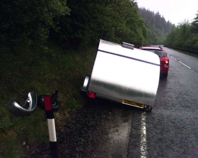

This weekend we took the trailer out for it's maiden voyage, and the weld holding on the stub axle parted company with the trailer whilst I was doing 50mph...
Other than almost ending in disaster, the trailer towed beautifully, being a credit to the designer.
You can read a bit more about the excitement in a separate thread here.

Thanks guys, I got the trailer home thanks to being a member of Autoaid, else the bill would have been 200 quid.
The trailer is going to be off the road until I get a repair plan figured out.
As odd as it seems, I regard that I was exceptionally lucky.

Postby es009d7705 » Wed Jul 21, 2010 3:00 pm
Hi Al, have not been on the forum for a bit, busy trying to get mine finished. I was shocked to see your photo of your mishap. I am glad that no one was hurt and that you managed to get it home. Hopefully you havent been put of teardrops for life. How did your girlfriend take it? Will you be able to get it fixed? It didnt look to bad in the photo apart from the wheel and bumper lying in the ditch. Hope to hear from you soon, Evan :pinktear:

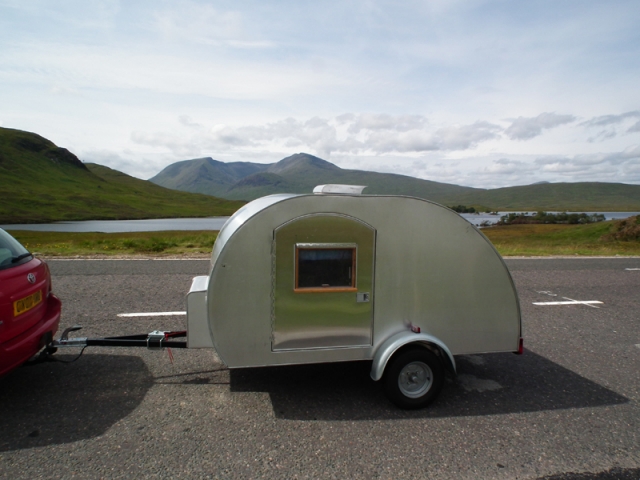

The refitting work has been done, myself and 'missus Big Al' took the trailer up to the West Highlands this weekend, on the exact same trip where last time the stub axle came off.
I am happy to report all is well. I did check the welds every time we stopped due to welding paranoia. Here is a picture of me giving the all clear having just checked the welds as we stopped on Rannoch Moor Summit (1142 feet)
and another without my big baw face ruining the shot.
We brought with us an inflatable tender and a 2.5hp Outboard. I did a bit of fishing from the tender and the Pollock were biting.
