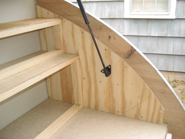

Postby Justin & Katy » Tue May 17, 2011 8:43 am
That looks pretty sharp. I was surprised at how easy they were to install. I do wish that they were mesh like yours so I could put smaller sutff in them. However, the drawers in the middle are seven inches deep so I think I'm going to have plenty of space to store stuff. I got quite a bit of the upper cabinets done this weekend as well. I just haven't posted any pictures yet. Most importantly though...I GOT THE SHOCKS INSTALLED ON THE HATCH! That means I no longer have to use 2x4's to prop it open! The best part is...no swiss cheese. I got them installed in the right place the first time. No extra holes. One problem I did run into was the fact that I used half inch ply for the walls of the trailer. I was really wanting to cut out any excess weight I could in the build. As a reuslt, the galley walls are thin and I was really afraid that the the strain form the shocks would eventually pull the screws out of the half inch plywood. I went ahead and reinforced the galley wall with another layer of half inch. Now I have no worries about them staying in place. You'll see what I'm talking about when I post the pictures.

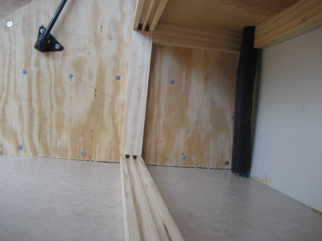

Postby Justin & Katy » Tue May 17, 2011 6:31 pm
Here are the pics of the recent work.
This is a picture of the grooves that will allow for sliding doors.

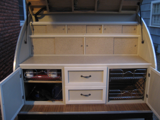

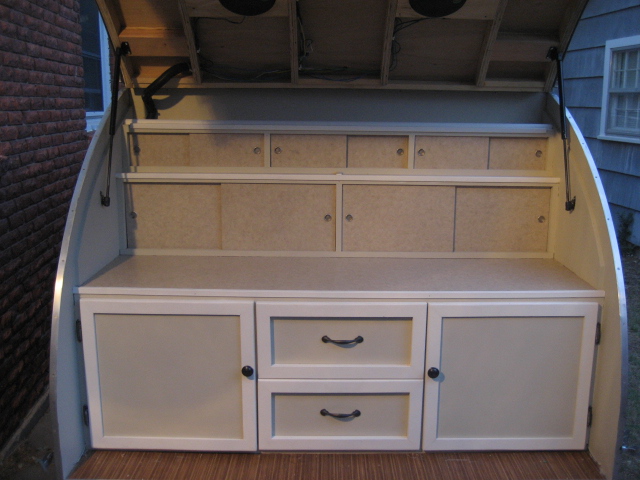

Postby Justin & Katy » Wed Jun 08, 2011 9:23 pm
Here are pictures of our finished galley.

Postby oregonguy » Wed Jun 08, 2011 9:48 pm
Looks really nice. You do good work. :thumbsup:
