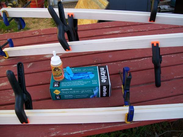

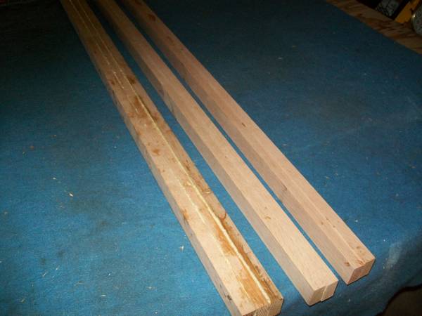

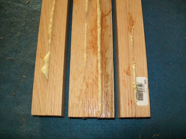

Hey all: I got some of the spars laminated with Gorilla Glue last night & this morning. The ones pictured below are Poplar doubles for regular spars in low load bearing applications.
These in the next two pics are the doubled up spars for front overhead cabinets and the triple one is for the hatch These are all oak.

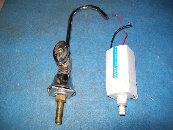

I picked up this faucet that needs a good cleaning and a water pump from Mr. RV yesterday as well as a converter, but I need to take it back and exchange it. This one doesn't have a battery charger in it. I might just get a Battery Tender Plus instead of using a converter.

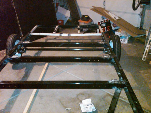

Hi everyone: I didn't get much done on my TD over the last two weeks. I helped Pam M. last weekend redo her chassis extension that was screwed up by someone that had no idea of what he was doing. Our work turned out much better than what was done by him. You will find her build at the link below.
http://www.tnttt.com/viewtopic.php?t=36407
This is what was done to Pam's frame before I saw it. Look at that "BOW" in the middle of the cross member. It was a hack job.
Here is me doing another hack job. Now, wait, this hack job is for the greater cause. It gets better.
See, I told you so. This is just a "little" better fabrication. Do you like the before or the after pics ??? Pam has a nice rear end. Ah, come on guys, get your minds out of the gutter. I mean her trailer's "rear end". :lol:

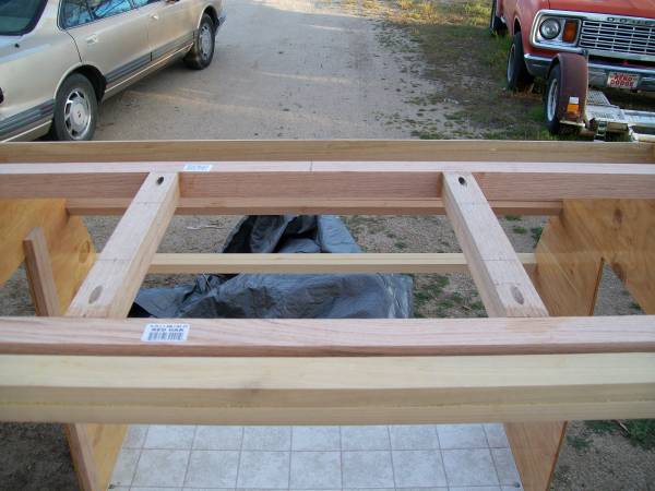

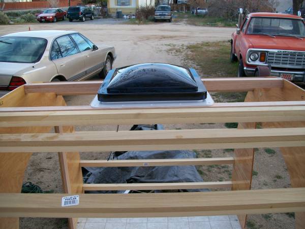

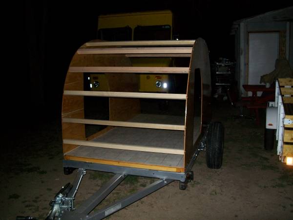

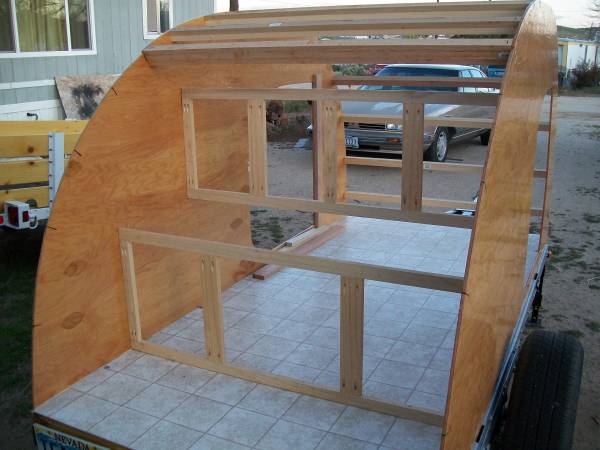

OK, on to my TD. I got the 1 1/2" x 1 1/2" spars (using two 1x2s) glued up with Gorilla Glue this week using poplar and oak. I was able to install them on the "Silver Nugget" this evening. I still need to install the two spars for the fantastic vent that I do not have yet. I have the spars made up and I will add them later on.
You can see that I used oak triples laminated for the hatch spar. I also used oak doubles for the front upper cabinets. I want these locations to be able to hold up for the hinges continuos opening and closings of the hatch & cabinet doors.

You are right he did use used scrap crap that was way to flimsy for this use. I needed to get rid of the old cobbled up extension so I leaned it up against my storage unit door when I left for the night and you know what? Someone stoled it, I hope they took it in for scrap like what should of happened to it in the first place. That was what I was hoping for, yes !!! :thinking:

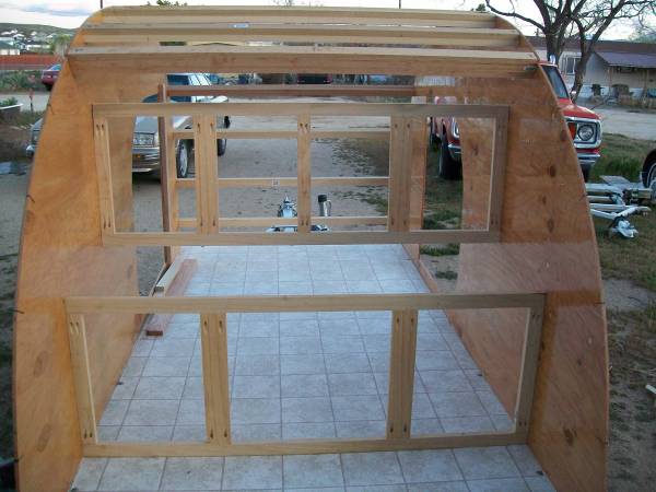

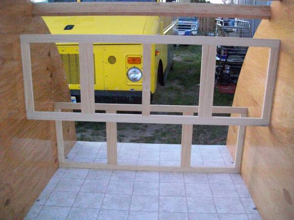

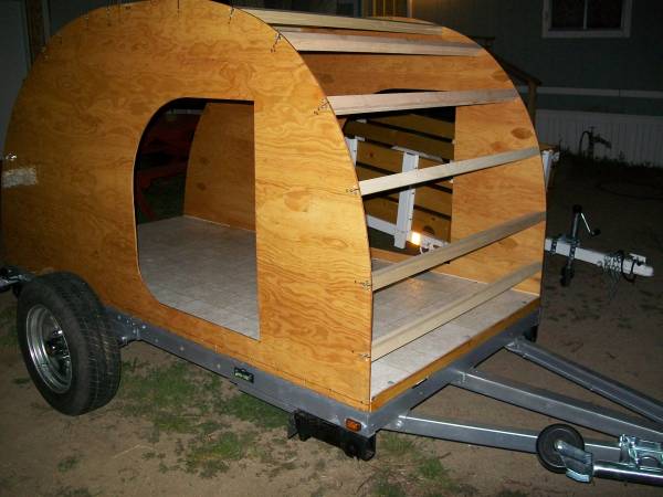

I made up the bulkheads for the cabinets to the same width as the floor (47 1/4") and the walls are bowed out some where the upper bulkhead is to attach to the walls. Good thing I can pull the walls in to place against the bulkheads with glue & screws. I didn't think of the door inserts warping and I just had them leaning up against the wall in my spare bedroom. Right after I read your post, I laid them flat on the floor and placed a thick piece of plywood and some weight on the sandwiched pieces to keep all of it flat. Thanks for that tip. It is the people with your experience that helps us first time builders. :oops:

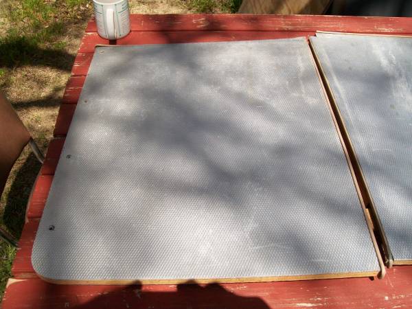

On Saturday, Pam & I went to Mr. RV (that is what I call him) and got a bunch of stuff out of a pick-up camper from 1968 and I got some cool small diamond textured aluminum panels that were inside used as trim. I will use these two panels inside my TD somewhere. I don't know where yet but stay tuned. We got some counter face trim of aluminum and a great piece of aluminum used to hang your clothes hangers on. I will post pictures of this stuff as soon as I can take some pics. Pam got a nice SS sink and a hand water pump from it, too. We removed the appliances for Mr. RV since he is 84 years old and he gave us a good deal on the parts we got for our builds. Remember, if you help people out they will think highly of you and then they might give you a deal. It only took us a little extra time to pull the appliances. ;)

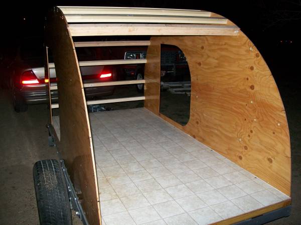

Update Update Update: Hi everyone: I went to HD today and I got the ply for the inside roof and I got some oak 1/4" ply for the walls. I picked up more wall stud material of pine 1x2s.

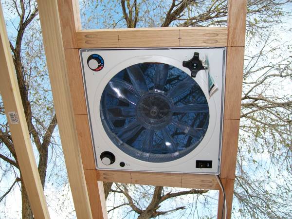

I was able to frame up the Fantastic fan roof vent oak double spars and attach them to the walls. I am still waiting for my fan and I borrowed Pam M's fan to frame out the opening for mine since we both are using the same fan. I used my Kreg Jig to attach the braces between the two oak double spars. I used three screws as well as PL Premium construction adhesive at the joints. There is one screw on the top of the fan frame and two from the bottom side. "Overbuild" rears it's ugly head again.
Here is a couple of pics of the aluminum trim panels Pam and I got last week-end from a 1968 cabover pick-up truck camper. It is really cool looking. I will use the back side since it is still like new except for the contact cement on it. It should clean up just fine with some acetone. When I use it in my build, it will have the reverse pattern as that which is shown in my pics since it will be flipped over so you will be seeing the bottom then. The pieces I have are 18" x 24". Maybe cabinet door panels ???
Isn't that cool???

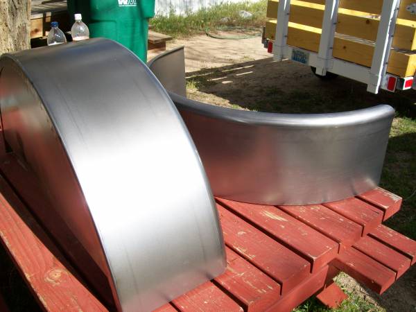

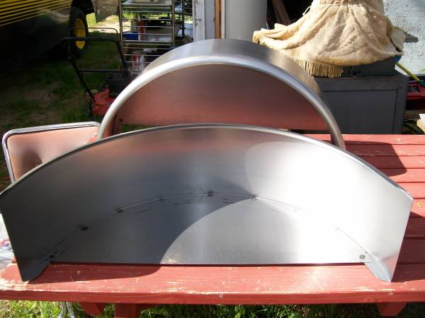

I picked up my fenders yesterday from a local trailer shop, (Kro-Built). They are for 14" & 15" wheels and measure 9" wide by 32" long and 15" high. $17.50 each. They have the back skirts pre installed. I am using 14" wheels & tires. There is less road spray going to be deposited on the sides of the TD. I will paint them to match the frame. I would like to coat them with Line X or something like that so sand and rocks don't rip the paint off the leading edge of the fenders and then have them rust up. I hate when that happens. Do you guys know what product I can use and still be able to paint over it? The guy at the trailer shop said they make color matched stuff I could use but I want it to match my frame's color. That is why I want to paint them after the bed liner goes on.
Any suggestions ??? 8)
