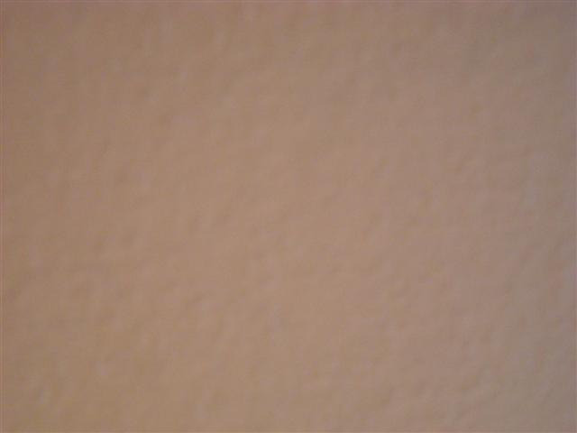

Here is the side with one coat of paint.

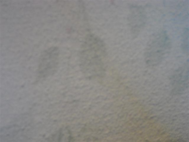

you can still see the pattern in the bed sheet this time.
Here is the other side with two coats of paint.

RAYVILLIAN wrote:Nathan
I use latex exterior primer to put the bed sheet on with than seal it with a oil base porch enamel. When I'm done with the bed sheet I'm usually covered with paint Well not covered but I usually have some on me and latex is alot easier to get off.
Gary
RAYVILLIAN wrote:Starleen that's a good question and the answer is a bit of a story.
I first saw it up close at LCG 1 and the fellow that had done it told me that when he was young they would use the method to waterproof boats. That got me to thinking about things that I've seen and read about. I once saw a kayak that was cloth stretched over a frame and waterproofed with paint and read about using canvas and paint to waterproof roofs as a cheap roofing.
As anyone that has seen the Winter Warrior up close knows I have one sheet of plywood that keeps cracking. It doesn't delam it just cracks and I have to repair and paint it every couple of years. I thought of using this to try to fix that problem but haven't gotten it done yet. But I used it on the cover for my AC and after 3 years of water and road grime being kicked up on it there is no delam or cracks at all. Soooo to make a long story shorter I decided to take the leap of faith and to a do whole trailer this way. I hope it stands up to the elements as well as the AC cover has, but only time will tell and what is done is done. I'm actually 99% sure that it will work.
I know that I could have went with fiberglass and epoxy but as anyone that has done it knows the fiberglass isn't cheap and takes alot of work filling and sanding. Buying bedsheets from second hand stores and garage sales a lot cheaper and latex paint is alot easier to work with. I did hedge my bet by sealing the wood with epoxy first though.
