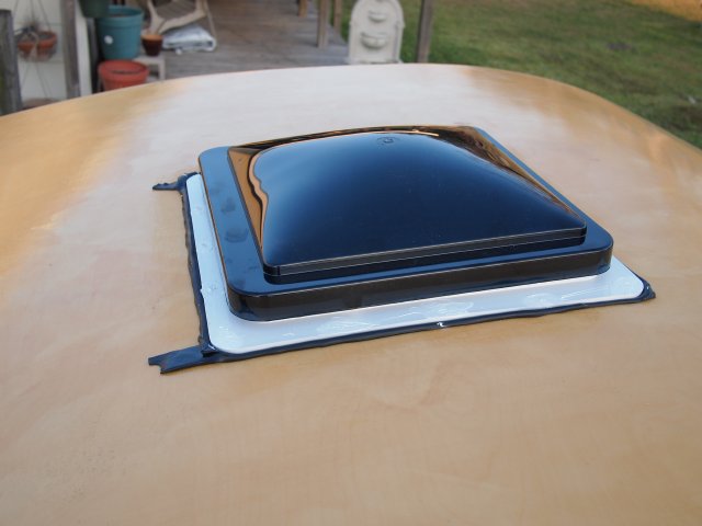

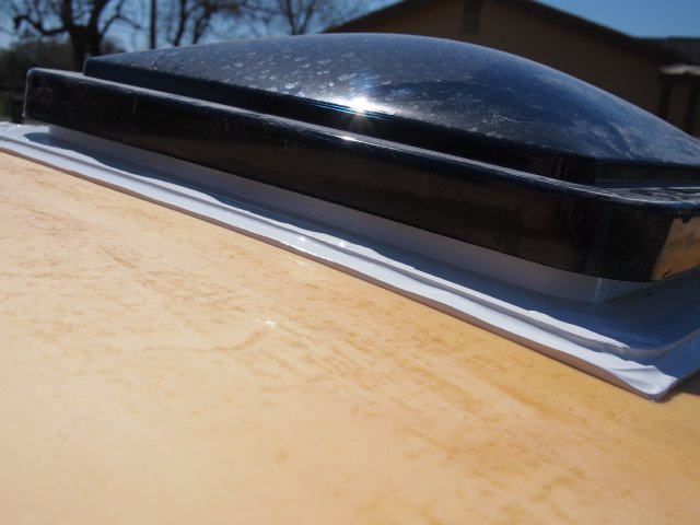

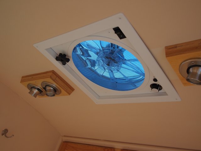

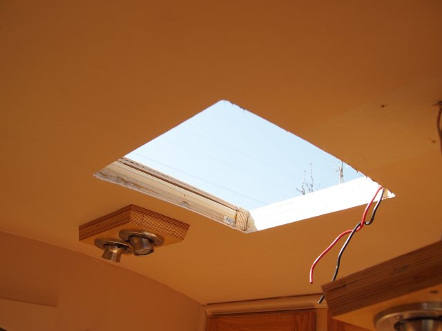

Well we took the tear to Inks Lake a couple of weeks ago, and it was cool outside, cool inside, and just too darn muggy inside. I decided it was time to install a fan. As luck would have it, the fan was on sale for $123, so I jumped on that. Using a router flush cut bit I cut out the hole for the fan.
I epoxied the inside of the hole(no pics), and layed down some butyl tape and screwed down the fan. Then I pulled out each screw, squeezed in some sika-flex 221 into each hole and reinstalled.

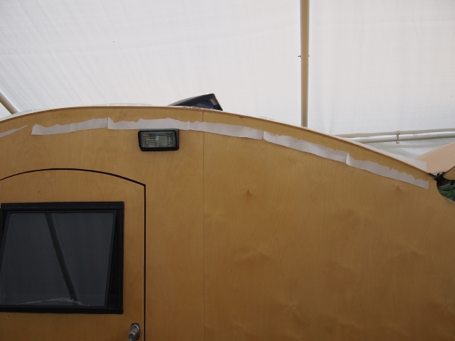

I then waited several days, then I cut off the excess butyl, taped 3/8 inch around hole, layed down a thick layer of sika-flex 715, and removed tape before it started drying.
And here is the inside all done.
Looking forward to our next outing.. 9 so far....

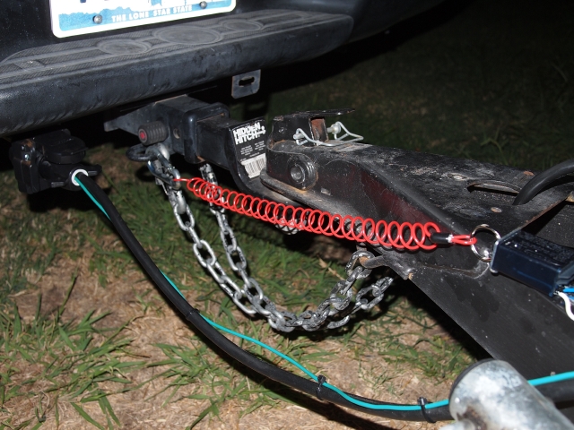

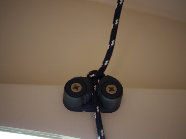

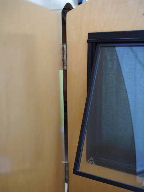

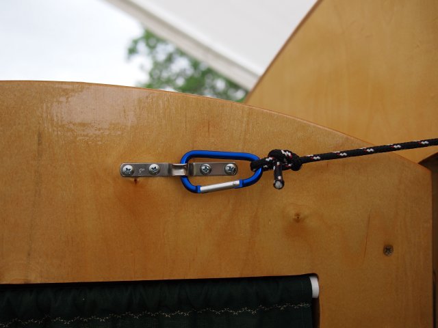

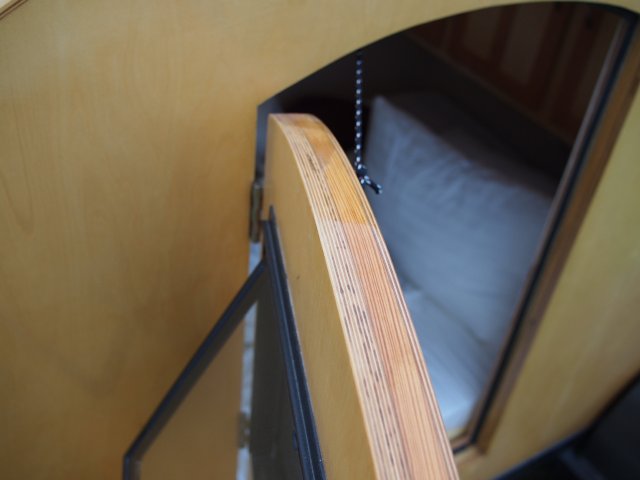

Well, the crank-out windows, it has been nice not to worry about closing during the rain, but sooner or later a wind will catch the door and..
So after a trip to West Marine, this is what I came up with for a solution. Here is the Door side
On the inside, I mounted a small C-Cleat Cam, the harder you pull the tighter it gets. I don't really need the knot to hold, I just don't have to figure where to adjust each time.
Now with the door open it will stop short of hitting the side with the window wide open
Now I can sleep better knowing that when I open the door I wont be cursing and staring at the side of the trailer all day...

Postby aggie79 » Mon May 02, 2011 8:18 am
Alan,
Thank you for posting the details of your door "limiter". I need to make these for my teardrop, but was having trouble coming up with a simple but sound design like your design. I'll probably duplicate this if this is okay with you.

Postby Alan and Lianna » Mon May 02, 2011 11:09 pm
Alan,
Tom, do it quickly before the damage. Not only will it mess up the side, it also bends the window and makes it more difficult to open and close.

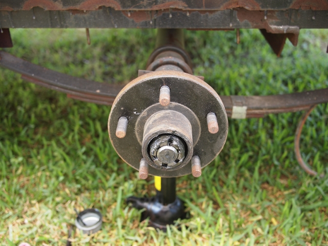

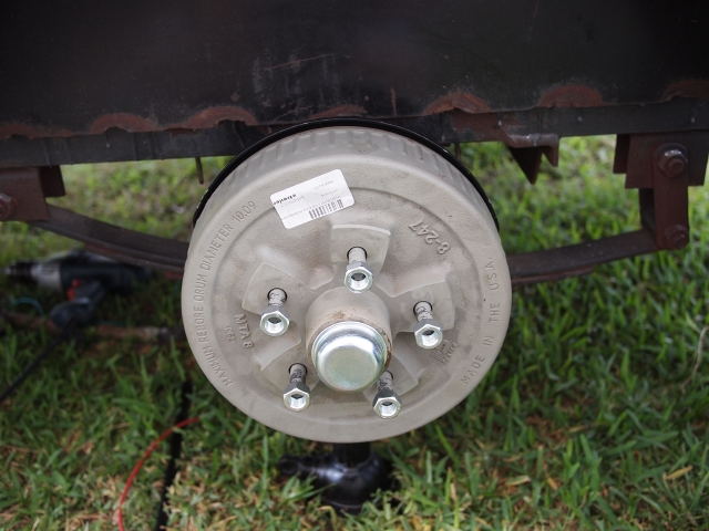

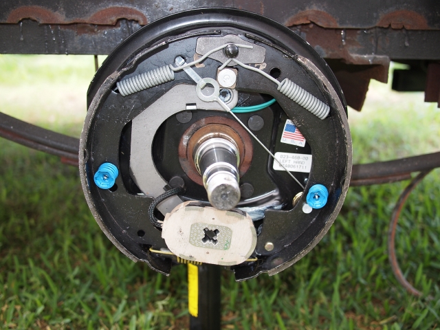

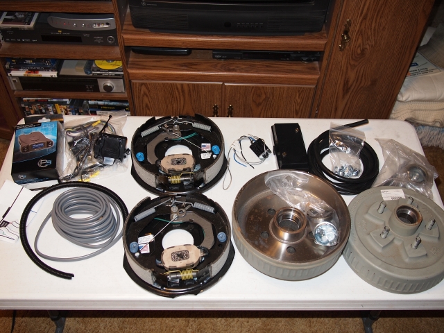

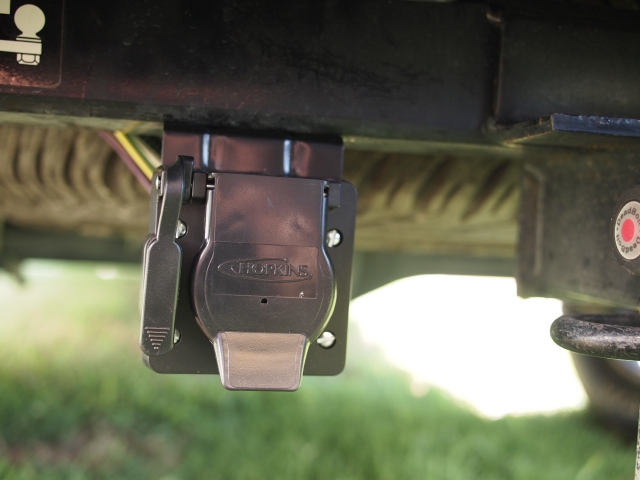

Since our trailer weighed in at over 2000 lbs, we decided to install a brake system that would be legal in all states. I ordered everything I would need for the install from etrailer
I removed the old hub
Installed the new Brake Assembly
Packed the new bearings and installed the new drum

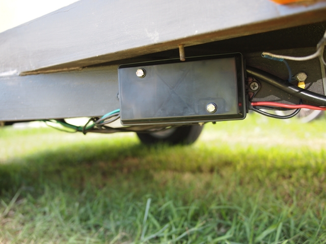

Wired everything to this new terminal box

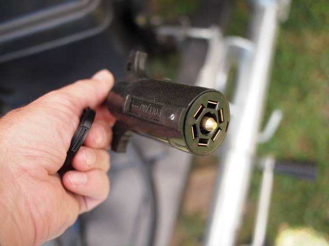

Installed a new 7 & 4 way receptacle on the truck
And a new Plug on the trailer

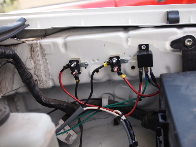

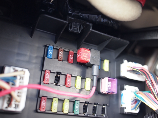

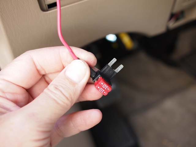

In the engine compartment, I installed two circuit breakers and a relay, one breaker is in line with the Brake Controller, and the other is in line with contact side of the relay, to charge the tow battery while driving.

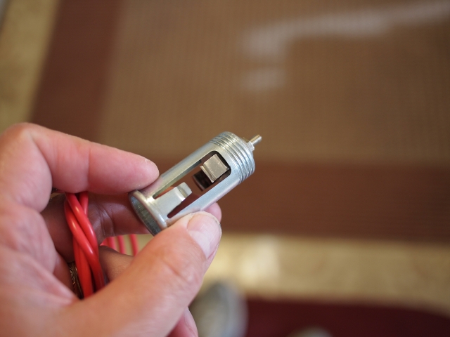

To control the relay I used this add a circuit adapter to connect to a circuit that is only hot when the key is on.
The Aux circuit

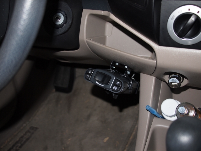

I installed the P3 Brake Controller on the dash

Postby bdosborn » Mon Sep 12, 2011 7:20 pm
What a lovely, elegant solution! Where did you get the cleat?
You'll love the P3 controller. I just upgraded from a Voyager to the P3 and its *MUCH* better. Set it once and forget it. I run it at 5.8 and B1 on my trailer.

Postby Alan and Lianna » Mon Sep 12, 2011 7:53 pm
Found it at West Marine, a boat supply house

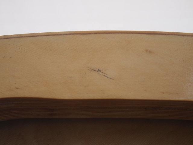

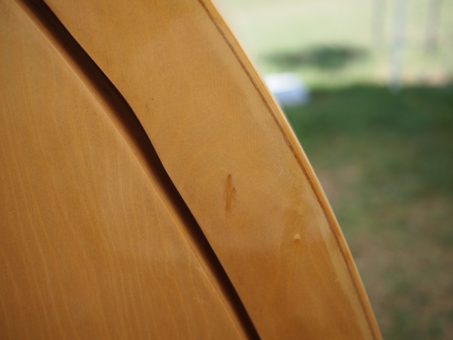

Well, after sitting outside for a year, we had a couple spots of minor water damage
I ground out the damage with my dremel and filled it with epoxy mixed with wood flour
Re-fiberglassed the top edge
After 3 coats of epoxy, sanding, and 2 coats of varnish, were looking good again

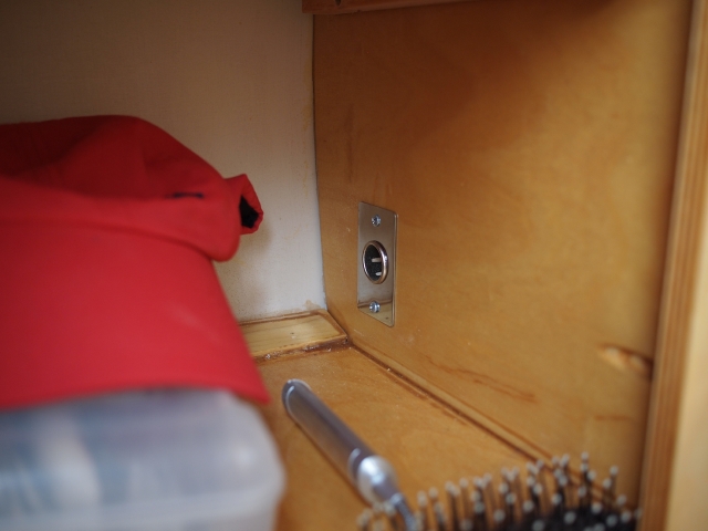

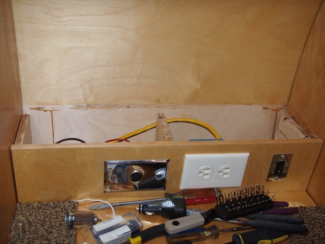

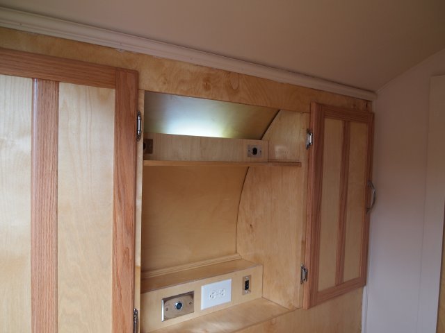

We had a 12v receptacle that would occasionally short out when something was plugged in, so I had to tear out this cover to get to the wiring
Found the source of the short

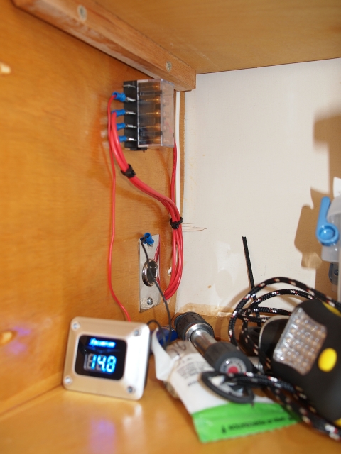

Replaced that outlet and installed a couple of new outlets inside the cabinets, so we could have devices on charge and not out in the open.
In this side, I also installed a fuse block, so each outlet would be on its own fuse. I haven't decided where to mount the 12v meter yet.

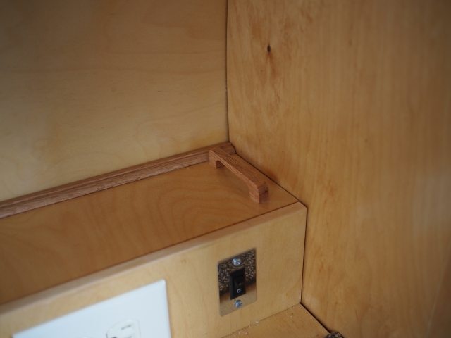

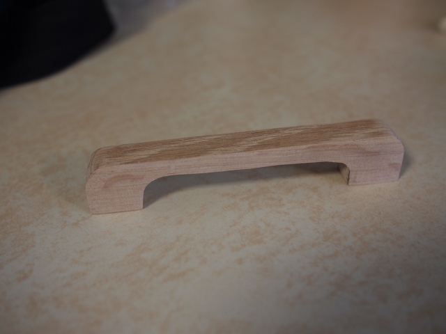

To repair the torn out panel, I decided to make a couple of handles out of some scrap wood.
After the scroll saw and some sanding
Assembled, epoxied and installed

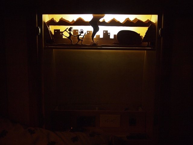

We had installed this light and 2 12v outlets last year, but was never quite satisfied with it,
So we built something new, here is the wedge I cut to mount the light too
And here it is mounted
With the light on
and at night, (it appears much brighter in the picture)
