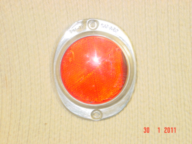

Did some small cleaning and polishing this evening. Cold outside so cant do much but all kinds of little things yet needed to be done. On the back of one of the tears I found a reflector and I thought I had to clean and polish it up since I didnt know what era it was from .. well after its nearly repolished to a good shine I googled the info on the reflector and to my surprise it was not an oldtime piece of nostalgia :cry: :cry: But ok I never saw such of a reflector here so its unique in a small sense.
I,ll install it back where it was. A new one costs about a greenback dollar. :lol:
Take a look see here. This is what it is. It was on the galley hatch under the back light :?

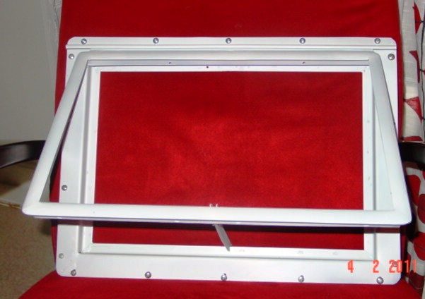

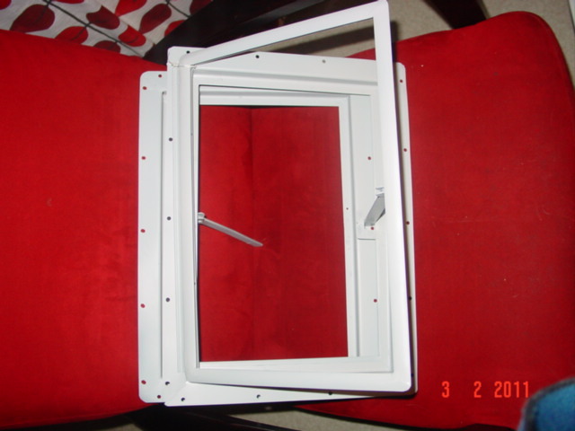

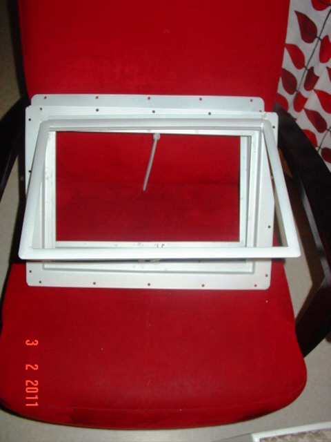

Here are just a few pics in case some are interested whats happening to the California Kits here in Finland. These are the only known Kit tears in all of Europe and Scandinavia thus far. So these must be restored or redone with quality in mind each step of the way. ;)

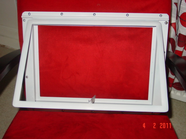

The window frames were bead blasted and rewelded where needed and primer painted. The color most likely will be a Candy Apple Red. :thinking: Im real glad I took the time to restore these. Even though I do have windows from Grant .. ;) These will also receive new seals as well. Will certainly look vintage and brand new. :D
I forgot to mention that these windows are 2 parts. They have a single hinge on one side welded and the other free that bolts onto the main frame to hold them together. These were frozen tight from rust. And it did take a lot of soaking in rust remover to get them apart. But got it done and they open and shut as new now. I have more pics of that too and I,ll post more in an hour or so. :P :pictures:

Postby Classic Finn » Thu Feb 03, 2011 5:40 pm
Here,s another pic of the frames and hinge back on. :) The new glass will have a slight smoke tint to it. All Marine Purpose Stainless screws will be used to mount the windows back on.

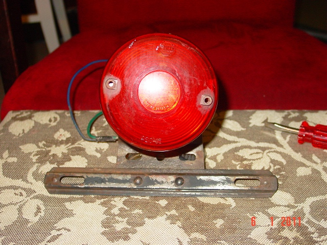

Postby Classic Finn » Thu Feb 03, 2011 5:52 pm
Stay tuned for the restored brake light pics coming shortly. :D Including the restore of the light lens ;)
Here,s a (before pic)

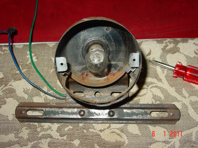

Postby Classic Finn » Sat Feb 12, 2011 1:51 pm
Classic Finn wrote:Stay tuned for the restored brake light pics coming shortly. :D Including the restore of the light lens ;)
Question there are 2 wires on this light, is this a brake and park light? Im trying to find similar wiring and light bulb here and is this 6 volt ?
Classic Finn
Midnight Sun Voyager
Posts: 17488
Images: 146
Location: Country of Finland
Postby Shane » Sat Feb 12, 2011 3:07 pm
Hello Heikki
Nice project you got going.
I think that the 2 wires are one for the taillight and the other for Stop/turn light. It needs to be in contact with the ground via the body.
