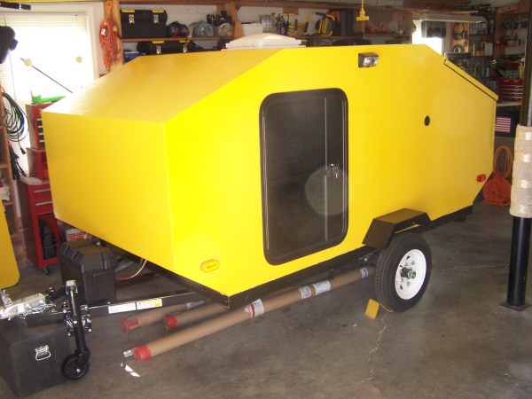

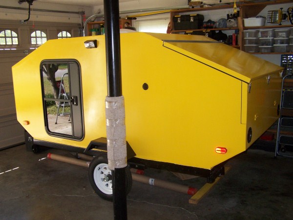

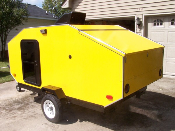

Been traveling for the past two weeks so I just got back to working on the weekender today. Almost there. Doors installed today and vinyl insert edge trim starts tomorrow. I feel a camping trip coming on soon.

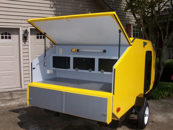

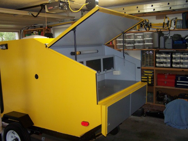

OK, today is the day that I declare victory (almost). Everything is done except for a few very minor details. The wife is out looking for stuff now for our test run next week (she's decorating the interior). We've decided to go "yamping" next week just to be on the safe side. Because of the colors, we decided to name it the "Super Bee" like in the old Dodge cars so the only thing left to do is a couple of Super Bee decals that I ordered today on Ebay. Next up will be a real run with some camping friends to Devil's Fork in upstate South Carolina in two weeks. I'll be posting some pics of the real deal with lessons learned after we check it out completely.

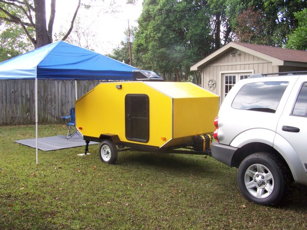

Postby les45 » Sun Oct 14, 2012 2:40 pm

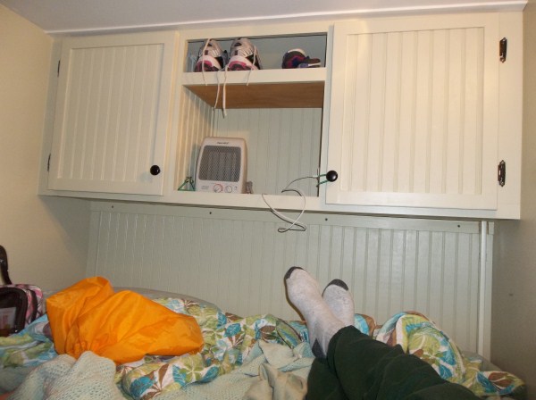

Did a trial run yesterday in preparation for our first real camping trip next week. Drove the weekender for the first time about 20 miles at speed and found a few little trailer issues that I have to work on (see my post yesterday at Trailer & Chassis Secrets). "Yamped" out in the back yard last night and everything worked perfectly. Hardest part of the whole thing was getting the EZ-Up up for the first time (bad instructions). Slept like a log on the memory foam topper. Can't wait to get to the mountains on Friday.

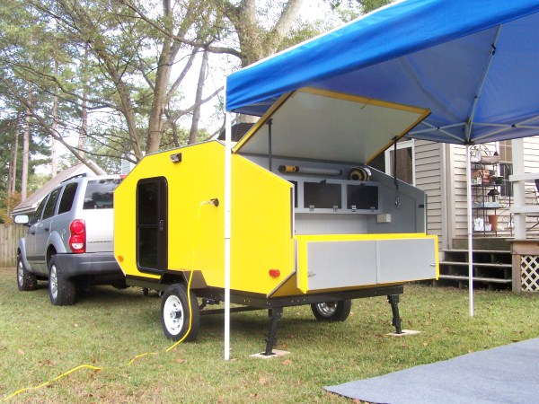

Postby les45 » Mon Oct 22, 2012 6:09 am

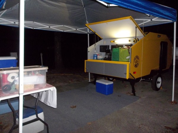

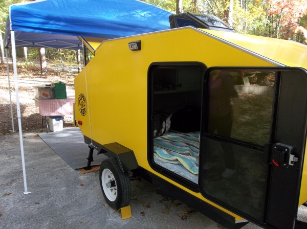

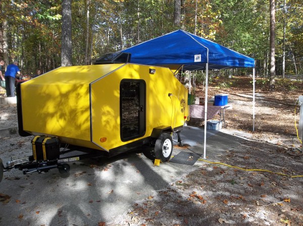

We finally made our first real camping trip this weekend to the mountains of South Carolina. We also gave the weekender an official name, the "Super Bee". Everyone kept making the comparison to bees because of the yellow and black paint scheme (and no we are not Georgia Tech fans) so I decided to go with the old Dodge Super Bee logo. A couple of decals from Ebay made it official. The Super Bee worked like a charm with just a very few issues. I had posted previously in the Trailers and Chassis section about a jittery ride on an earlier trial run. Most of that was eliminated when I filled the cabin with all our camping stuff to get more tongue weight and I bought a new drop hitch to lower the trailer to dead level. Still just a little bit of road feedback, but I attribute that to the heavy springs on the 2,000 lb NT trailer and the high pressures (48 lb) in the 12" tires. I plan to move up to 13" tires in the near future. We experienced only one minor technical hitch when one of the interior cabin lights quit working on the second day. It's on a circuit with an adjacent porch light that was still working so I'm thinking it is just a loose wire connection. The only real lesson learned had to do with adding a door stop/bumper pad to the manufactured doors to keep them from banging the side walls when opened. Temps were in the low 40's and we took some advice that I had seen on other postings on heating the cabin. We took a small ceramic heater and turned it on low for about an hour before bedtime. We turned it off when we went to bed and just added layers of cover during the night. With a sheet, thermal blanket, and thin quilt topper we were comfy all night. One of the highlights of the trip was meeting up with CliffinGA and his lovely wife. They were camping their Red Woof Inn at a nearby park and made the side trip to our campsite to see the Super Bee and talk teardrops. Really nice to meet Cliff after all the online chatting over the past year.
