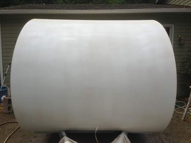

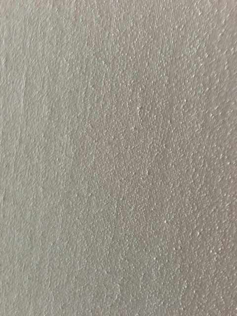

Primered the trailer yesterday, now to sand for a nice finish. I used a produce from Rodda Paint called First Coat. Basic Use First Coat is a fast drying pigmented acrylic emulsion coating designed for use as a prime coat on exterior/interior surfaces. Salesman said it is sand-able after 6 hours. Even though I put a coat of TB2 over the muslin there was still fibers giving a rough appearance. These pics are after one light coat, I did a second coat after this.

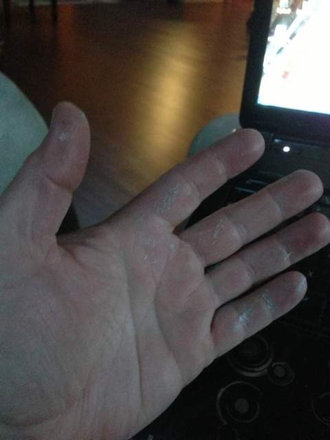

This was after scrubbing my hands. Even though it is water based it does not clean up well at the end of the day!

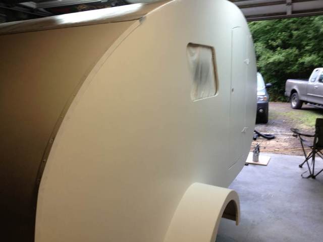

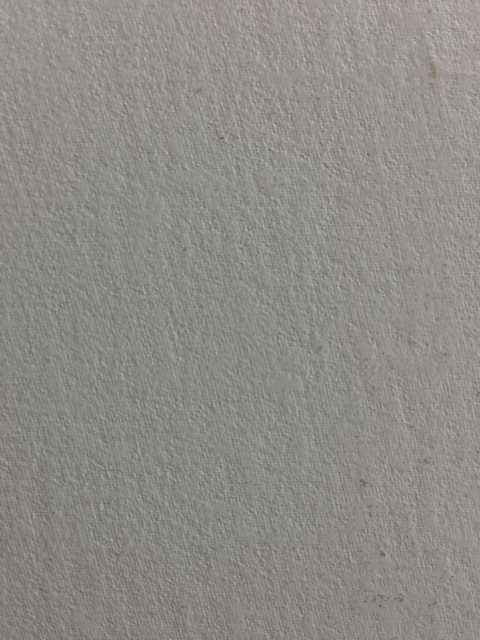

Postby Fyddler » Tue Jun 18, 2013 10:50 pm
Sanding, sanding, and more sanding. Even with the top coat of glue there was a lot of fuzz that I didn't see, primer coat feels like sandpaper. Knocking all the roughness off with 220 grit by hand.
Before sanding:

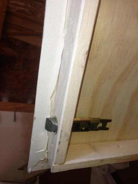

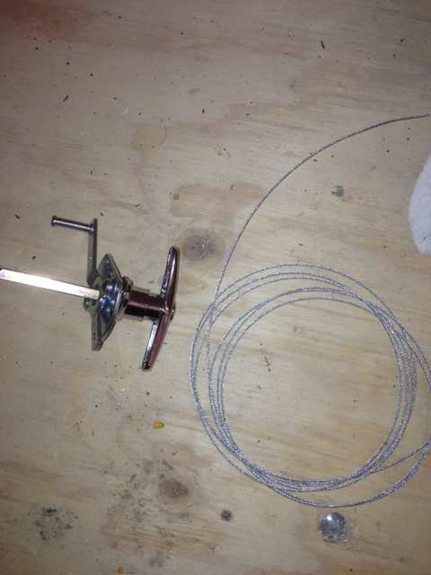

I have been thinking about how to latch the rear hatch for quite some time. I really want a single T handle but was not sure how to go from the T handle to the side walls. I considered using a round bar, but because of the lateral movement of the bars at the handle I would have had to route long cuts in my ribs.
I was starring at door knobs yesterday and saw just the door latch mechanism for sale and a light bulb went off! I am going to use two door latches, one on each side, and connect using a cable to the T handle in the center. The only issue I see with this is the possibility of the cable breaking some day, but if that ever happens my rear lights are 6" away from each latch, all I would have to do is pull the light, and manually unlatch.

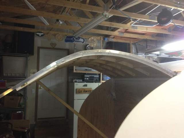

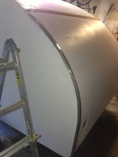

Postby Fyddler » Sat Jun 22, 2013 8:20 pm
So far this is the most frustrating part of my build... Annealing and bending aluminum trim for my hatch. First attempt melted the aluminum in half. Second attempt a bit better, but look so so, pics later (if I can bear the embarrassment!
To err is human, to really foul up requires a computer

Postby Fyddler » Sat Jun 22, 2013 8:46 pm
keep reminding myself looks great from 20' away!

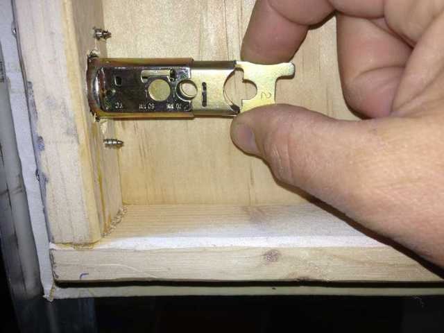

Postby Fyddler » Sun Jun 23, 2013 10:54 am
I used an interior door latch. No turning required, just a pull. I just looked at an exterior door latch and it looks a bit more complicated. I pulled on the mechanism and the latch didn't retract.
I also used a cut off wheel to remove the back end of the case around the l slide so I didn't have to fish the cable or have anything for the cable to rub on.

Postby Fyddler » Sun Jun 23, 2013 11:01 am
My fingers are showing the portion I cut off. I haven't actually hooked up the cables yet. My handle is about 5" higher than the latches, I plan on putting an aluminum sleeve in one of my ribs where the cable will come thru at an angle to give it something to ride on besides wood. I'll post more pics when I get it finished. Also, now that I have the strike plates adjusted better (had to move them out from the wall a bit to get a good hold) they hold real well, and am glad that they will be accessible from my tail light holes if I ever have any issues.

Postby Fyddler » Sun Jun 23, 2013 11:04 am
Had better luck with my second hatch trim. It helped to not try and anneal the aluminum in the sun! It was later in the evening and I could see the flame turning orange much easier. Still not perfect but way better than the first side!

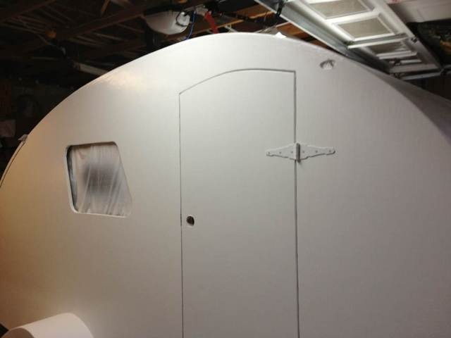

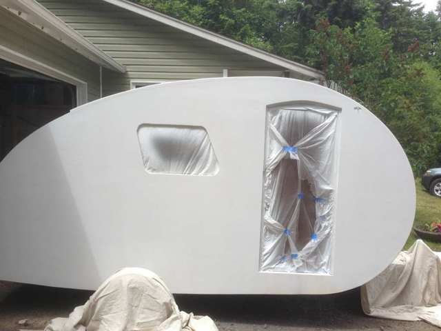

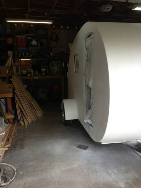

Postby Fyddler » Mon Jun 24, 2013 12:43 am
Today I installed my fenders, caulked my hatch hinge and hatch trim, and painted two coats of white paint with an HVLP sprayer. Luckily I invited a paint expert over that coached me thru it. Very happy with how well the product lays and covers. Cloverdale Eco Logic, it's a water based (low VOC) two part acrylic. Bottom half will be a light green, but i have to wait a couple days for it to dry enough so I can tape my line.
