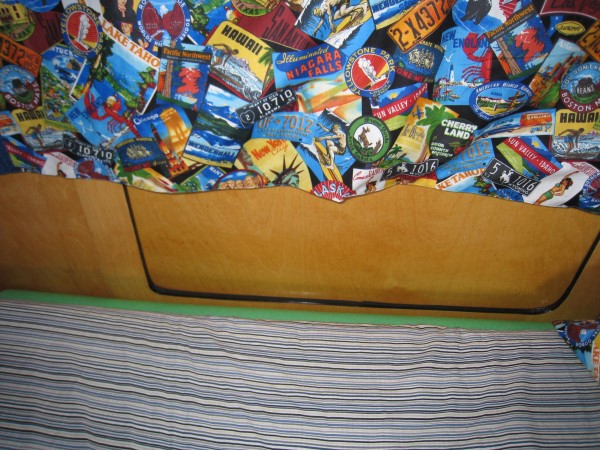

My battery and mattress is installed. My original goal was for a queen size mattress. My teardrop measures just about 1/8" under 60" wide from outside wall to outside wall. I made it this size so I could use 5'x5' Baltic birch plywood for the roof and it usually measure a little over 60". A queen size mattress is 60" wide x 80" long. When I measured the inside area for the mattress it was 78" x 57". I had reduced the length by two inches to allow for more up front storage and the width was really close to 58" with the walls being about 1" wide but then the door seals set in another 1/2" so I decide I should stick with 57"
From http://www.foambymail.com/ a custom 5' HD36-HQ mattress that was 57" X 78" was going to run $285 plus another $70 for the customer cover.
On several other builds I had read that you should leave some room for getting sheets, blankets etc on. I priced a standard 5' HD36-HQ foam full size mattress and it came in at $133, plus another $45 for the cover.
I decided that the extra 3 " in width wasn't worth $177. When the mattress arrived and I installed the mattress is just seemed small (partly as it hadnt complete expanded). It was easy to move around but had 1 1/2" gap on each side and 3-4" short. It slid around when I went to sit on it to get in and left a pocket to lose things and fall into. I didn't like that and wasn't sure the wife would either. I looked for some foam spacers and then remembered we had several of those swim noodles from previous summers. I found two and they are about 3 1/2" in diameter. I placed one on my side of the mattress and it fills the void perfectly. It pushed the mattress up flush with the door on my wife's side, so she can get in easy. It is not 5" high but it is OK. I also placed one at the foot of the bed and it locks the mattress in place and it doesn't move around to create gap at the top . When lying down and rolling around I didn't notice it as much with the noodle as I did without it. The noodles are easy to pull out when changing sheets etc. I plan to use sleeping bags until my wife gets the quilt she wants to make done. The $3 noodle fills the void so you really don't notice the gaps any more. I get the 58" width and saved $171.
Here is a picture, you can see the green noodle

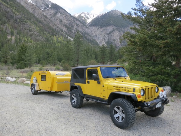

Here are couple pictures along the road
Happy Camping

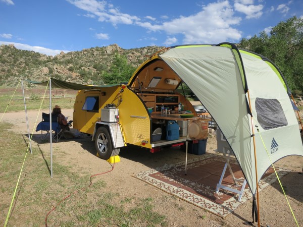

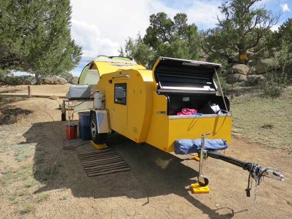

We went camping on its maiden voyage over Memorial day weekend to Buena Vista. I drove up by myself Friday morning in the Jeep pulling the teardrop for its maiden voyage. I went to a favorite lake and fished. Caught my limit of fish, ate lunch, gave a few tours of the teardrop and then went to the KOA and setup camp. It was easy to level, setup in just a few minutes and kept us dry as it rained most every day. The wife our 2 kids and 2 of their friends showed up Friday evening just in time for dinner. The 4 kids stayed in a tent. The wife, the Dog and I slept good in the teardrop. Everyone had a good time.
Here I am at the lake while I was fishing
I fished for a while and then started to eating my lunch. I was sitting in the Jeep and then thought why don't I use the galley counter, so I opened it up and then before you know I was giving several tours of the teardrop in the parking lot.

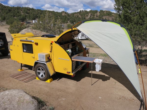

Here are a few pictures of our camp setup at the KOA
Here is the view from the campfire pit
Here is a view of our teardrop from the main office
and here are some fish that I caught
All in all a great first trip with the teardrop trailer

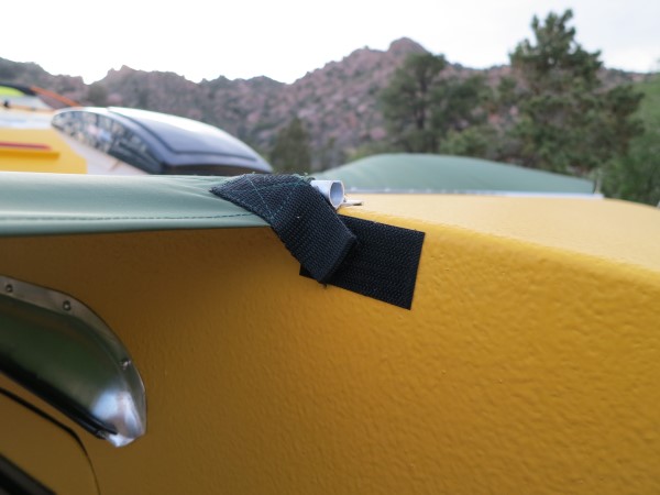

As we camped I made a list of little things to fix, change or pack that I forgot. The main issue was I found out was that the hurricane hinge leaks when the hatch is up and it is raining. My awning setup doesn't cover the hinge. I remembered something about the hurricane hinge working in once direction and when I got home I found the pictures from some previous searching that showed adding a small D weather strip along the hinge so when it swings up it compresses and keeps the water out.

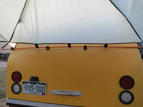

Twice we had pretty good winds and my awning over the doors blew off. They caught in the wind and slid right out of the awning rail. I added a small piece of Velcro on each end to attach the pull tabs to hold in place.
One afternoon it stormed and we went inside to take a nap. It was a little cool, and both my wife and I can to the same conclusion that we needed to store some small blankets in the headboard storage area just in case. My wife also said she wanted a towel for the foot of the bed so she didn't have to take her shoes off for a short nap. I picked up a few towels from Walmart to add the headboard storage.
The galley worked out great and the setup with side tables, trash and stove on the side made a nice L shaped work area. When we left for the day, during storms and at night I removed the table on the back of the galley and closed the hatch. The hatch closed without taking off the awning so it made it easy to close up at night.

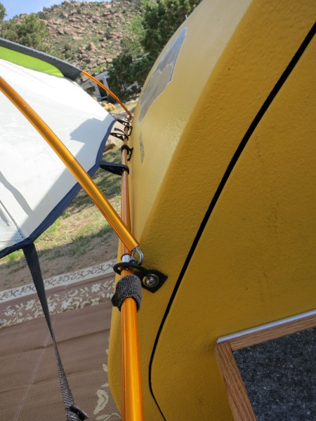

Your galley awning interests me. I went back in your thread and see that it is a discontinued Kelty. Can you show a little more detail on how you are attaching it and with it in the closed position; perhaps the next time you have it out and about?
Re: Colorado Teardrop Build Journal (Build Complete) (kayakd

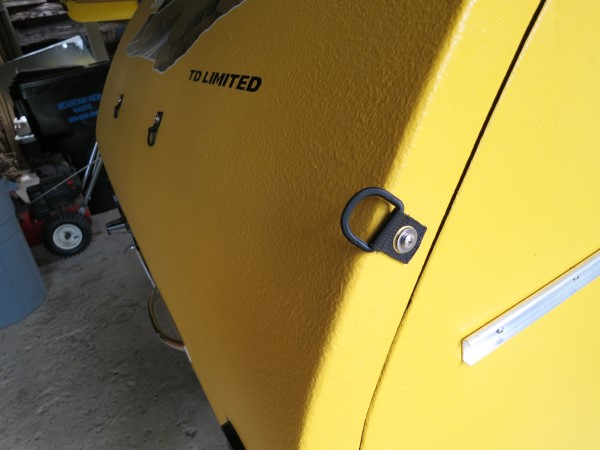

Postby kayakdlk » Fri Jun 13, 2014 10:02 pm
KC,

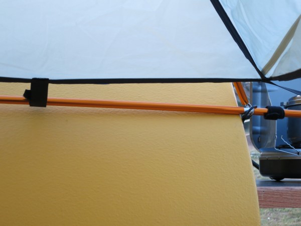

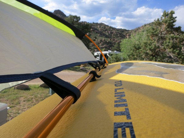

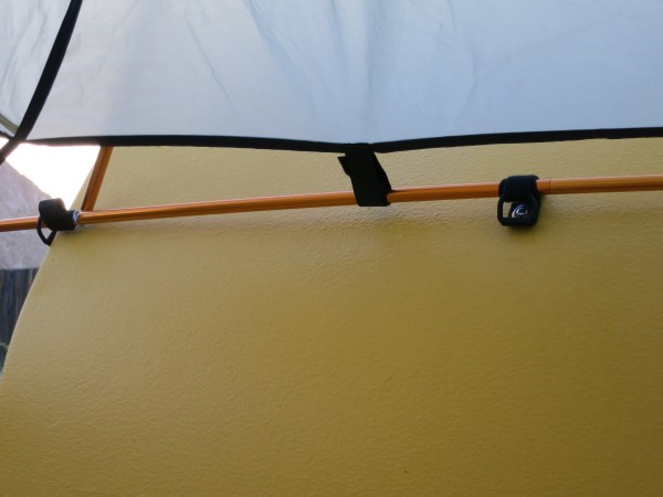

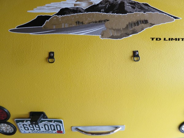

I took 4 pieces of 1" webbing and sewed a D ring on it and then put a grommet through it. I then attached these to the hatch into a spar using a 1" stainless steel screw and washer. Two were put on each end and two space evenly in the middle
I modified the Kelty SUV Awning by cutting off the Velcro they provided (Could never seem to make it work) and adding some Velcro to attach to these D rings. I used the Home Depot 1" Vecro straps and cut them down to fit. I put the rod through the end D rings and Velcro to the other two.
Hope the picture help
Middle two D rings
The end D rings
Here you can see one end of the pole through the end D ring and the other velcroed to the middle D rings.
Here is the other end
Here is a picture with the hatch down
Other pictures
Hope that explains it

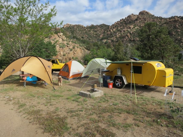

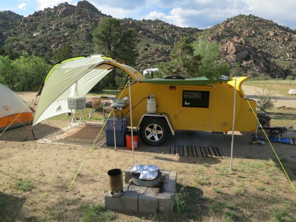

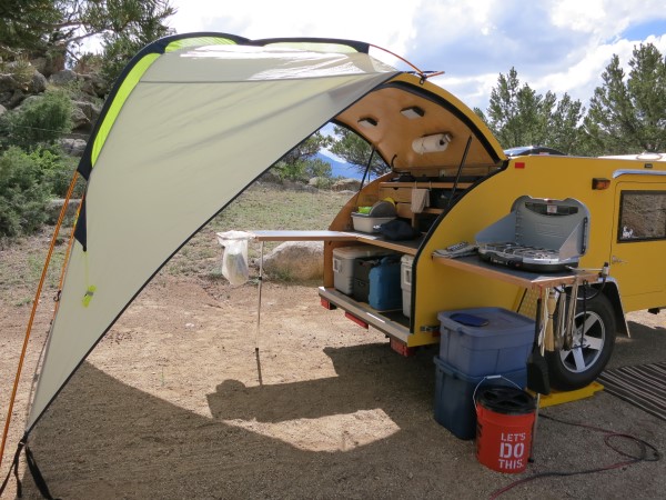

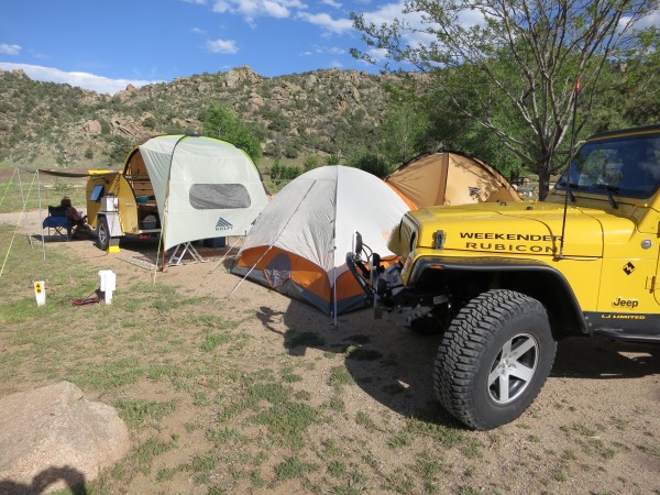

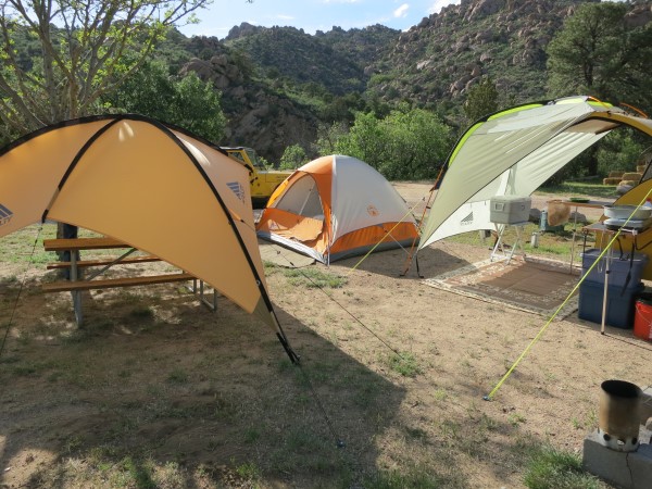

We went camping again to Cotopaxi for 5 days. This time it was just the four of us, no extra kids. We took the Jeep and teardrop to Cotopaxi KOA. This was a maximum load test to see if we all fit and if the Jeep could pull it all. With the Jeep loaded with 4 people, dog, gear for 4, and the teardrop it was a full load (extra 800+ lbs from last trip). The Jeep was able to pull it all but didn't have much reserve for a few of the steeper hills. When we all go I will probably use my truck and keep the Jeep for when I go by myself or just the two of us.
Here are some pictures of our setup with all awnings, tent for the kids etc for a muti day trip in the same place.
The door awning worked to keep us dry while getting in and out of the teardrop, the orange tent is for the kids, and the other awning over picnic table provides sun or rain shelter for meals, card etc. We can set them all up, or none of them. It all depends on how long we are staying in one place
The Kelty awning over the hatch works great, keeps the sun and rain off while cooking and doing dishes, but is still open enough for a breeeze
On my last trip my door awning kept blowing off. I had added Velcro to my door awing end tabs and they stayed on even in high winds.
I only had a list of one or two items are this trip, so it looks like the kinks are worked out and she is ready for whatever type trip (by myself, short overnight, longer trip with the four of us) we decide to go on
