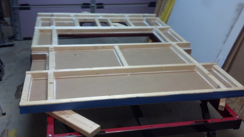

Postby Kharn » Fri Apr 04, 2014 3:39 pm

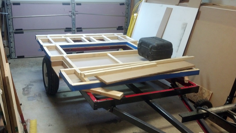

I screwed & glued the floor, flipped the floor upside down and started working on the under floor storage when the rain started. Unfortunately I'm still at the stage where I need the table saw, so I'm done for the night.
The weather should be better tomorrow, with any luck I'll get the storage done and be able to start painting.

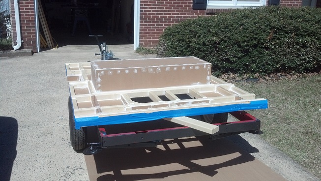

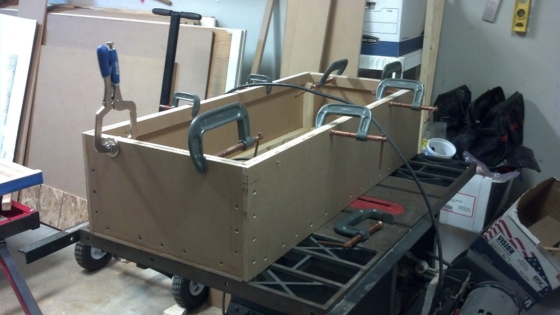

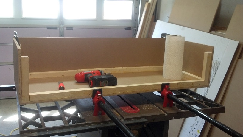

So I have the under floor storage box done.
20140405 box progress small.jpg (106.1 KiB) Viewed 2589 times
20140405 finished box small.jpg (122.97 KiB) Viewed 2589 times
Now I have to decide if I want to install the box on the floor when it is upside down, or finish the floor, flip it upright and attach the box from below.
The first would let me seal everything very well, but would be a big pain for flipping it upright due to the increased weight and the problems that would occur if I'm wrong on the tongue extension not interfering. The second course of action would mean less access to get a caulk gun in and seal everything properly. :thinking:

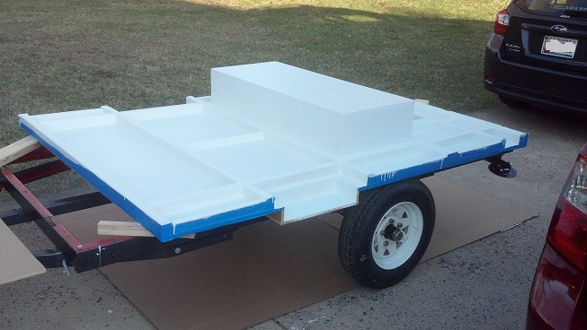

Postby Kharn » Sun Apr 06, 2014 9:18 pm

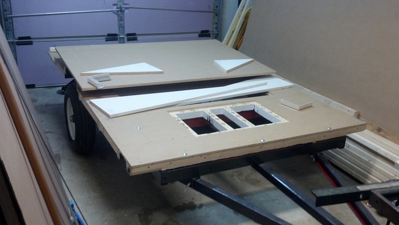

I decided to jump in with both feet by attaching the storage box. Working under the trailer, with the axle in the way and the drill throwing sawdust directly into my eyes (somehow avoiding my safety glasses) was not much fun.
20140406 prepped floor small.jpg (120.15 KiB) Viewed 2554 times
I put two coats of Valspar exterior latex primer (most readily available 100% acrylic latex primer I could find, since the MDO requires 100% acrylic for weatherproofing) on the underside of the floor and the battery door.
20140406 Primed floor small.jpg (94.24 KiB) Viewed 2554 times
Now we have to see if I can get two coats of paint and the asphalt on the floor by Friday or not.

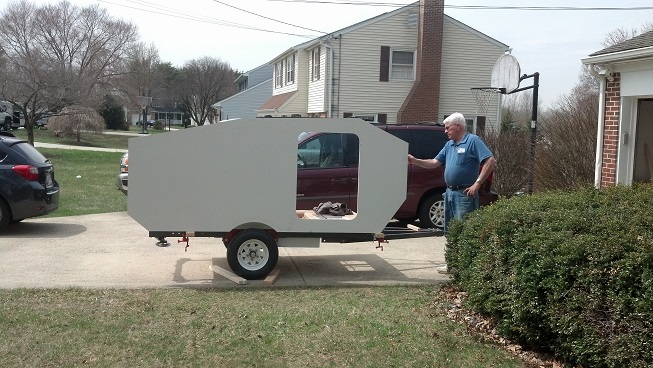

My dad came to town to help out, he spent yesterday truing my table saw and generally playing around with my tools to see what all I've managed to acquire or abuse, and today we started bright and early.
We thought we were racing against an afternoon rain storm, but it never materialized, so we made a ton of progress.

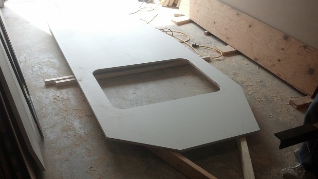

First we cut the profiles.
20140411 Cutting profile small.jpg (82.15 KiB) Viewed 2440 times
Then we cut the doors.
20140411 door cut small.jpg (71.18 KiB) Viewed 2440 times
Then with some apprehension, we dropped the doors into place.
20140411 door fit small.jpg (72.06 KiB) Viewed 2440 times
They went in perfectly, with no adjustment required. :D

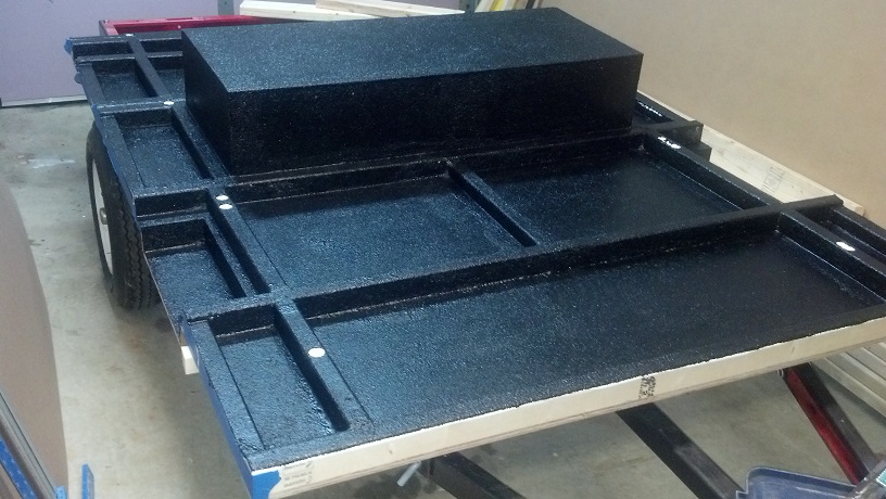

I went with the Herculiner.
The first coat is drying, I'm glad the weather was good enough to do it outside because even with my respirator, I bet I would've been on cloud 9 if I had to use it in the garage. I'm also going to put tape over the corners that were damaged previously so when we lower it into place, there won't be as much chance of scraping the Herculiner/paint off.

Second coat of Herculiner applied.
Now I just have to wait until Wednesday to flip the floor over and bolt it down.
I accidentally crushed the Herculiner can a bit when I was closing it, no punctures or anything, just enough to distort the rim a hair, so I ran a ring of duct tape around the top to hopefully seal it a few days until I get the galley floor cut to size and prepared. I can buy additional quarts of Herculiner, so that's what I'll have to resort to if the tape doesn't work.

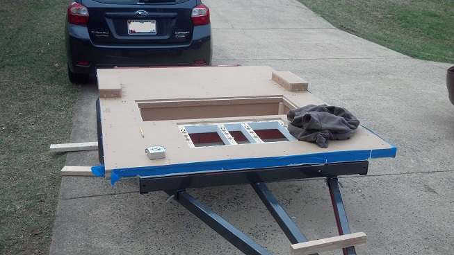

Postby Kharn » Wed Apr 16, 2014 7:53 pm
So here's the Herculiner after it dried:
20140415 Herculiner small.jpg (147.72 KiB) Viewed 2268 times
My dad arrived today, it's going to be pretty cold for the next three days but we should still be able to make a bunch of progress.
First thing was flipping the floor upright, bolting it down and planning how we're going to attach the walls.
20140416 bolted floor small.jpg (111.3 KiB) Viewed 2268 times

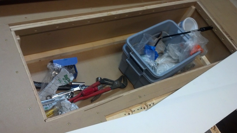

And here's a shot of the inside of the storage box.
It is gigantic. Ranger Rick's never going to find my red solo cup refill station now. :beer:
20140416 storage bin small.jpg (95.36 KiB) Viewed 2268 times
